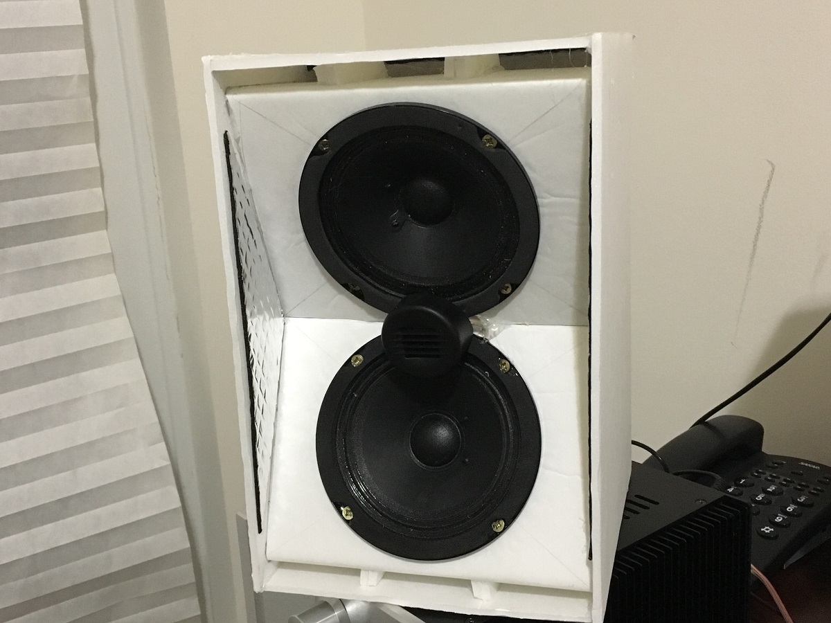

Thanks for pointing this out - that sure looks just like an XKi with a double aperture.
But the one with the aperture turned around would be better and I have in fact, built this. I put two PA-130's on an angled V and had a flat diamond K aperture on the face.

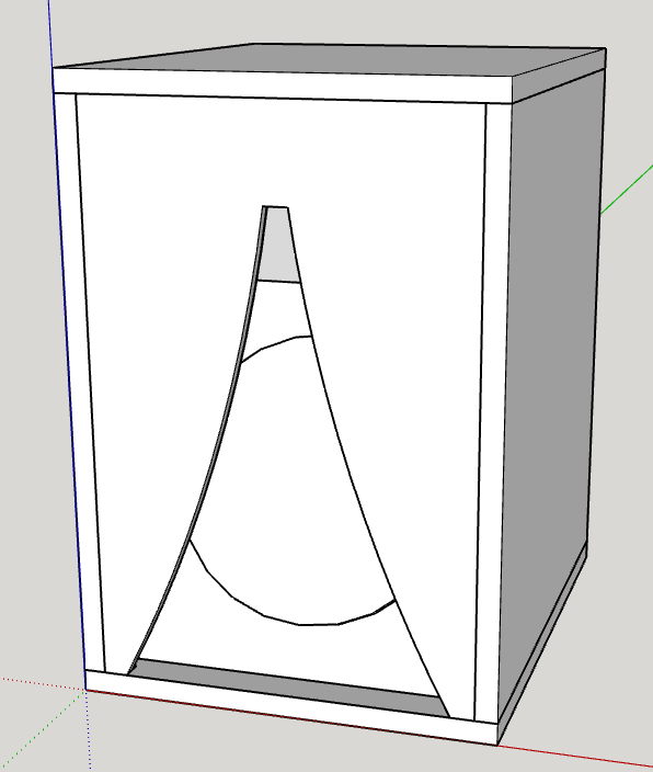

Ok, so let’s shoot for circa -6dB at ~30Hz and -3dB at ~40Hz ok? Having no real limitation on bulk is a nice advantage when it comes to modeling a solution. There will be some the usual Karlson “W” dips in the 200Hz to 500Hz range, but generally not audible. Some drivers are perfect for this alignment, others not so much - we will have to see how it works in the sim.
For K15c XKi:
So what I have so far is a 250 liter box, about 19.5in wide x 22.5in deep x 34.5in high (all internal dimension). Assuming you will use 3/4in ply that will give 21in wide x 24in deep x 36in tall cabinet. The vent is 19.5in wide x 2.5in tall x 16in long. The front chamber is 1/3rd the total volume.
This will give 95.3dB sensitivity at 2.83v and 1m. -3dB at 34Hz and -6dB at 30Hz.
I can't predict how high it will go, but that is mostly limited by bandwidth of the driver - which seems to have a nasty peak at 1.8kHz. So some attenuation there by the aperture might be a good thing.

Let me draft this up in SketchUp and start planning the build
