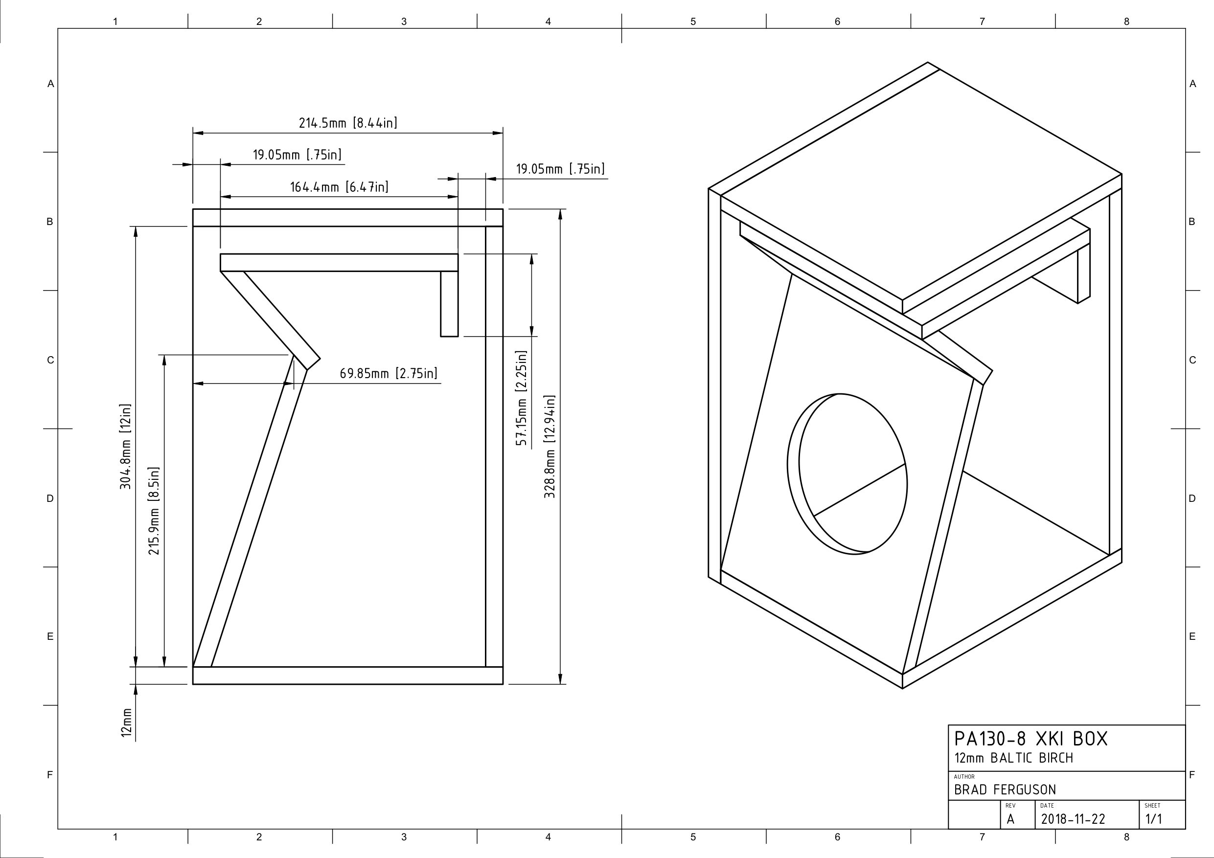

I'd also like to build an XKi with the PA130-8 driver, but I'm planning to use 12mm baltic birch. I started with the drawing you did many many pages back, and adjusted the dimensions to account for the thickness of the the wood. Does this look like it'll work (larger image attached)?
Yes, that’s fine as long as internal volume and vent cross sectional area and length are the same.
Thanks - I fixed a mistake with the vent length and increased the rear chamber volume a little more to get it as close as possible to the original.

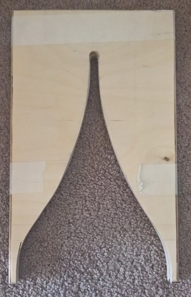

I have read this thread and seen where you recommend wool felt be installed, but just to be sure I wanted to post a picture and get your feedback - in the picture below there are areas incased in red. Those are the areas I need to install wool felt aren't they?
Also, I have done a slightly different shaped k-aperture than the usual - I read earlier that the wider the hole at the bottom the more high frequencies get through at the expense of dispersion, and the wider the slot at the top the more bass quantity you get at the expense of bass extension, so I changed the curve slightly.
Additionally, in case I want to add a tweeter later ala Xkiclops, I have left enough vertical space between the top of the aperture and the top of the front baffle, so a tweeter can fit. I hope the aperture is still high enough.
Finally, I am planning on rounding over the inside of the aperture curves, like I have done on the outer edges of the front baffle, in my mind, that will aid with dispersion.
Does this all look like a terrible idea to you?
Finally, I have ordered some 10mm accoustic foam to line the cabinets with. You mentioned earlier that it's good to also line the back side of the front baffle with felt. I also have 1mm felt lying around - should I use the 10mm felt or the 1mm felt for the back side of the k-aperture front baffle?

Yes, the areas you outlined are are correct. Don’t block the vent opening. You can get use the melamine foam pads - I have had good luck with them. They are same as professional sound abatement foam. Very fine pore size and totally breathable so they dampen sound but take up very little volume.
It’s fine what you did with aperture. Yes, line the inside of the aperture and also the sidewalls if the front chamber. I had good luck just flying a later of paper faced foam core to the inside of the front aperture.

Just to confirm, would you use the 1mm felt on the back side of the aperture + side walls, or the full 10mm foam?
If the paper side of the foam core was enough then perhaps the 1mm felt will also be enough?
I would use the melamine sponges (scrubber pads) over all other materials. It is that good.
