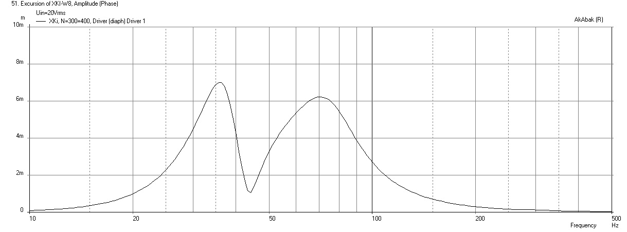

Hello XRK. I love the work you do. It Might be a stupid request, but I have one subwoofer laying around. And I thought it would be cool to build it in something good. Sadly the woofer is made for car audio, but I think it has nice specs. Maybe you can tell me, if It is a good mach please?

This looks like it can work as a subwoofer, which is what the driver was designed for. The large Le causes a bump in response near 70Hz, which actually will give this woofer a psychoacoustic impression that it makes more bass than it does due to 2nd harmonic of 41Hz bass note being at 82Hz.
So make the XKi box 44 liters total volume with a 12in wide box x 18in tall x 12in deep box that has a 12in wide x 0.75in high x 9in long vent. Make the setback of the vertex of front chamber 4.75in from the front with a baffle board that is at least 12in tall to accommodate a 10 in driver and magnet when angled back.

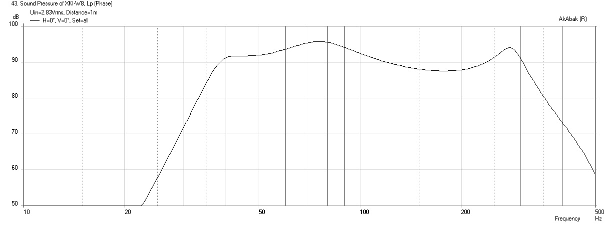

Here is predicted SPL at 2.83vrms with 36Hz -12dB/oct high pass filter:

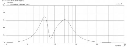

Here is predicted cone displacement at 20vrms just about hitting xmax for both peaks:

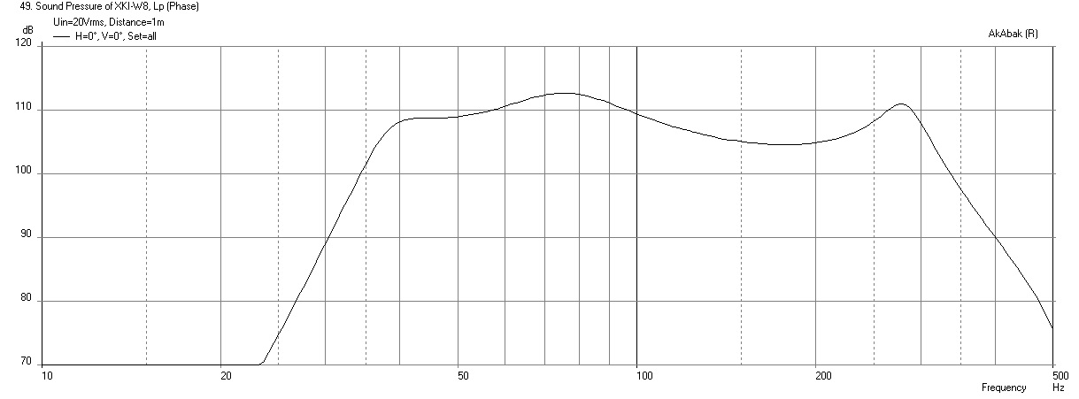

Here is predicted SPL at xmax requiring 20vrms input. Can achieve about 109dB with F3 of 38Hz:
If you will use it as a subwoofer from 40Hz to 100Hz, I think this is fine. Just be aware of the hump at 70-80Hz. Hope this helps you.
Thanks a lot, it looks promising. I really love when the kick drums are highlighter, I always crank the bass button, when listening to rock songs, so the bump might be very good.

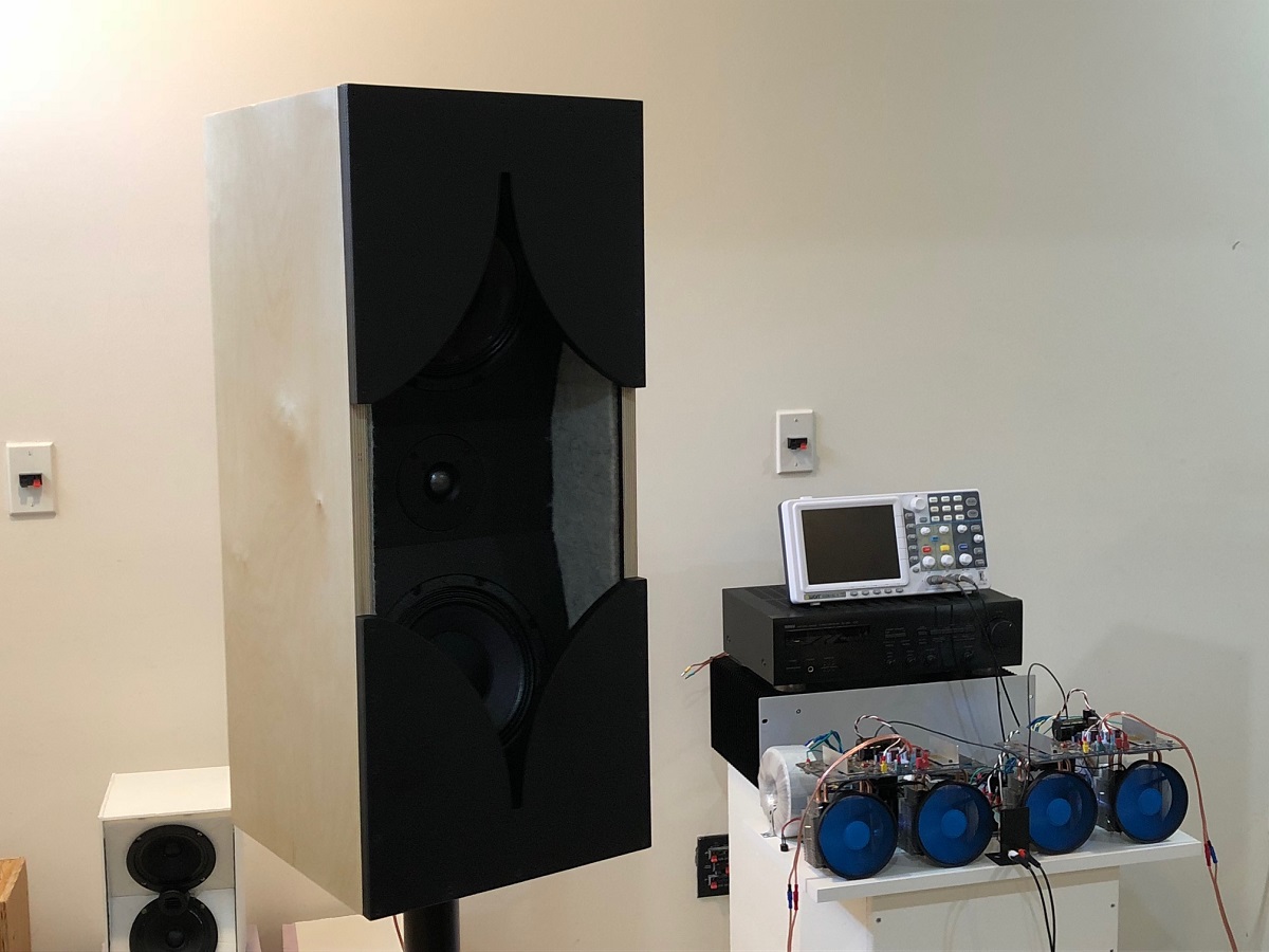

New XKi MTM design with Beta 8cx and aluminum dome tweeter. 94dB at 2.83v sensitivity, BIG sound and big size. Thanks to member, Korny for the inspiration as it was a custom design for him.
First sound test here powered by the ALPHA 52w Class A Big Boy (BB) amp.

Closeup with better contrast.

How does it sound.
Hi Korny,
I am still in process of adjustments to damping and foam padding - it needs it so will report back later. It is very sensitive though. Doesn’t need more than maybe 1.5vrms and it’s too much sound.

Questions on your lovely new MTM XRK
X, OK I'll bite 🙂 is the Al dome crossed high as a super-tweet as the 8CX is a co-axial ?(can't quite work out what's going on here) Could this arrangement work as a 'regular' MTM with the recessed tweeter placement giving a degree of time alignment w.r.t regular mid-basses? I'm thinking something like Faital pro 6Fe200, though tweeters of matching sensitivity would be an issue if mid-basses in parallel...
