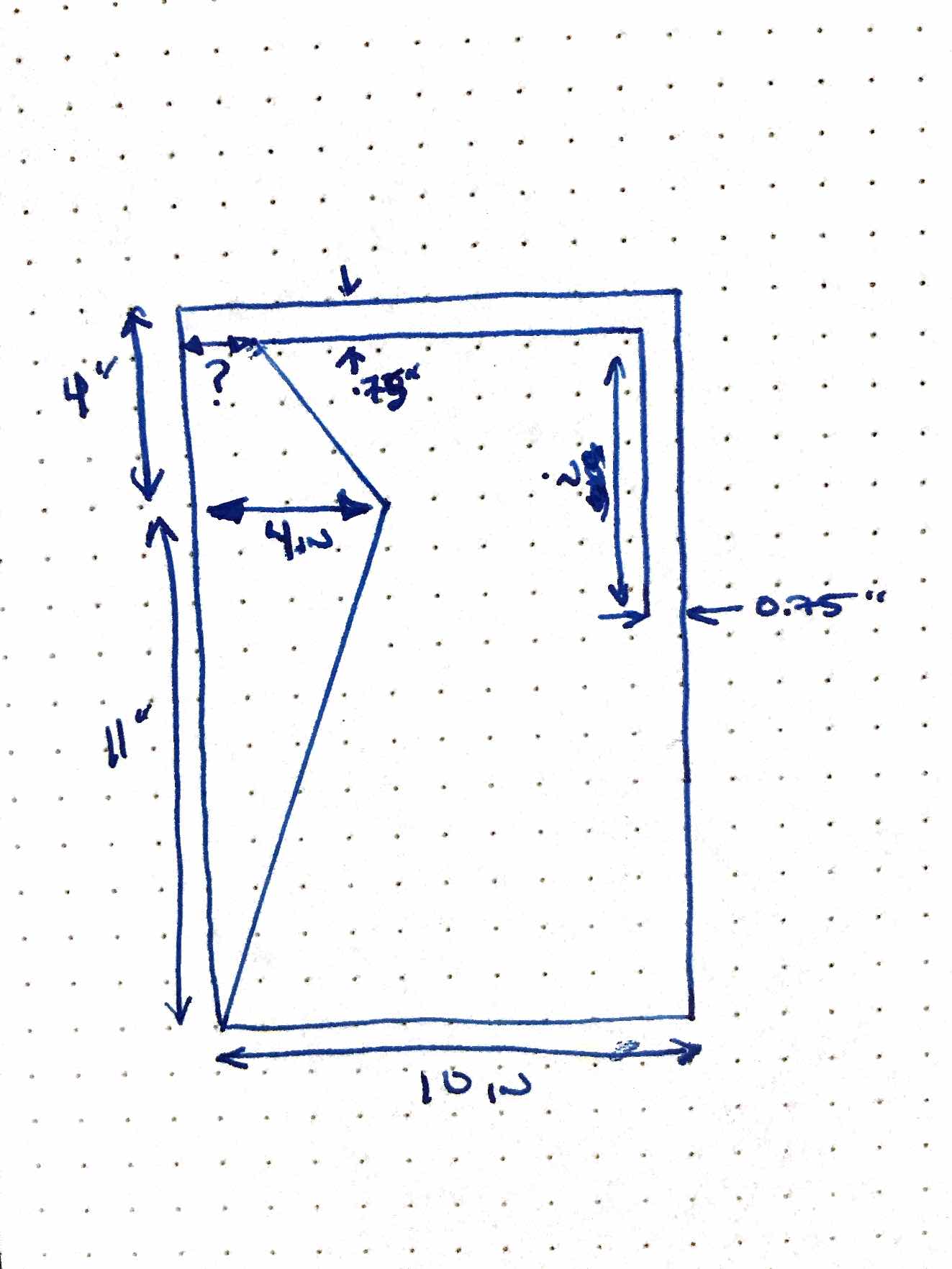

OK, so I took a stab...I'd like to try this build and I'd be happy to share if I can get some feedback on some of the measurements because I'm not sure I've figured this out correctly.
I'm assuming the volume ratio does not take into account the vent space or the space the speaker takes up...since you all decided the height of the triangle was 4 and the base was 15.
The things that most puzzle me:
- The angle of the speaker in the cabinet. Is it just "shallow enough to fit" ORRR the long side where the speaker is mounted should be the length of the hole necessary for the speaker plus 2 inches, in which case the triangle would be 9x8x4 with another triangle that is 7x4x8...?
- The set back of the edge of the vent from the front face... 1.5?
- The length the vent wraps down around
I couldn't discern a ratio based on your other drawings as to where to place that 4 inch line. So here's what I have, am I way off?
Also, it seems like the front curtain always starts two inches from the top, but I'm not clear on how the curve scales outward. Help me, I studied business and my math is terrible!

The angled panel where the driver mounts is simply made based on two things:
1. It needs to be big enough to fit the driver bezel and tall enough that when it angles back the magnet or basket doesn't touch the bottom.
2. The angle is set such that the vertex is a certain depth back to provide the required front chamber volume. The volume is the triangular area in cross section x width. The area of the triangle is 1/2 the area of a rectangle of the same setback. So to get 20% front volume in a 10in deep cabinet, the depth has to be double the percentage or 40% deep for example. 40% of 10in is 4in.
So the interaction of a panel big enough for the bezel and the 4in depth defines the front chamber geometry.
The vent is simple linear length of vent, leave room at front for it to breathe.
Aperture always has some material st top as matter of strength to allow making it one piece bit also to make sure vent airflow is directed across the driver face before exiting to enforce 6th order bandpass behavior and provide added cone movement control.

OK, so really the only thing that matters is the volume ratio, and the aperture in the front should generally follow the shape in the design... but there's not any real specific measurement?
You can follow a scaled drawing of the Karlsonator aperture. Look in 0.53x scale mini Karlsonator thread for drawings.

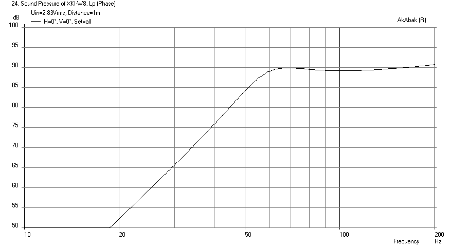

Hi Bonjonno,
I just ran a simulation and this driver can make a nice XKi. Try making a 7in wide box x 12in tall x 9in deep. Pleasing proportions, no? That's about 12.4liter internal, once you subtract the vent and driver volumes you will be at about 12 liters design goal. Make the angled driver mounting board angled back so the setback from front to the vertex is 3.6in. Make the vent 0.50in deep by 7.0in wide (width of box) and extend it back 7.5in. You mayneed to wrap the vent around the corner in order to give clearance to the front of about 1in spacing between vent opening and front K aperture. This will give you an F3 freq if 55Hz and 90dB sensitvity. It will sound quite good on kick drums. You can mount one of these low profile 1in silk dome tweeters from Dayton in a small hole cutout on the aperture (offset) to one side of the wings (or right in middle above the aperture vertex if you prefer).
Dayton Audio ND25FN-4 1" Silk Dome Neodymium Tweeter Element 4 Ohm
The woofer has a natural roll-off at 2kHz so let's use that as the crossover for the tweeter. Just put a 24uF (two 47uF electrolytics - back to back in bipolar confg should be close enough, by pass with 0.47uF filmcap) and add about 3ohm to 5ohm (adjust to taste) series resistor to pad down the tweeter by about -5dB. This will give you a very natural sounding and time accurate 1st order XO. If you want to improve the performance of the XO a bit more, try adding a series 0.5mH air core for the woofer. This will reduce power sent to the woofer voice coils above 2kHz. Something like this should work:
Dayton Audio 0.50mH 18 AWG Perfect Layer Inductor Crossover Coil
Here is response of the woofer before baffle step loss of about -5dB. So it should be an 85dB sensitive overall system:
Note that these are very rough passive crossovers from off-the-top-of-my-head, so it may not be perfect, but should sound quite decent.
If you choose to mount the tweeter in a central hole in the middle at the top of the K aperture board, a good name as you suggest is "XKiClops". 😀
