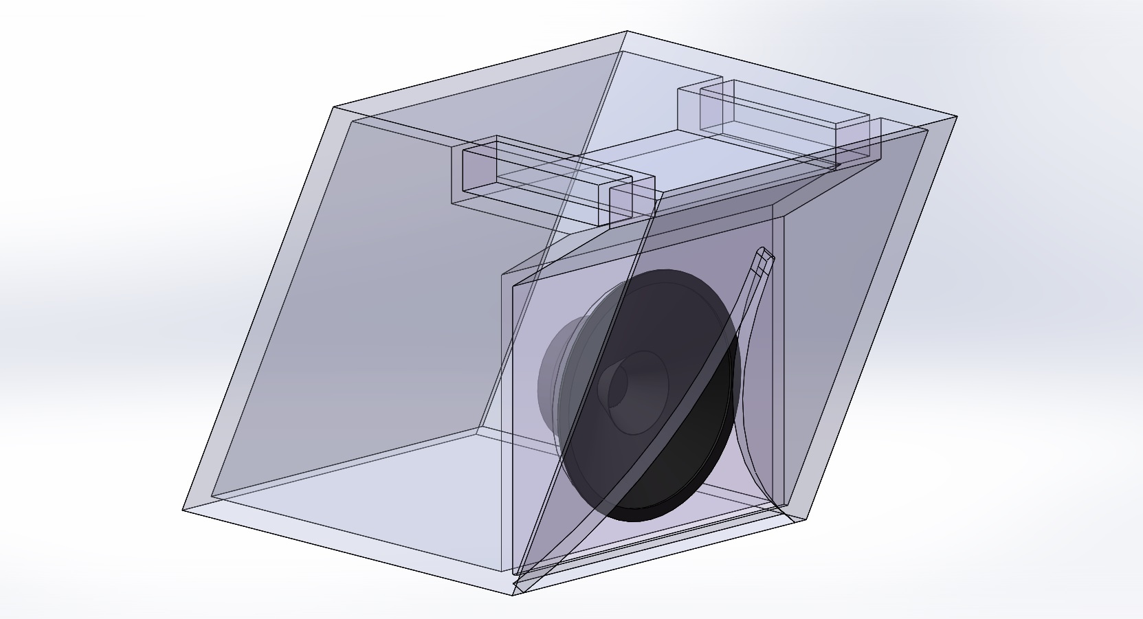

I finally had time to run a sim for you. It looks like you can use this to get a very high sensitivity XKi with 97dB and F3 of 55Hz. It can achieve a max sustained SPL of 117dB at 28vrms using a -12dB/oct HPF at 40Hz.

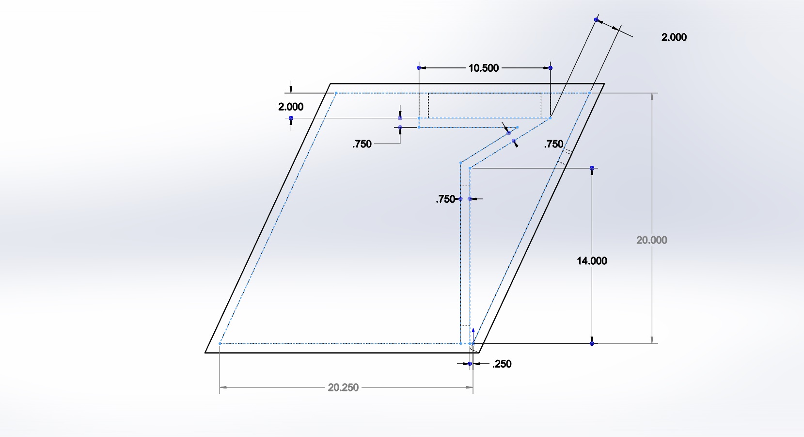

The design is as follows: 80 liter box wth 80% rear chamber volume 20% front chamber volume, vent is 12in wide x 2in deep x 10.5in long.
80L = 4882 in^3
rear vol: .80 x 4882 = 3905.6 in^3
front vol: .20 x 4882 = 976.4 in^3
Assume internal width of 18";
rear csa: 3905.6/18 = 217 in^2
front csa: 976.4/18 = 54 in^2
too big.
Assume internal width of 16";
rear csa: 3905.6/16 = 244 in^2
front csa: 976.4/16 = 61 in^2
too big.
Assume internal width of 14";
rear csa: 3905.6/14 = 279 in^2
front csa: 976.4/14 = 70 in^2
Looks reasonable, see sketch.
Volumes are approximately right, if including ducting volume, and I did not subtract the driver displaced volume. Volumes (areas actually x width) taken in front of and behind the temporary blocking extrusion above the driver at the corner of the duct... not sure if that's exactly how/where you calculated them?
Note that I've tipped it forward so that the sound comes out horizontally - for pedestal mount or stacking on top of other drivers as in my case.

Yep Freddi's got it. Was just a crude sketch to get the volumes close, ran out of time to add the driver and finish the model. Wanted to flesh out how I'd make the driver vertical instead of angled. I'll finish it tomorrow and add some iso views of it in 3d.
Do i also have the duct length wrong? I just saw Freddi erased part of it.
Founder of XSA-Labs
Joined 2012
Duct only needs to be 10.5in long and if the top wall is 19in, you probably don't need to wrap it. I calculate 93L (not subtracting duct or divider wall volume). I think you only need to make it 17.5in deep.
That's interesting to make it a parallelogram, probably helps reduce resonances.
17.5in x 14in x 20in = 4900in3
x (2.54cm/in)^3 = 80.3L

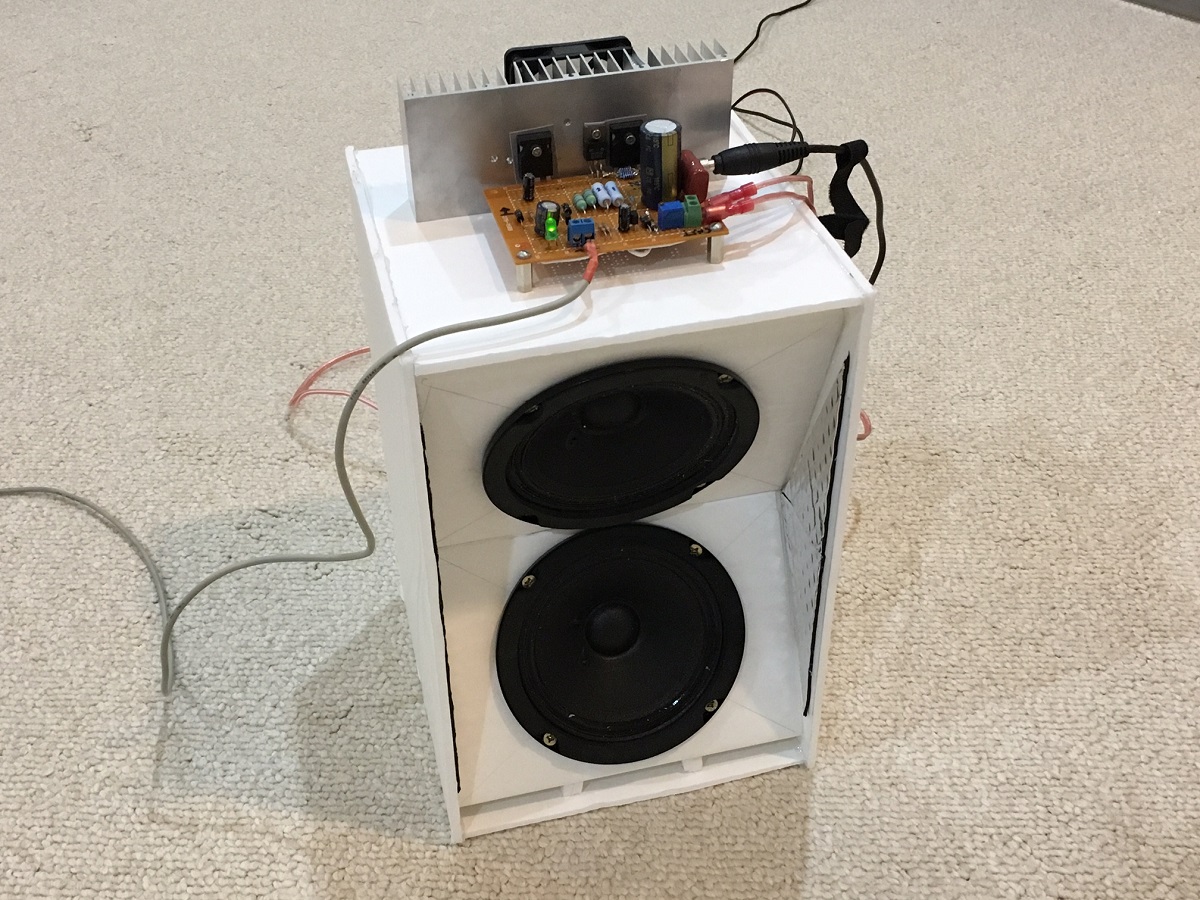

Btw, I just tested a new small XKi I made with dual PA130-8's and dual vents driven by a small Pass ACA 5w SE Class A amp. Sounds great and proves that the ACA can drive 4ohm loads. I don't have the aperture yet, but sounds pretty nice at this stage even though tuned pretty high at 80Hz.
Ok, thanks! Do you not count the duct volume then for either front nor back chamber volumes? If so, my rear chamber volume is a bit small. I'll play with it more tomorrow on lunch at work. My volumes are calculated stragiht from the surface area minus the dividers, so it ought to be pretty close, just need to subtract duct volume and driver volume from the back chamber, so it may get a hair deeper.
Jesse
Resonances, be gone!
Did not find displacement info for Fane, so used 12lta - ought to be close-ish...
.071 ft3
122.69 in3
80L = 4882 in^3
rear vol: .80 x 4882 = 3905.6 in^3+122.69 (driver) = 4028.3 in^3
rear csa: 4028.3/14 = 288 in^2

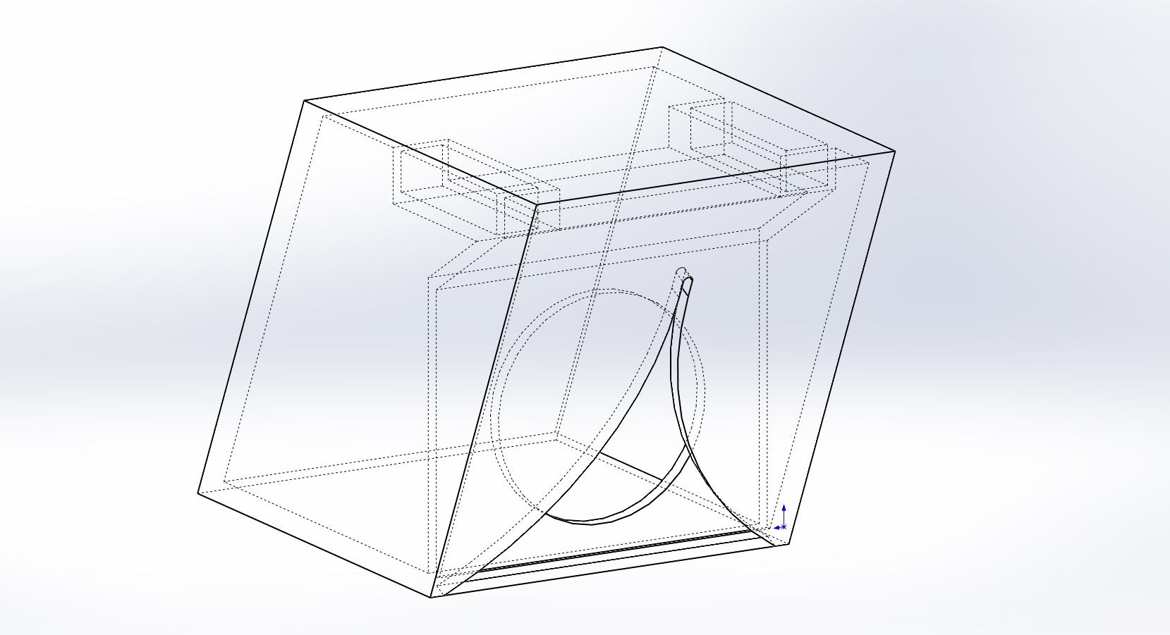

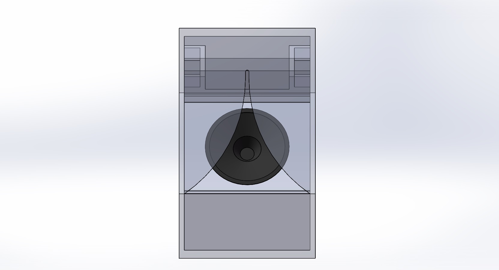

Front curtains are just fudged, I'm not sure what the standard amount of coverage is, or standard radius etc, so I'll just show what I did for comments... so the 2nd picture is showing the curtains face-on, ie. the view is normal to that angled face.

you've got fine drafting skills ! - on a little 8-inch 70Hz tuned K, used a fairly fast aperture suggested by a friend played well. I'd like another stab at this one with less cavity peak/prettier graph. Its got a lot of hit for a tiny cabinet with an 8. A 10" sounds in an old K12 sounds more like a real drum kit.
YouTube
thanks Freddi, but I better be at least okay at it given that it's what I do for a living :)
Just keep in mind that the aperture is faked... not sure how much its actually supposed to cover the speaker cone area. Also not sure about how high up that slot should go, curtain radius, etc.. does Akabak model this sort of thing?
Also, does the angle of the driver relative to the curtain matter much? I drew it at a 65 deg angle from horizontal, so a 25 deg angle from the driver.
Founder of XSA-Labs
Joined 2012
You might want a radius round-over on that knife edge on the port to reduce turbulent chuffing and even whistling sound when that sharp. The speaker looks like a large PE coach's ball whistle. :) Don't forget to add felt around back chamber near driver, and line the inside of the front chamber, aperture and all with felt. It really improves the sound definition and reduces echo sound.
Good idea, may as well round over the edge on the inside of the port as well...
It looks... interesting. :) Not felt line the entire rear chamber? Just adjacent to driver.. or opposite driver on back of chamber?
It does look bigger than the measurements might suggest when I throw it in a corner with some other enclosure models. Something to do with the sharp angles maybe.
Any rules of thumb for the aperture? Area, length of slot, vertical justification of curtain radius centers relative to driver center, angle of aperture boards relative to driver baffle?
