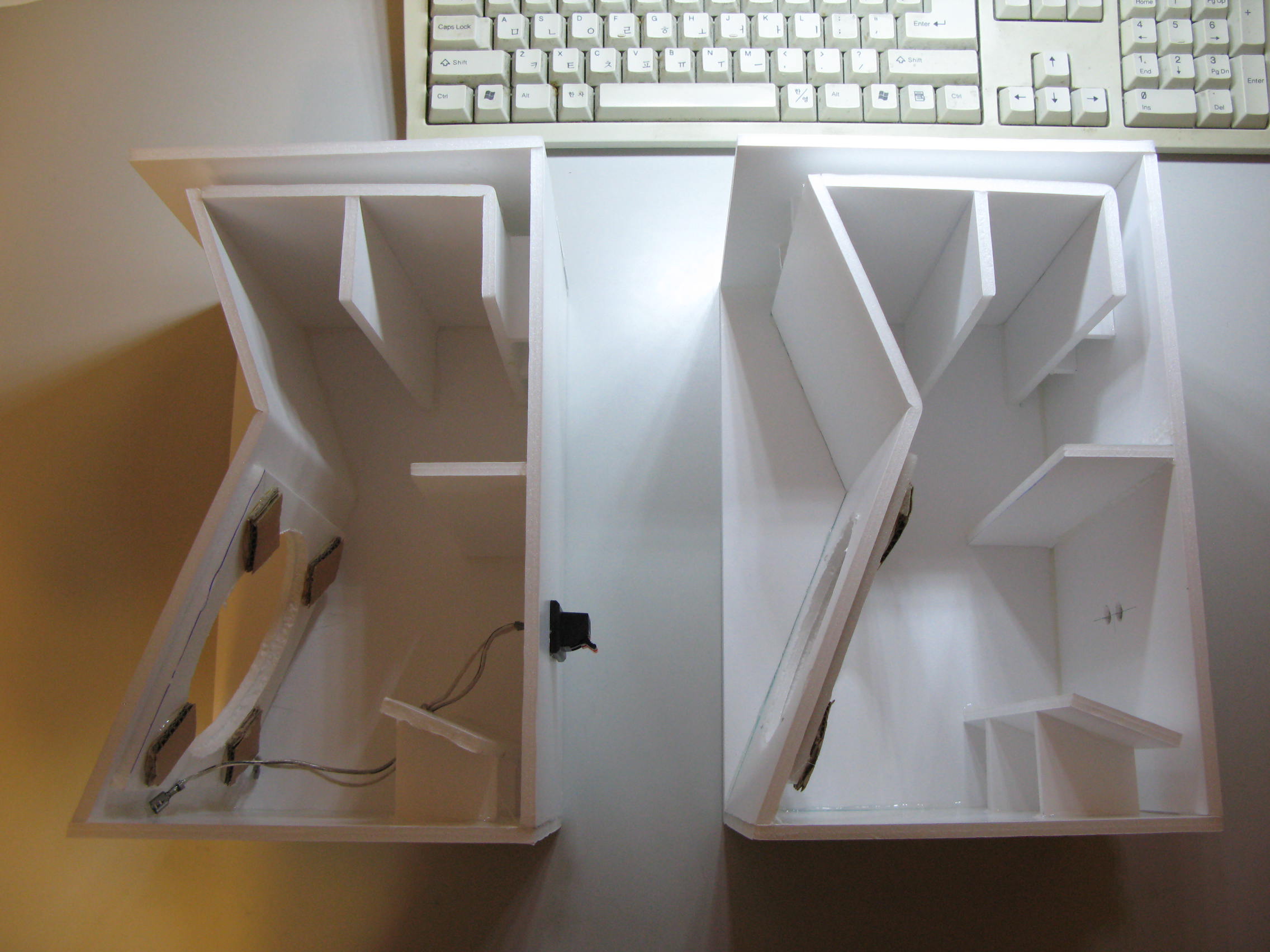

Two years of procrastination and now my ply Alpair 6p are underway and going well so far, however checking back I noticed that Bolexbm had used the same design for similar spec Sammi speakers. The port on mine looks much longer than his. X calculated The port length at 11inches I presume this length is the total of the 0.5 inch channel? Photos of the differing speakers, mine first
Thanks Simon
Thanks Simon
Hi X
As I understand it yes

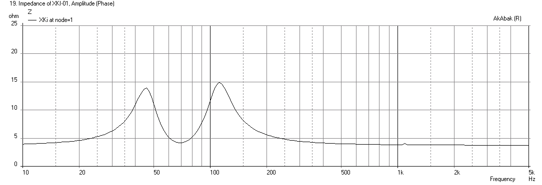

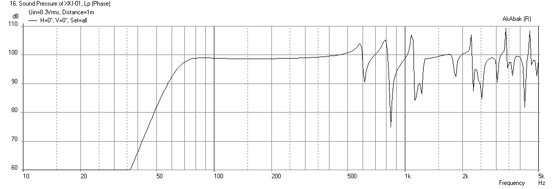

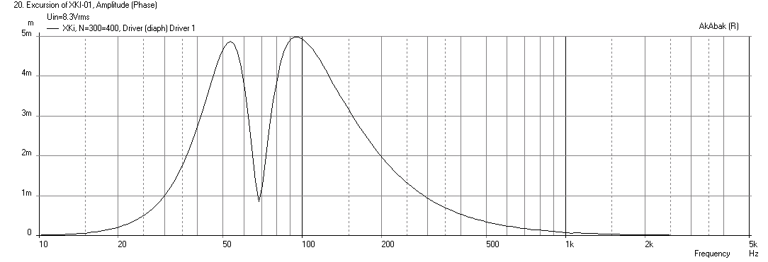

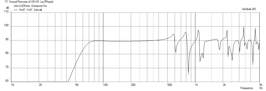

Here is the design for an XKi with the A6p:
6in Wide x 10in tall x 6.3in deep (all internal dims) with a 6in wide x 0.5in tall x 11in long vent. Total active volume (front and back) is 5 liters. Make the triangle front chamber 2.5in deep from front. Use 1/2in plywood.
Here is SPL at 2.83v (fb is about 67Hz):
Here is Impedance:
Here is cone displacement at xmax of 5mm and 8,3v drive:
Here is max SPL - about 100dB at 8.3v:
Thanks for posting the Alpair 6 sims. In that case it is good. The sims are pretty accurate and I can trust if your TS parameters are close that it will perform as described.
