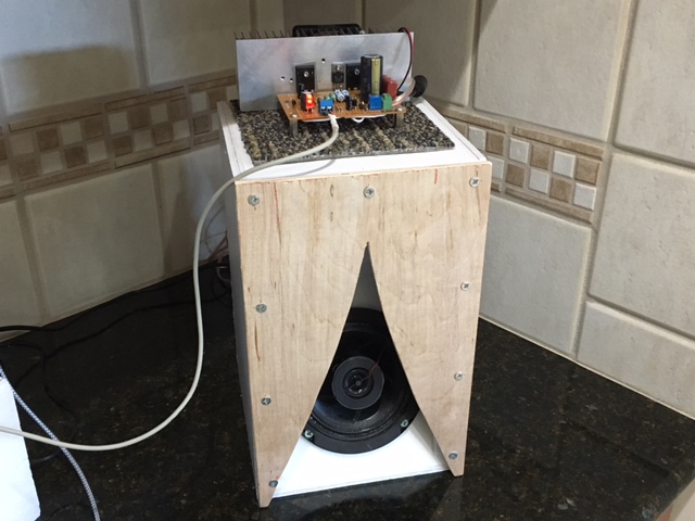

Class A Daytonator XKi Kitchen Radio
Class A and PA130-8 Daytonator makes it to prime time as the main kitchen radio. 🙂
ACA 5w class A amp with fan heatsink. 3.5mm stereo to mono conversion with two 4.7k resistors tied together.

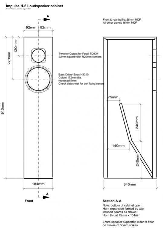

Hi XRK,
I'm sorry, this is a little of topic. But what do you make of this design. Is it a BVR or bandpass design? Brian Taylor the designer referred to it as a horn speaker...

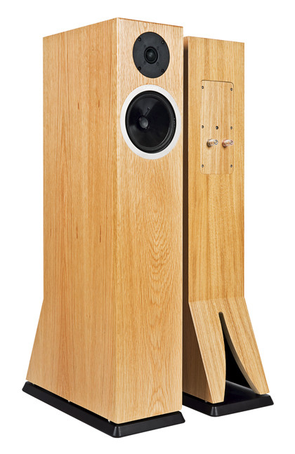

A few years back he returned with a speaker called Aspara Acoustics HL6, which I think is modified version of the Impulse H6.
Take a look at the taper, looks familiar 😉

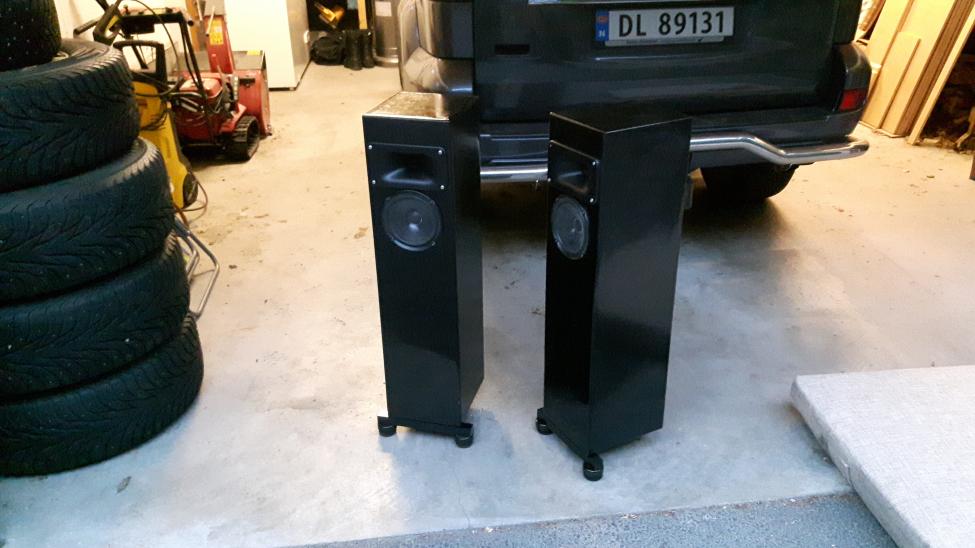

I built a set speakers, inspired by the H6 design, just finished them. I really like the sound of these. No really deep bass, but the bass that is there is tight, tunefull and with surprisingly impact given the size of the woofer.

No I'm sorry, I only speak winisd.😀
For some strange reason there has been quite an interest in the Impulse H6 speaker in Norway. There have been built many clones with various woofers, not all of them very successfull, the cabinet is quite sensitive to the woofers parameters.
The original H6 was built using the Seas CA17RCY woofer. Most of the clones have been built using Vifa C17WH/WG variants. But now they have also become almost impossible to get hold of. I have seen several guys (including myself) buying vintage speakers just to pull out the woofers. Dali 104 has to be THE most sold speaker in Norway, and it utilizes a pair of Vifa C17WG in each speaker, so that one is popular to "butcher" for the H6 fans.
IMO it's a hybrid TL-horn - not a BVR. Easy enough to model in Akabak and I can see a small resemblance to another very popular back firing folded horn that is out there.
The small K aperture is not going to do much as the length there doesn't affect the bass frequencies enough as they are much longer wavelengths. So really for show. You could just have a rectangle and it would work the same.

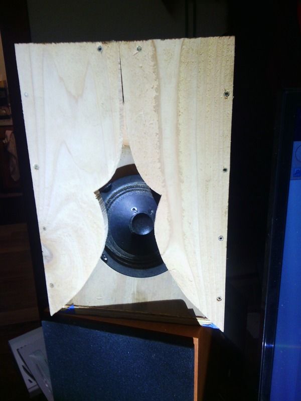

I played with my pa130's a few days ago. I put on cedar wings and put foam tape stuff inside the back cover instead of the cork I had in there for a gasket. The change is huge. The 400hz to 1000hz harshness is gone and they sound nice and mellow now. I checked the back panels for leaks before so, not sure why the change is so huge except for the new wings.
I had 1/4" plywood wings before. I roughed a pair of these out and was happy with the change right away.
that's an interesting aperture - - good you're doing empirical work and evaluation
