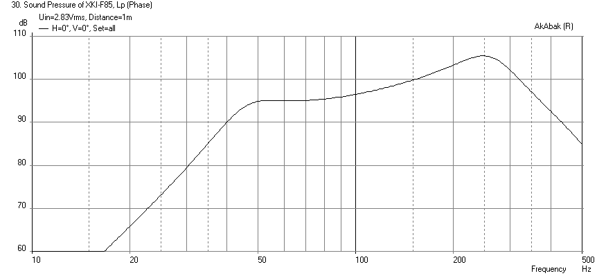

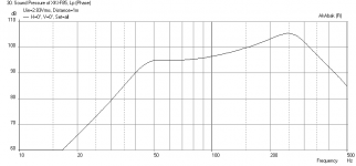

But if you really wanted an XKi for the 10F/8424 to reach 80Hz here you go
4.35 liter box with 33:67 volume ratio split front:rear; 4.5in internal width with 4.5in wide x 0.375in high x 6.5in long vent. Use a -12dB/oct Butterworth high pass filter at 80Hz to prevent over-excursion.
You will get something that reaches 74Hz F3 with 0.9mm excursion. With xmaz of 2.5mm reached at 8volts and 95.7dB max SPL.

I think this can work in a rather large XKi: 75 liter total volume, 33:67 volume split front:rear, 14in wide x 1.25in high x 11in long vent. You can get 95dB sensitivity and F3 of 42Hz.
