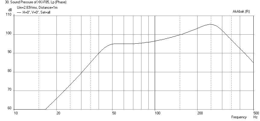

Freddi,
Thanks for putting TS parameters in Akabak ready format - makes things much easier for me.
I think this can work in a rather large XKi: 75 liter total volume, 33:67 volume split front:rear, 14in wide x 1.25in high x 11in long vent. You can get 95dB sensitivity and F3 of 42Hz.
thank you very much X - - not bad for 75liter - would it work correctly (better?) in the Karlsonator12? - 0.75 K15?
tough decision - which XKi to pick? Beta10cx isn't particularly sensitive but can move some air and a reasonable value
(I think the double PA130 XKi may be the sonic and value pick of the litter but I've already P-Audio 10, and other Cx)

how do you properly set the gap from the vent's exit to the back of the wings/aperture plate so its not too tight/loose?
60 liter XKi for W8-1772 and Beta 10cx
how about the gap for this 34 liter XKi for SN10C which has a 1 inch tal x 12 inch wide vent?
and the single pym1298 XKi ? 37 cm wide
50L rear chamber
12.5L front chamber
duct 25.4 cm long by 5 cm high (taking into account 2.6 cm end effect at rear and acoustic mass at front, although will likely still tune a bit lower than the sim)
50L rear chamber
12.5L front chamber
