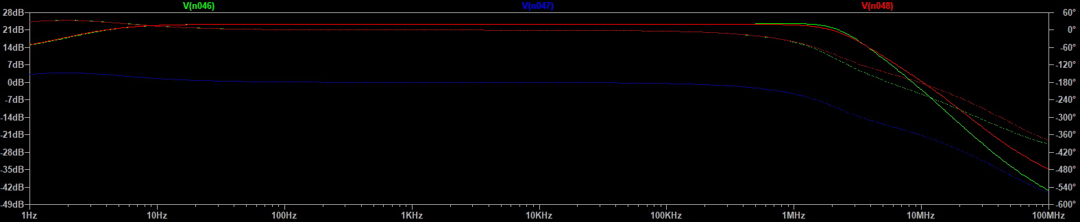

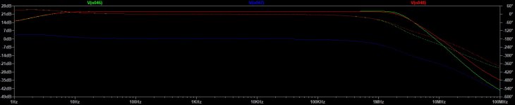

Here you go, the simulation virtually shows no difference. There is a small difference in very high frequency > 1MHz, no doubt due to the different parasitic capacitances. Virtually no impact on distortion performance, the three versions simulate identical:
Green = original circuit
Red (overlapping with blue) = Cascodes with the same MOSFETs as the output transistors
Blue = 3P50 changed with 4P40 (curve hidden under the red curve) (don't worry about the phase, I mistakenly picked the "other" output for the picture)
Judging from circuit performance, I would see no reason why not to do that.
