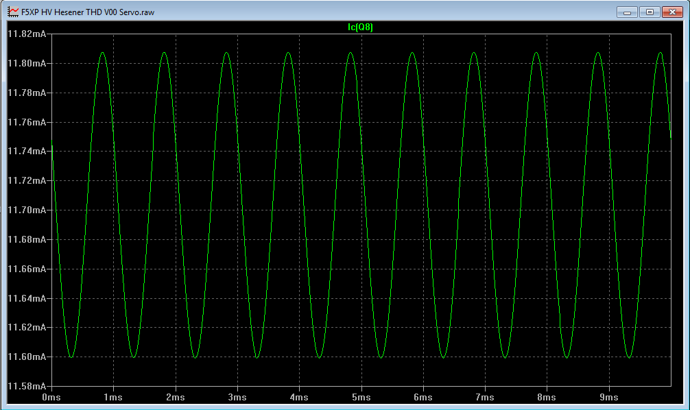

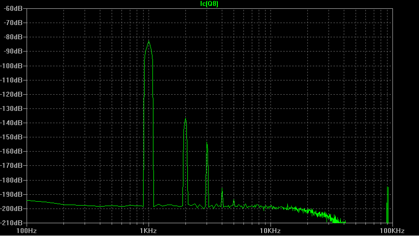

I built your servo into the model as I want to see what it does in the presence of a signal.
You can see in the attachment the FFT of the current through one of the NPN transistors.
A signal dependent AC current is clearly visible (11.7+/-0.1mA), and it has quite some 2nd & 3rd harmonics.
The explanation is quite simple.
Even the LP filter keeps the base voltage constant, the Vce variations will modulate the collector current.
Different to a current limiter, this servo has a constant bias in order to work in both directions.
So it is always in action, and its non-linearity will be seen by the rest of the circuit.
The even harmonics will cancel in the balanced circuit, but not the odd.
And this current has to be supplied by the output of the input stage.
FFT of the output indicates that distortion increases in the presence of this servo by about 6dB.
Not a major concern, but I personally would rather do proper thermal management so that I can get rid of any servo altogether.
Not meant to be a criticism by any means.
Just hoping for some open-minded discussions.
Patrick

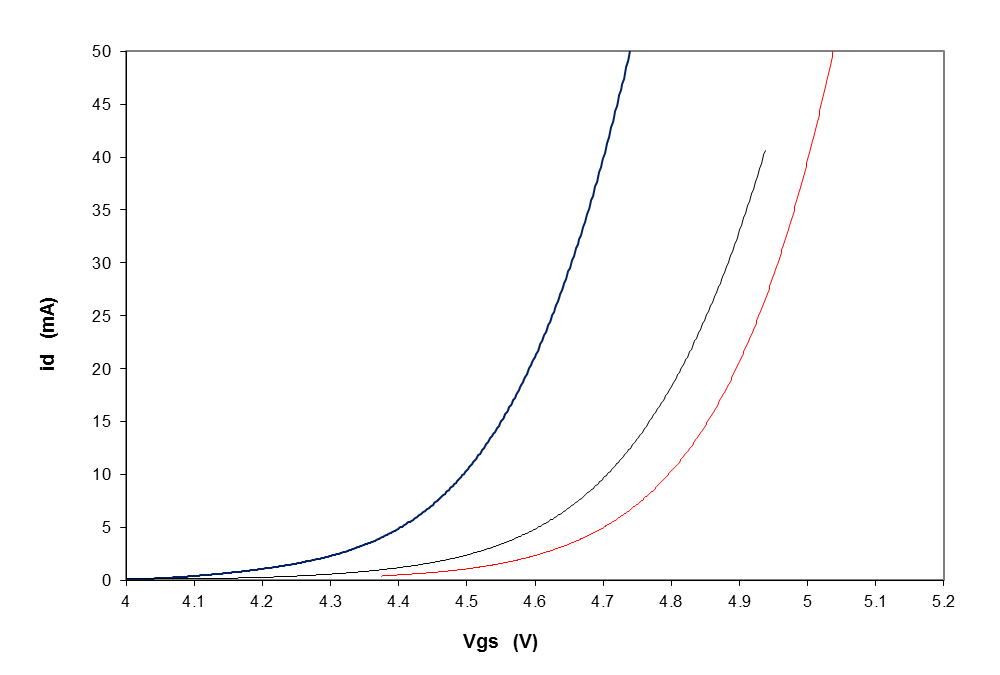

Been a while.
Finally I got some FDP5N50.
And I already have FqP3N80 & FQP3P50 for another reason.
So here is a comparison after curve tracing.
Blue is FQP3P50, black is FQP3N80, red is FDP5N50.
I think actually FQP3N80 is closer with Vgs to the P-Ch. than FDP5N50.
Hardly any difference in transconductances (163mS, 160mS, 169mS respectively).
Patrick

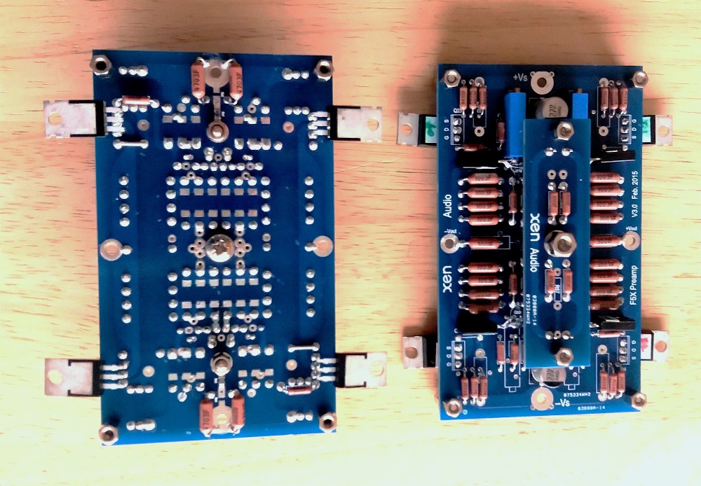

The pair of boards were given to a friend who is in the process of housing them properly.
With regulators, etc. Slow progress.
Are you not going to show us some photos ?
Patrick
Patrick

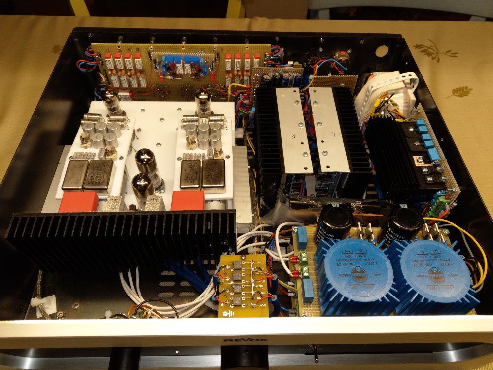

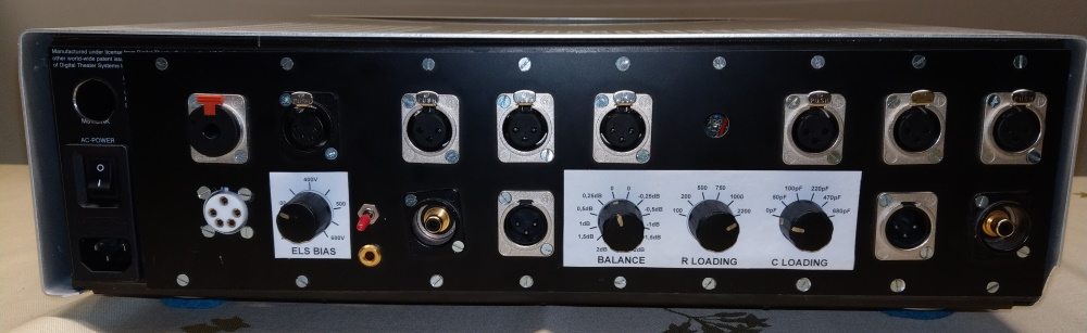

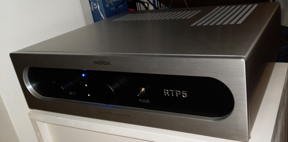

Of course 😀 Sorry for the delay, we had a online wine tasting this evening (hosted by the german magazine ZEIT, and themed around Beethoven) which was very nice.....
Here you can see the preamp front and back, it is fully symmetrical as is the X5HV, along with a nice teflon socket for the STAX headphone and adjustable polarisation voltage. The phono stage is the RTP5 circuit from Allan Wright / Vacuumstate, and the line stage is the same as Acoustic Research AR25. The coupling caps are Jantzen Silver caps and the RIAA caps are Military NOS KS caps from Siemens, that I recovered when my father passed away and we cleaned up the house, years ago.
The inside picture shows the phono and line stage on the left side, built on white teflon boards, and the headphone amplifier is the same as it was 5 years ago, mounted into the chassis vertically so the hot air can drift upwards.
Hope you like it!
Hope you like it!
So I guess my build looks a lot more like done with a hot needle, while your builds are admirably beautiful..... Sigh.... Its rather a prototype, modified in action and upgraded while building, and it works fine, so I am ok with it 😀
