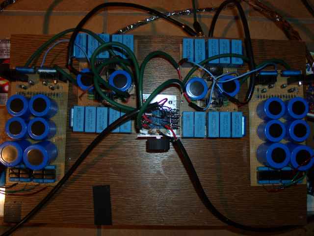

..yes i can bring it to clip, at 4 to 5 o`clock, max is 5 o`clock. the volume difference between 2 o`clock and 4 o`clock is not much.
it`s more a psychlogical thing to have a bit in reserve.
but you all are right - 2 o`clock is enough. i think, when my XSOZ is driven to 30 -40 watts all would be done.

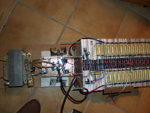

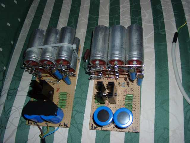

today i lend me a digital camera to take a few pics of my XBOZ and XSOZ as some of early states of my diy CD player, but since i use linux in moment i need to wait until tomorrow to get the pics out of the camera to my XP-Pc in my Office, then i`ll show you....
Today i have made more listening tests and i can definitely say XBsoz with Xsoz is way better than original - wow -i`m really impressed. I never heard such good Musik.

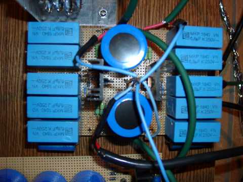

unfortunally the XBsoz are somehow different, cause imaging is not exactly in the middle. I matched all Transistors and both pcb`s are identical - except of two caps in one pcb, they are build-in wrong. It would be curious, if that would be the reason...i`ll see...

I think that what Peter expirienced when he paralleled the two capacitors by connecting outer foil to inner foil was the same (more or less) cancellation of induction, and when he connected innerfoil to innerfoil and outer foil to outerfoil he expierienced the additive interaction of two induction sources. May be, may be not, but I think so?
But I asked my local Audionote dealer if there is some sonical polarization in BlackGate type N, and he said no from personally expierience. More important, he also told me, that if two is used in parallel, You defently have to couple "outer foil to inner foil" and this sounds better than just one.
caps
that could explain the curiosity with my XBsoz.
Next days i will try and polarize two of my mkp`s other way round..
Ralf
