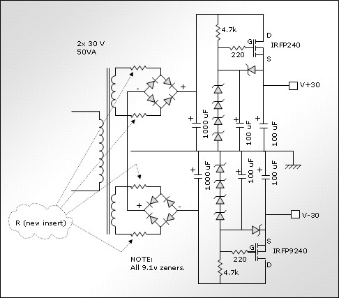

¡¦ A silicon rectifier is a semi-conductor, only letting current go
through it when the output voltage is more than 0,5 Volt below the input.
At that very moment it switches "ON". Inside a semiconductor there is a
capacitance as well. This capacitor, together with the inductance of the
wiring, causes a very sharp peak voltage to occur. This peak is too fast to
be dampened by the connected (electrolytic) capacitors.
The solution is simple: put a resistor between the transformer and the
rectifier. In a transistor power amp the value of that resistor may be 0,1
Ohm - 5 Watt. With tube power amps it could be around 1 Ohm and in preamps
(transistor and tubes) some 10 Ohms.
The result is a more relaxed amplification. It seems as if the sound comes
easier out of your loudspeakers and the stereo image is mostly improved. A
few dimes will do the job.
I am interested in this and about to apply for my BOSOZ PSU as shown below. Have you ever tried this? I could have my own experiment; however, knowing your experience would be a great help. Thanks.
JH

jh6you,
nice to hear something from the XSOZ forum.
today i took the time and soldered .33 ohm resistors in front of the rectifiers and listened what happened.
the result is difficult to hear/say: on the one side it sounded clearer and more direkt, on the other side it sounded colder. I think the differences are not easy to explain.
perhaps the listening test was biased by myself. there`s always the psychlogical aspect in those things. i try to stay unbiased and be very sceptical to all changes and improfements.

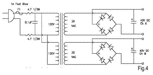

Power supply pre amp
For your pre amp you may want to improve your power supply as in the pass pearl phono stage. Text taken from pearl information page 3. There is a picture there but I could not figuar how to paste it.
"In this example, the AC line is filtered by two 4.7 ohm 1/2 watt resistors and by a 0.1 uF film capacitor rated at AC line voltages. A good example is Digikey part P4603-ND. This filter is not essential."
The resistors are in series with the primary of transformer and the capacitor is in parallel.
You can never have too much filtering in your power supply.

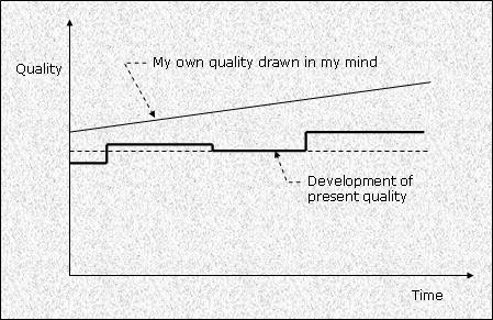

Hi Ralf,
The clearance and directness seem to always coordinate the coldness. And vise versa.
As shown in the attached diagram, a target of a sound quality always exists in my mind. Whenever I do change, improve, simplify or append parts of my amps, I meet end results, and I might get a positive quality development. But, if the development is unfortunately minor and reaches below my target quality line, the development is often disregarded. This is my perception of the developments.
To my BOSOZ, I just applied the Pearl filter. Now I understand the words saying, This filter is not essential.
Regards
JH

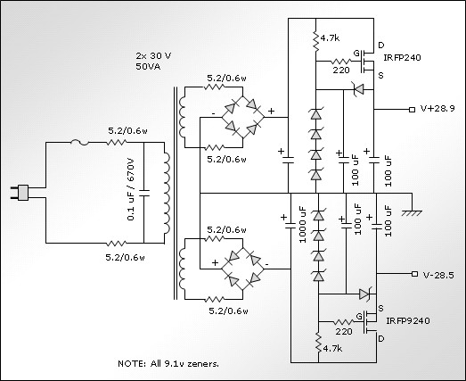

Hi
I have strengthened PSU of BOSOZ with six 5.2R (0.6w) and one 0.1uF (670v).
I feel the sound as if the voices and musical instruments were smoothed by the
touch of very fine sandpaper. I would like to recommend this cheap and effective
filtering.
JH
PS. I measure the output voltages of +28.9 and -28.5v.

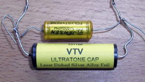

Let me tell you about caps. I was experimenting yesterday with input caps on my Aleph X. I wanted to cross it at around 120Hz for mids and tweeter high pass. The value I needed was around 0.06uF. Since I didn't have one cap of that value I had to parallel two. I settled on VTV Ultratone silver foil paper in oil type and Jensen polystyrene. Both of them have outer foil marked, so I soldered them together in that order. It came to me that it might be worthwile to check them in circuit both ways (outer foil to input and inner foil to input). I was switching for an hour and couldn't decide. There was quite a big difference between both polarities. One way it sounded very soft and laid back, kind of pleasing, the other way more bright and etched with better defined vocal, but also more fatiguing. Eventually I decided on the first choice. The music I was using for testing was soft rock like Dire Straits, Pink Floyd and some Dylan. So I was more than happy that I finally made decision and I put a different kind of CD in a player: my favourite industrial recordings. And here I was for a big surprise. The music sounded way different to what I was used to. Out of focus, out of phase, simply one big mess and unaccaptable. So I got only one more thing left to do; I reversed one cap in ea. pair and soldered it together. Another big surprise. With this combination, everything came to focus and started to sound properly with beautifuly defined top end, detail and vocal that sounded real. Also the rock recordings sounded better than before, and this time the choice was obvious and better than previous two alternatives.
I also tried MIT RTX, but it was no competition and sounded dull. Jensen Pure Copper foil paper in oil, while better than MIT wasn't either a competion for my pair, lacking detail and sounding flobby.
With a high resolution system not only the different sound of capacitors is pretty obvious but also their polarity is easy to distinguish. Joel, are you reading this?😉

That´s a story to tell!:yuck:
There we have it again, the true and never ending audiophile anxiety. :headbash:
But is this magic only related to caps in parallel?
Wich way shall I turn my 220uF BlackGate type N in my XBOSOZ, it is hard to test, since I have to mount them on my board before I can do that? They are said to be nonpolarized, but are they sonically polarized?:irked:
