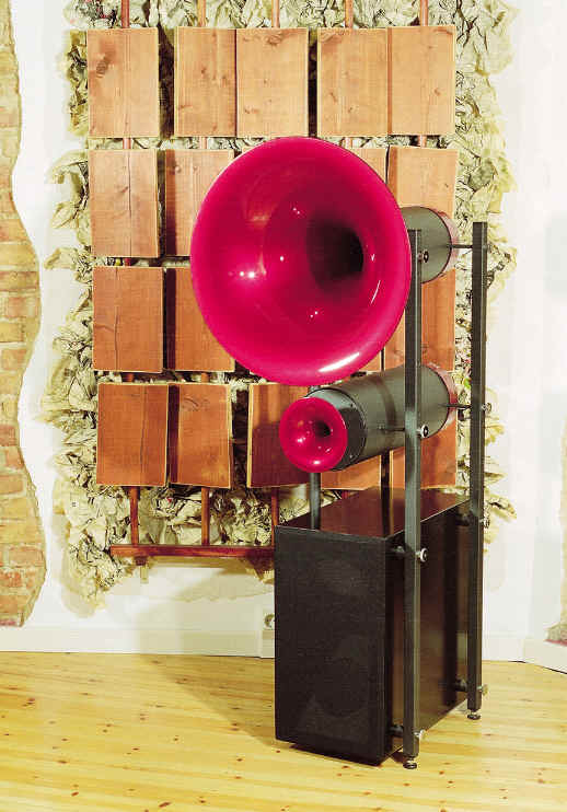

test with commercial speakers/amps
Hi, last week i had the chance to test the comlete equipment of a friend:
he has just bought this speakers for $10.000, the tube amps and tube pre ams for §9.000, cd player for $2500... all together (with cables and small parts) about $25.000.
And i just build my own speakers and the pass /modified X amps.
Result:mine sound really superb. Not, that the $25.000 equipment sounds bad - no- it really sounds very good. but when i think to the money i spend - my equipment is really extraordinary good. In many aspects mine are better, except of the max volume - but i dont need that loud as Ono`s can play.
And the end is not reached.... 😉
This is an encourging for those who have doubt about reaching that super sound of a superexpensive high-end equippment with diy -ing
thanks to those who are enabling this great forum.
regards,
Ralf
