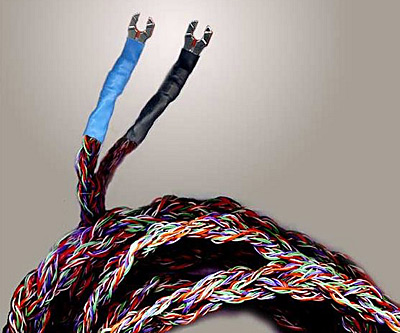

jh6you said:
Hi Ralf
Your pictures express very good systematic arrangement.
I suppose the sound must be great too.
In addition, your speaker cable attracts me. DIY? What kind?
JH
thank you,
the speaker cable is also diy and extremely good, but it takes very much time -and blisters to make. i found hardly a cable which was better.
you get informations at http://www.venhaus1.com/diycatfivecables.html

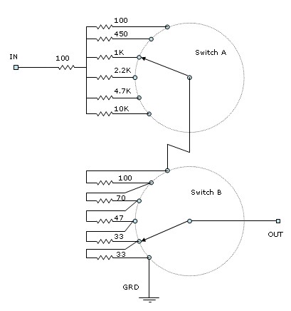

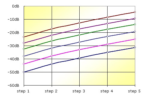

I have a plan to make a new attenuator volume for my unbalanced-balanced converter pre, BOSOZ. In this area where I live, however, I hardly find audiophile-grade of rotary switches of 2x11 or 2x24. Even if I find them, the prices are not a joke. Meanwhile, I can easily get reliable quality of cheap rotary switches of 2x6. Therefore, I am thinking to use two sets of 2x6 rotary switches to make my new attenuator volume.
The following drawing and diagram are self-explanatory. By the way, if you foresee any problem or have any better idea, could I share it? Thanks.
JH

My pot is at the input, and that is for a reason.
Vol. pot at the output of the XBSOZ is not a very god idear because it will affect the outimpedance of the XBSOS when it is turned down and thus lover the highend rolloff at the XSOZ. The XSOZ is very sensitive to changes in impedance. You shoud try it at the input.
If You usese one at the output, then it shoud have a very low value, say 200 Ohm or so, it´s a guess since I haven´t calculated it.
The noice from Your attenuater could be some DC level, and it may also be solved if it´s at the input.
