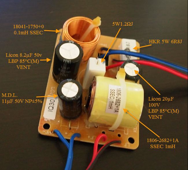

At risk of alienating you, this is a speaker I wouldn't buy. It has too many weaknesses and a few strengths. A typical cheaply engineered modern speaker. Initially quite bright and exciting sounding, but just not accurate and ultimately fatigueing. Like the Curate's egg, good in parts, and short of some considerable redesign, hardly worth throwing a lot of money at.
The better capacitors, non-ferrite coil and bigger Zobel resistor are not going to do any harm, but will not change it's basically bright and harsh sound.

You're barking up the wrong tree if you think that components are going to change the basic tonality much, my friend. A RC Zobel across the tweeter is going to transform the top to something a lot smoother.
Midrange harshness will be fixed by changing the woofer Zobel to a proper 2nd order with, say, 10uF or 20Uf and 1 ohm resistor replacing it. Couldn't suggest exact values without looking at a Sim and knowing the DC resistance of the drivers though. Might even consider a 1uF tank across the woofer coil to rolloff the bass around 5kHz as well.

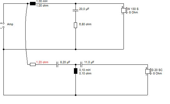

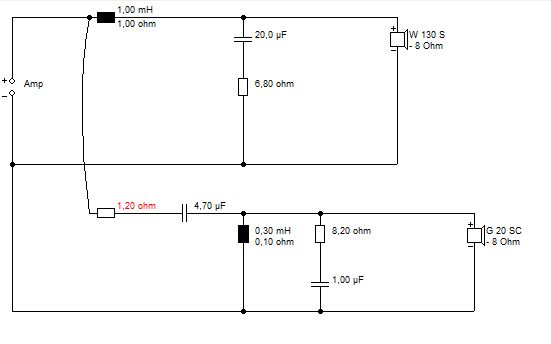

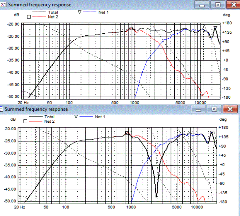

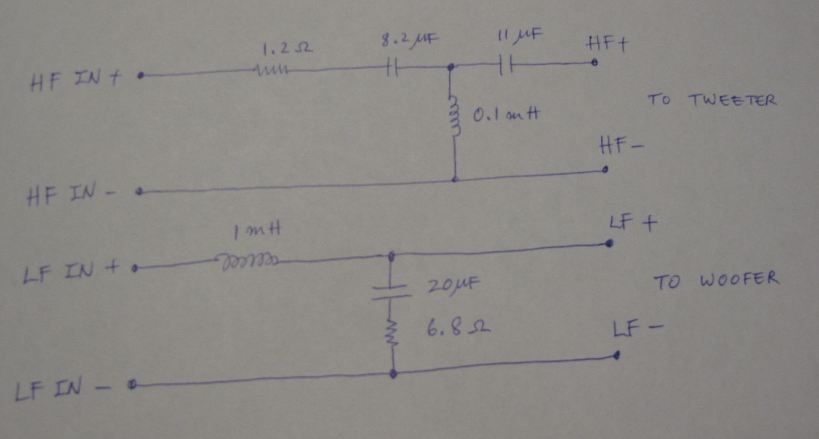

There isn't anything tragically wrong with the KEF crossover although it might not be perfect.

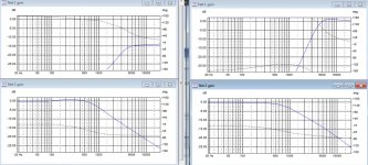

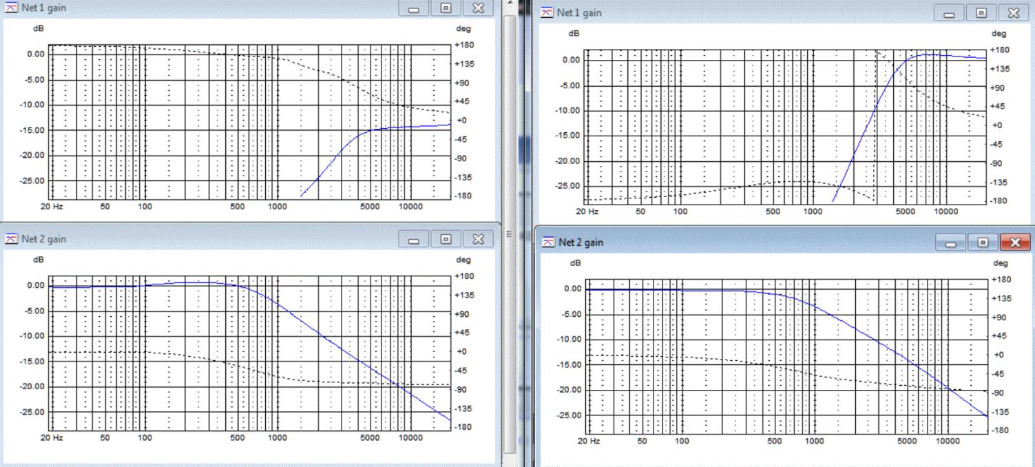

Below you can see a comparison of a loudspeaker I designed on the left with the KEF on the right.
The graphs show the electrical transfer functions of what the filters do. Tweeters on the top, woofers on the bottom. Reasonably standard values for Re and Le, for 8 ohm drivers, were chosen for the simulation of the KEF xover.
Both the KEF and my design use almost identical topologies, first order and zobel on the woofer with a third order + resistor on the tweeter. I used an L-pad on the tweeter whereas KEF just used a single resistor.
As can be seen the transfer functions follow very similar trends. The electrical phase of the tweeter crossovers is quite different, but that's not a surprise, the KEF uses a co-incident driver, whereas my design does not and was also designed for an odd listening axis too, well above the height of the loudspeaker.
How does this xover perform when combined with the drivers acoustic response?
Extremely well.
Of course this isn't to say that the KEF crossover is flawless, the point however is that the topology does indeed work.

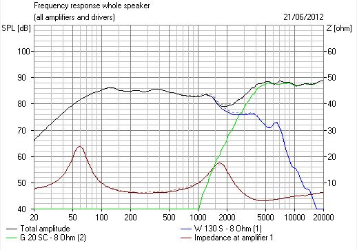

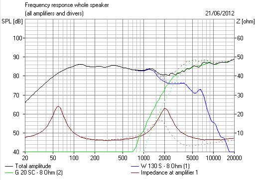

RAART, I'm struggling to keep this post short. But what I think is going on is that your KEF iQ30 speakers are STRUGGLING and it's hard to fix.
Problem is the TINY little concentric metal tweeters are very inefficient and driving impedance too low to give you any room to manouvre with the usual fixes.
The 1.2 ohm resistance driving a TINY 0.1mH coil is giving you a low impedance of around 3 ohms at 5kHz. Not good.
You have the usual metal dome problem of harshness and metallic colouration on classical music. I have yet to hear a metal dome that can render piano accurately. I did fix the impedance with a second order filter and tame the metallic tonality with a Zobel at the cost of some power handling. The Zobel needs some work from you though, because I don't accurately know the inductance or resistance of the tweeter.
