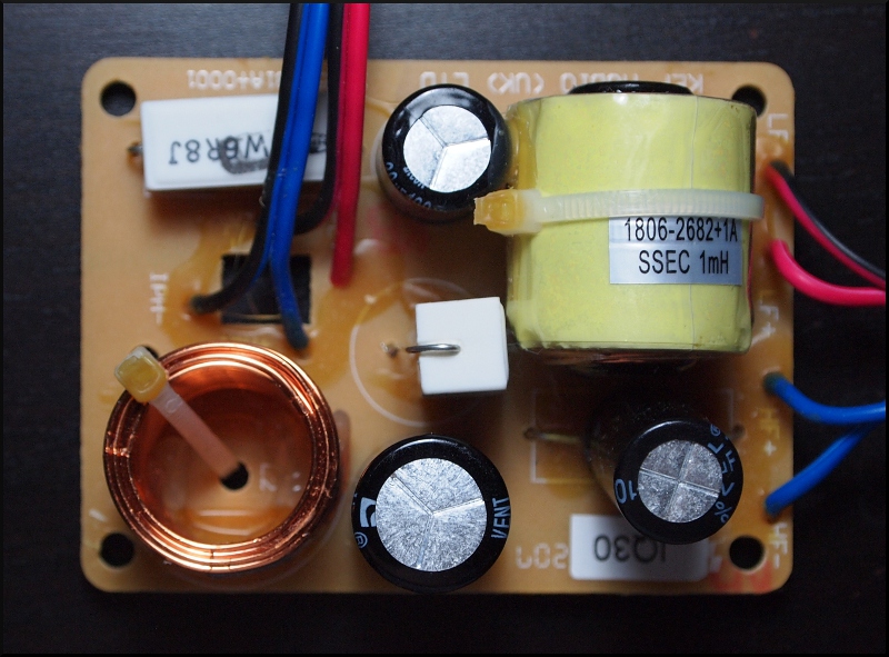

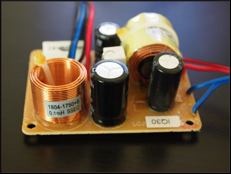

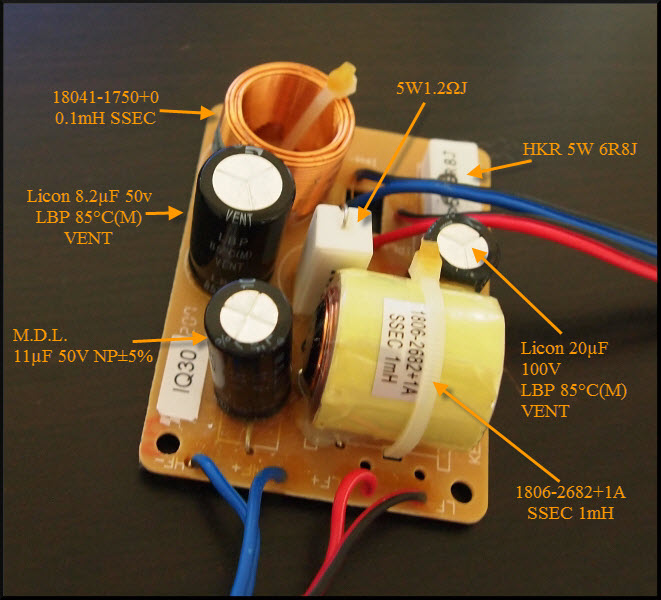

I attached some pics of the x-over w/values

Replace electrolytic capacitors with Clarity Cap ESA 250V or Mundorf MKP 250V capacitors.
Replace 5W sand cast resistors with 12W Mills resistors.
All inductors are left untouched.

Inductors have "difficult" parameters for newbies. You should be able to know their position/function in the circuit and replace with similar inductance/resistance. So what's the point in changing them in the case you don't want to change your crossover. Anyways is possible to build a new crossover if you know the complete set of parameters for them (inductors). An example, an air cored inductor is different from a iron core (DCR) if their value is the same (mH). Plus you have the diameter (AWG) of the conductor.

I wanted to get the inductors replaced while one xo doesn't work and I do not know which part is broken. This is the reason. By the way one inductor is air core and other one has ferrite core. I thought that all of them are the same as long as you have the value, and obviously I am wrong... I have to find service manual iQ30 to see what can be done.

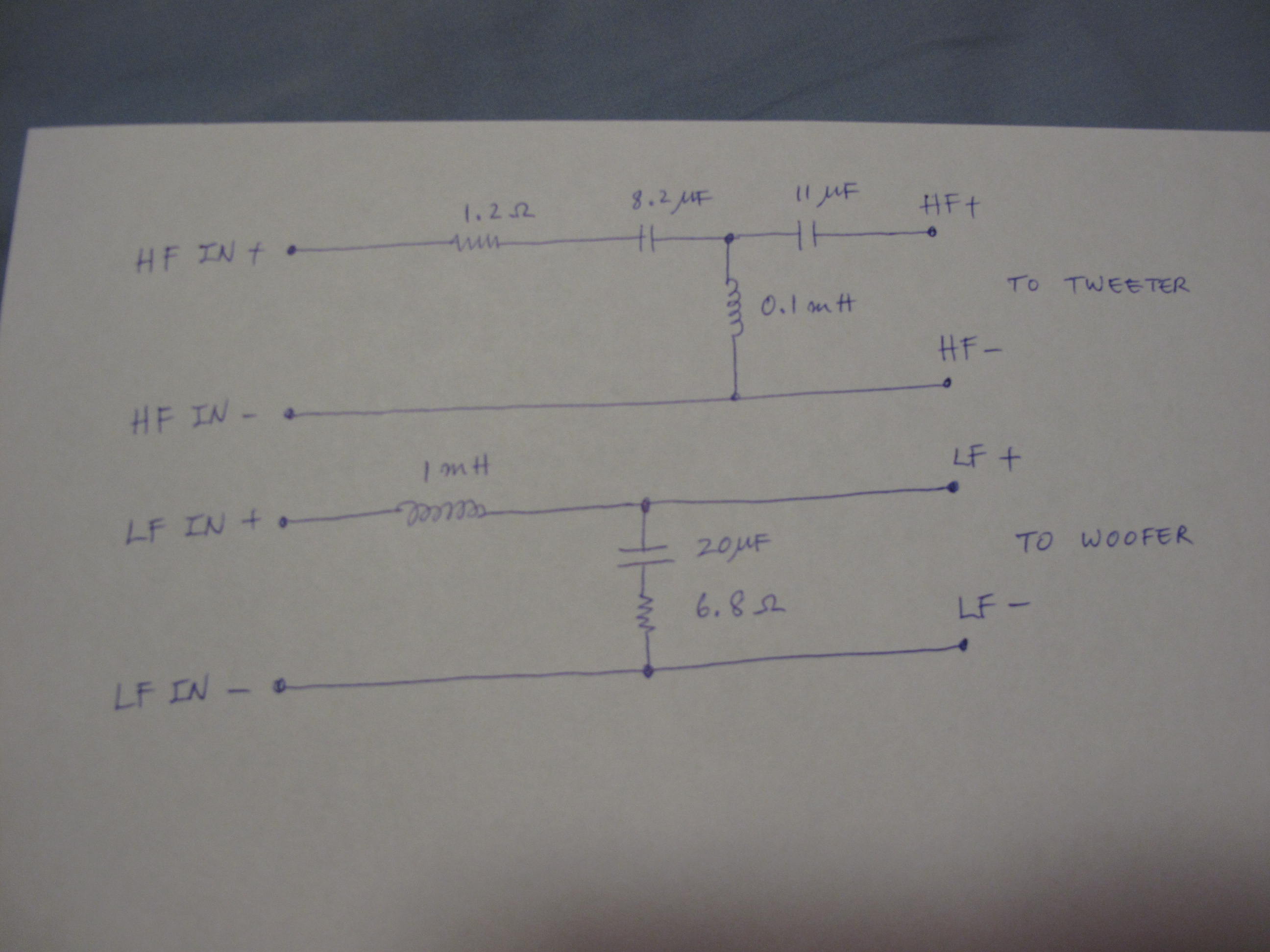

I look at the pictures of the crossover and guess that the crossover is second order for the tweeter(two capacitor and one inductor 0.1mH) and first order for the woofer(1mH inductor) with woofer impedance equalization(one resistor and one capacitor).The crossover is bi-wired crossover.

With two above pictures, I am able to draw the crossover schematic.Like I guess, the crossover has third order for tweeter and first order for woofer with impedance equalization for woofer.

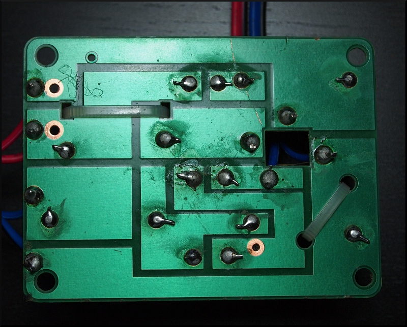

No sound from woofer.
1- Resolder two places of 1mH inductor to check solder joints.
2- By pass 1mH inductor by a bus wire to check inductor.
3- Check red wire connection from crossover to woofer.
4- Check red wire connection from post to crossover.
I think I found the problem... Need to check again however if you take a look at picture (bottom part of PCB) there is a hairline like cut. I assume that it was done by installation of the speaker in their factory but when I went and check the connection between the red wire and 6.8ohm resistor there was none. After I look closely this hairline was a crack on the PCB. I will solder a bridge there and recheck everything...

This is all a bit odd. To lose bass entirely is not going to be the bass capacitor or resistor. It's going to be a fault in the bass inductor path. It's not really very likely the bass coil has got a broken wire, so you're really looking for a dry joint on the circuit board bass section or complete break in the speaker wiring I think.
Edit. Ah you've found the break then. Just reflow it with solder having scratched off some insulation, I'd reckon.
