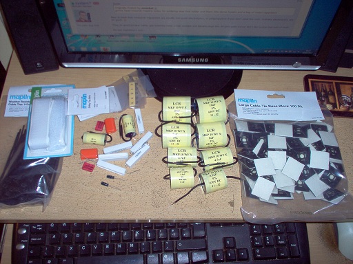

Did I show everybody my collection of polycaps? About £10 a pop for the 10uF jobbies. I couldn't be bothered to pay for silver or gold or anything, since these work:
