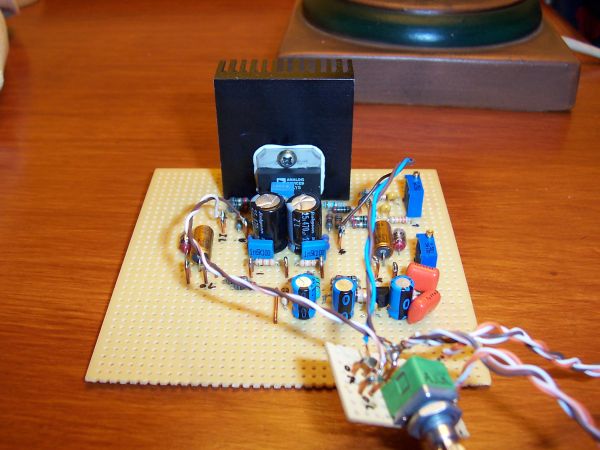

Thats an interesting looking pre-amp Carlos
I've actually got a couple of those SMD AD815's but never used them for anything yet, I can easily modify your amp and implement the AD815 if I can find my magnifying glass and tweezers
Is there any threads with the layout? I could build this easy enough from your schematic but how did you manage to fit all the parts so close to the chip, its tiny😀

t. said:Is there any threads with the layout? I could build this easy enough from your schematic but how did you manage to fit all the parts so close to the chip, its tiny😀
I could cheat and etch a board but no doubt its not as good as a tightly done p2p
Leo, the chip is not tiny, even the SMD version is quite big and relatively easy to work with.
Look at the datasheet for the pinout of the SMD version.
It has a perfect pinout.
It has the PSU pins located exactly where all the op-amps should, I mean if it was an 8 leg thing that would be pins 4 and 5.
I have never made a PCB for it, although I had the intention (but no time). My prototype (on veroboard) ended up as definitive inside my pre.
Some weeks ago Peter Daniel sent me some non-smd AD815 chips and I made this test setup.

I've just dug out my smd AD815, your right, its not as small as I thought but I know how important the layout is so i'd like to get it right😉
Excellent work from you again and thanks for sharing😎 I'll have a dig through my parts box, I've been after a nice pre for a while, I've got Nuuks tube pre to try too.
I presume an 8v reg would be ok for the nulling circuit

t. said:I presume an 8v reg would be ok for the nulling circuit
Yes, it's fine.
