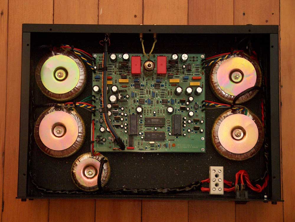

WHAT?????.......Jitter, my DAC does not have jitter. 😀 Carlos you just wish you had a DAC like mine. 😉
the Cap is to block 90v DC. and also determines the LF rolloff. so nothing to do with staging and what have you. here you lost it a bit 😉
for the rest. the LM3875 will always suffer, compared to my X-Calibre. the amp is simply the best 😀 , Ok maybe I am loosing it a bit.
as far as T.'s comments. I will try the snubber today and maybe incorporate it.

Wow, that's a hell of a claim.
Rudi, that is not possible, don't believe that marketing BS.
Whatever interface you use, NO JITTER is not possible in digital audio.
How do you know???!!!
I don't wish anything.
What staging???
You're lost, you didn't understand what I said at all.
It's exactly the LF rolloff point that I meant.
With a 1uF output cap, you'll have a high-pass filfer at ~16Hz if you use a 10k volume pot after it, a little on the high side, don't you think?
If you need this to have tighter bass, something else is wrong, you should not need to cut this high.
That's what I meant, take it constructively, and try to improve that.
Please.
