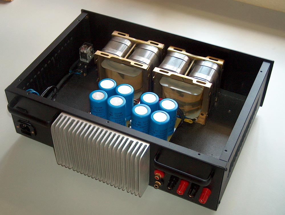

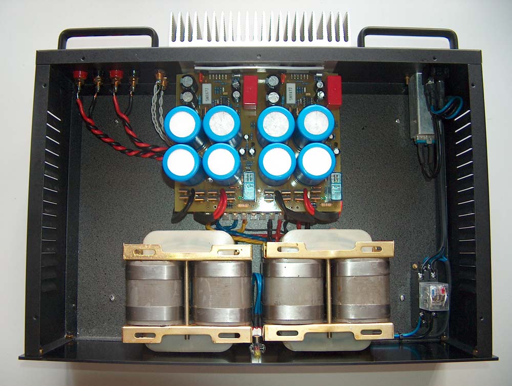

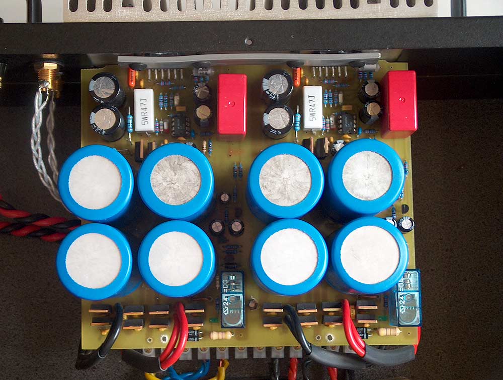

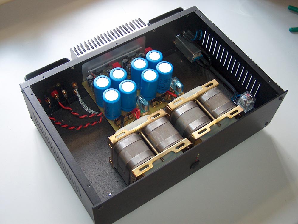

Rudi and I tested my amp (Pre=AD815 as per CFM, power=NI LM3875, MUR860’s, 300VA per channel, 1000uF per PS leg) against the Excalibur.
Before we get into the detail, Rudi hade made a mod to his DAC (reducing the output cap from 1.5uF to 1.0uF) which I think improved the overall sound of his system-basically the upper bass was not as warm, which I preferred.
Onto the shoot-out:
My amp had highs that were comparable to the X-amp, detailed, extended. This reflects the benefit of the AD815, since on its own, the NIGC 3875 highs tended to be relatively harsh.
That’s were the similarities end unfortunately.
The X-amp had better resolution and separation and presence on the mids. In comparison, my amp sounded a bit congested in the mids.
Also notable was the fact that the X-amp had much better layering, so that the various instruments existed more in their own space rather than being melded into one. But at the same time the amp still sounded organic, i.e. musical.
Bass performance was interesting: My amp went deep (the benefit of the AD815), but not as deep and fundamental as the X-amp-it is a real heavy weight in this department, some of the bass you feel more than hear. Also I’d say that the X-amp was perhaps more detailed.
Overall, the X-amp was more coherent/clean/clear and ultimately musical and enjoyable, especially in the mids vs my own. Less hifi, more music!
I would say that my own 3875 was transformed by the use of the AD815 and Rudi and I will be exploring using it on the X-amp.
