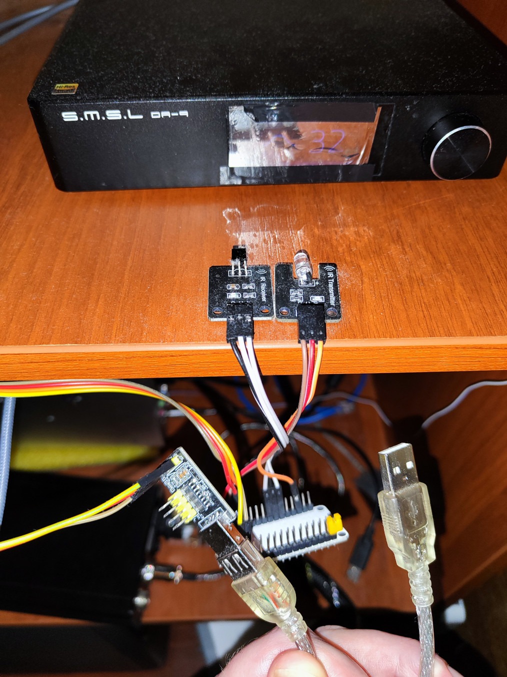

BTW, I found quite convenient to control wtfplay setup via wifi and amp via wifi->ir using arduino with modules.
