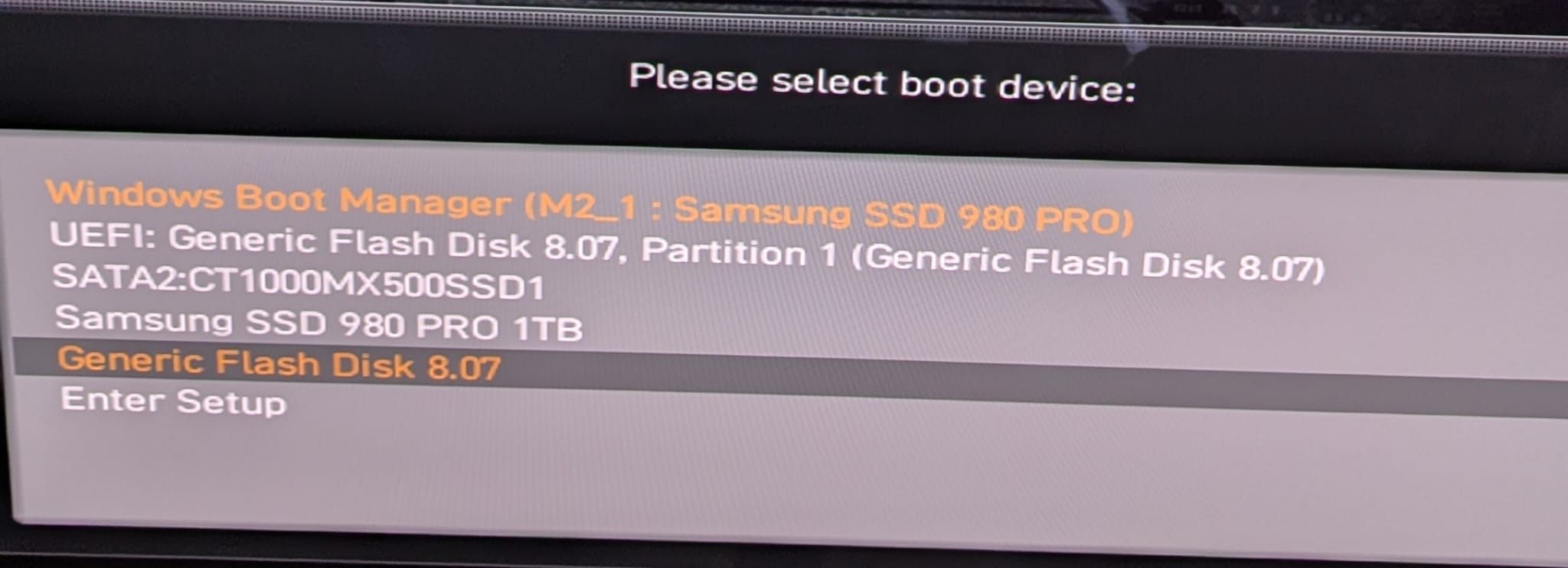

Good morning everyone,
I have a problem with the player and I would be very grateful to anyone who can help me.
On my old PC I used wtfplay with great satisfaction,
unfortunately now I can't run it on the new PC, composed of a b650 motherboard and a ryzen 7600 cpu.
Once loaded usb when I go to select the kernel it gives me this error
error: no such device: /vmlinuz.057.
error: file/vmlinuz.057' not found.
error: you need to load the kernel first.
Press any key to continue..
I'll start by saying that I tried the amda8 amdbd1 corei7-avx iso, disabled secure boot from the bios, switched the legacy - uefi modes but the error persists.
You want to tell me that the program is not compatible with the ryzen or the b650, I haven't found any info anywhere.
Thank you and greetings from Italy! Sorry for my English

Hi @Argentax,
The most up to date AMD computer that I have at my disposal is Lenovo X13 with Ryzen 6650U. I have just checked and wtfplay-live booted successfully in UEFI mode with Secure Boot disabled and Legacy Boot disabled.
Sadly, I have no access to a hardware with B650 chipset. What is the model of your motherboard exactly? I can check the BIOS documentation.
I understand that you are trying to boot in the Legacy mode. Have you tried booting in UEFI? If so, what is the result?

Hi @Frd_,
first of all thanks for your interest!
my card is an msi b650 tomahawk.
I tried to set the bios in both Legacy and UEFI mode, but to give you a 100% sure answer give me time to get home and I'll try again tonight, I wouldn't want to have made some mistakes given my little experience with the various bios menus.
Finally I take this opportunity to ask you if the amda8 iso is the most suitable for ryzen 7600.

guys I confirm that it works. I changed the bios to CSM mode. Now I'll proceed with the configuration but there shouldn't be any problems since I already have experience with the old PC. Thanks again Frd_
What is the actual cause of the error message 'no such device: /vmlinuz.057'? IIUC it's grub not finding the kernel image on the USB flash, but why is that? Apparently grub gets to start (so the bios boot layer does start grub), but grub cannot continue. Is it because incorrect grub is started (e.g. the legacy bios grub instead of the UEFI grub) and that grub is not configured correctly? The booting issues in modern PCs with legacy/UEFI never cease to amaze me.

Argentax, good stuff! I am happy to hear that you managed to boot the system.
phofman, there are actually two bootloaders: isolinux and grub. Grub is only used when booting in UEFI mode and it appears that this is the the case here. "you need to load the kernel first" comes from Grub. All Grub needs to boot is the access to EFI pairttion.
And this is when I am puzzled. Initially I thought that the firmware does not like the old DOS partition table, but it managed to load the bootloader from the DOS partition. Then the firmware decided not to expose DOS paritions to Grub? Does not make sense.
Then there is a question about the compatiblity mode (CSM). What does it do exactly?
To be honest this is not the first case of weird UEFI behaviour I am hearing about. I had a case when a PC refused to load the bootloader and was dropping straight to UEFI shell. When I executed the bootloader from manually from the shell, it was all file. Eventually I figured out what that was. The firmware was looking for the bootloader in the root directory of the EFI partition.

Buongiorno a tutti,
Purtroppo, tra lavoro, famiglia e cane, ho poco tempo.
Comunque volevo informarti che, utilizzando il BIOS in modalità CSM, all'avvio il PC rileva la stessa USB due volte:
in UEFI arriva Flash generico (2a riga)
nel generico Flash Disk (5a riga)
Se si avvia la prima opzione, il PC si carica finché non viene scelto il kernel, dopodiché viene visualizzato l'errore descritto sopra.
Se invece si avvia la seconda opzione, il programma funziona quasi correttamente.

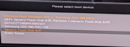

Unfortunately, between work, family and dog, I have little time.
However, I wanted to inform you that, using the BIOS in CSM mode, at boot the PC detects the same USB twice:
in UEFI generic Flash (2nd line)
arrives in generic Flash Disk (5th line)
If you start the first option, the PC loads until the kernel is chosen, after which the error described above is displayed.
If you start the second option, the program works almost correctly.
