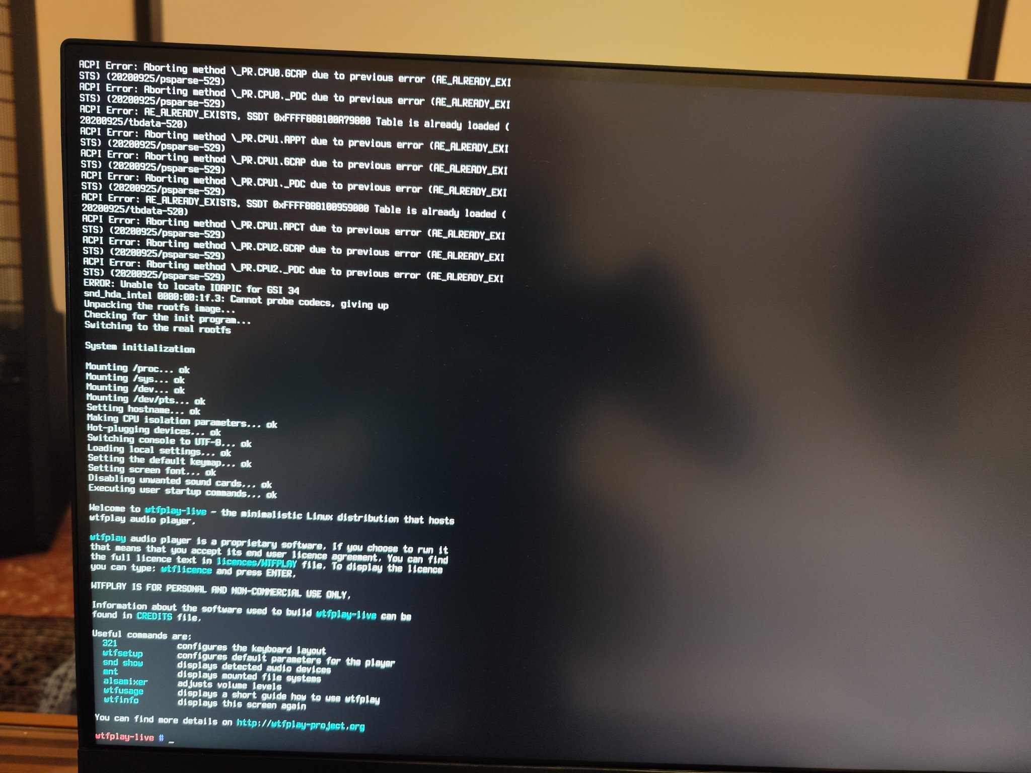

@moghetto: Are you using USB-C port to connect the keyboard? As far as I can see, all USB-C ports in Macmini 2018 are wired through Thunderbolt controller. Thunderbolt will not work under wrfplay-live, and that would mean that none of those USB-C ports will work. Also, the spec lists two USB-A ports. These may be wired to XHCI controller. If this is the case they should work.

Hi, thanks for reply. I still have to find and so, test, a wired keyboard, Yes, when I'll get the wired keyboaed, it will be connected to the USB/A port, anyway I still don't understand why my magic keyboard works with the old macmini and not with the "new" one...I'll let you know as soon I'll try a wired keyboard..

IIUC the new macmini has the USB ports you use provided by thunderbolt which as @frd__ says is not supported by the wtfplay kernel. Whereas the old macmini uses a standard xHCI USB controller which has been supported by linux for decades. Testing the wired USB keyboard will tell more.anyway I still don't understand why my magic keyboard works with the old macmini and not with the "new" one..
Sorry, may be I haven't understood,...My apple magic keyboard is wireless and works fine with the old mac mini... not with the new one. Even if a wired keyboard will work with the new macmini, a wireless keyboard (apple or not) will not ?
The first step is finding some way to communicate with your device. I am not sure you can do any troubleshooting wtfplay without a working keyboard, whether is runs some network access server like ssh etc.
If the USB controller in the new macmini is not supported, no USB device will work, logically.
Good evening everyone, Tried a wired usb keyboard and works ok. I still don't understand why the wireless keyboard works on the 2011 macmini but not with the 2018...
OK, good. At least now you have a control over the computer. I am guessing that you are using USB-A ports to connect the keyboard. This also means that they are indeed wired to xHCI controller.
Regarding the wireless keyboard of yours: does this keyboard come with some sort USB dongle that you need to plug into USB port to get it working? I read that Apple keyboards can also use USB-C cable and Bluetooth. Well, Bluetooth will not work with wtfplay-live (no BT drivers in the system). TBH, I am not familiar with Apple device ecosystem at all.
Mi apple wireless keyboard doesn't have any cable to conect to the macmini, it is just wireless...May be the MAcos system can do the difference ? On the 2011 with "mountain lion" works, on the 2018 with "sequoia" doesn't. Anyway many thanks for your help..
