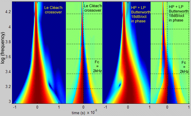

Hello,
In order to illustrate the possibility of visualisation of both the amplitude and phse on a spectrogram, I attached a graph where the quasi wavelets of the IR resulting from the summation of a low-pass and and high pass crossover is shown. On left a Le Cléac'h crossover, on right a Butterworth 3rd order (LP and HP in same polarity).
I have to ameliorate somewhat the look-up table (LUT) in order to improve the visualsiation, but I think that new kind of graph may be useful in certain cases.
Best regards from Paris, France
Jean-Michel Le Cléac'h

Jean-Michel,
I don't get the phase plot. Is that a phase versus time at each particular frequency? If I put a wavelet through a filter I don't get abrupt phase changes like I'm interpreting from your graph.
- Elias
