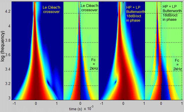

Here's J321 horn phase plot:
If we choose a slice of phase at the t = 0ms, we have the conventional phase response for free! One can use this also when aligning cross-overs, for example.
Yes, this is interesting!
- Elias
Now the question is what we can learn from the phase plot
One observation can be made:
Even to study simples 2 ways crossovers I find it interesting as in the example I gave:
http://www.diyaudio.com/forums/atta...audio-measurements-what-how-wavelet_phase.gif
- Elias
