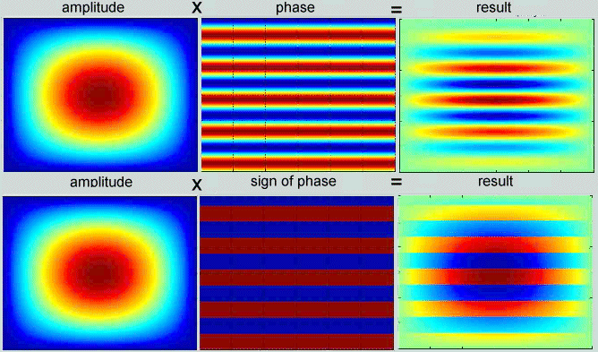

Hello Elias,
One of the advantages of my quasi-wavelets method is that it delivers both amplitude and phase at each frequency/time couple.(Because I use 2 convolutions one with a gaussian cosine pulse , the other one with a gaussian sine pulse.)
Then the difficult thing is the visualisation of both on the same graph.
Give a look to the attached graph (a theorical simplistic case that I use to optimize the LUT).
In the upper row you have the amplitude spectrogram on left, the phase spectrogram on middle and the result from the multiply on right. It is quite difficult to analyze that graph (please note the wavy isochrome contours)
That's why I prefer to use only the sign of the phase (bottom row in the middle) to multiply the amplitude spectrogram. I find the result more easy to analyse (see bottom right).

I don't get the phase plot. Is that a phase versus time at each particular frequency? If I put a wavelet through a filter I don't get abrupt phase changes like I'm interpreting from your graph.

Hello Elias
Your graph hurts because that only phase and because phase being defined everywhere on the plane frequency/time you have colors everywhere.
That's why I never shown any phase graph but I shown an hybrid graph which is the result of the product between amplitude and phase. In that case if the amplitude tend toward zero then the product phase by amplitude do the same... the graph doesn't hurt anymore.
As I wrote in a recent message I don't think such hybrid graph will be useful to characterize a single driver (in the hypothesis it is a minimum phase device) but it will be more useful when aligning acoustic centers and choosing the settings of the crossover in a mutiways system. (In that case the behaviour of the system is often non minimum phase...).
Even to study simples 2 ways crossovers I find it interesting as in the example I gave:
http://www.diyaudio.com/forums/atta...audio-measurements-what-how-wavelet_phase.gif
on which we can see what frequency ranges are out of phase with others.

phase plot:
... the phase plot makes my eyes hurt
Now the question is what we can learn from the phase plot that is not observable from the amplitude plot?
Those overlaid frequency / phase plots are really interesting !
The LeCleach XO topology looks great too.
Where do the reflections at the top end come from ? - I think this are electric measurements - no ?
For *loudspeaker measurements* possibly overlaying only a dotted line where the phase changes sign may be less irritating then overlaying colors - if this can be done easily ?
Elias your phase plot looks like coral reef - beautiful but irritating!
