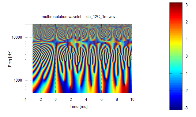

Here you make two mistakes. There is no problem with the high freqs with wavelets. And the phase reference is defined by the impulse response and the wavelet do not change it.
Here I attach a plot of wavelet phase of a loudspeaker. The phase plot is in the reange [-pi...pi]. You can have the phase at every given frequency at the every given time you like.
If the impulse response would be ideal the phase at t=0 is zero at every frequency. This loudspeaker comes quite close but it is not ideal.
- Elias
Wavelets are by no means the optimal TFR, the wavelet transform distorts amplitudes (HF is attenuated) and does not maintain absolute phase reference.
Referenced to an absolute time, as an example the phase values in a Fourier Transform are referenced to t=0
Elias, you haven't understood either statement, but nothing new there. I can't be bothered to explain it to you, given the poor results that has produced in the past. Read through Stockwell's papers "Why use the S-transform" and "A basis for efficient representation of the S-transform" for a detailed explanation, you can find them here.
