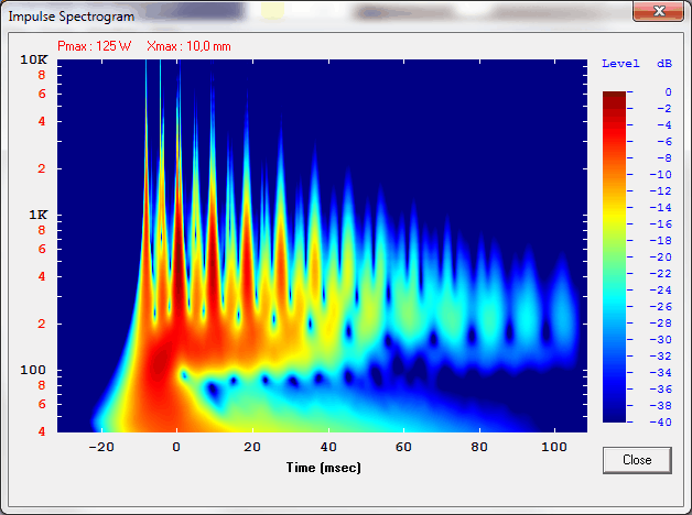

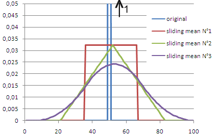

Hello Elias,
Thanks for the formula, I'll see what I can do with it.
In the original version of my quasiwavelets Matlab routine I used a Gaussian window.
But in the latest version, the one used in David McBean's software "Hornresp" see as an example
http://www.diyaudio.com/forums/attachments/subwoofers/177241d1277209292-hornresp-2.png
, which is a superfast quasiwavelets routine specially written to be easily translated under Visual Basic I don't use any time consuming function as EXP, LOG... I use a quasi Gaussian window (of finite width) obtained by applying 3 steps of a sliding mean.
A graphical explanation is given by the graph
http://www.diyaudio.com/forums/attachments/subwoofers/186359d1283504299-hornresp-sliding_means.gif
Simplistic explanations (too much simplistic may be so in the end I don't know if it is understandable...) of my fast quasi wavelets algorithm is given in message:
http://www.diyaudio.com/forums/subwoofers/119854-hornresp-142.html#post2292136
Best regards from Paris, France
Jean-Michel Le Cléac'h
