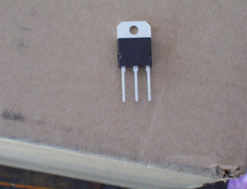

Looks like I ordered the MUR3060 from On-Semi with the uninsulated tab.
Makes me wonder how to bolt these things down without bringing current into the chassis. Will the anode pass current into aluminum?
Here are the units.
http://www.onsemi.com/pub_link/Collateral/MUR3020PT-D.PDF
I have only worked with the gainclone and axial diodes without heatsinks, so dont know how bolting this to the chassis (using a mica insulator of course on bottom, will affect things. Won't some current go through the bolt?

MUR3060
Thanks Peter
I assume something small that will fit through the middle, to contact away from bolt to anode. If anyone has any idea where to get them, let me know. Else I will bug digi-key and mouser.
Thanks Peter
You can also use an aluminum bar to pin your transistors, that way you only require a mica pad and no through-hole
isolators.
