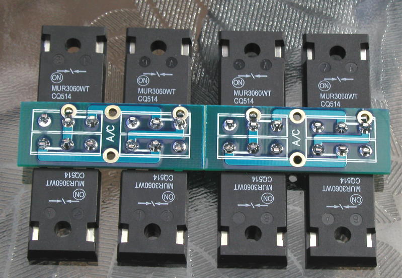

One question, Peter:
Is it wise to solder the Rectifiers on the you PS-Board for a F4 ? Don't they need heatsinks ?
The board was designed in such a way that rectifiers can be attached directly to the chassis for heat dissipation. I never liked those small heatsinks people use for rectifiers 😉
More info here: http://www.diyaudio.com/forums/showthread.php?postid=1237660#post1237660

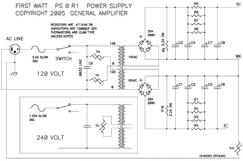

Power Supply PCB
Got my PCB sets in. Thanks for the quick shipment.
I got a few power supply questions.
Okay, assuming I dont want to use Jensen 4 poles.
I am a bit confused on the power supplies. If I want to do a stereo set, using one PS PCB, how does one get 120,000uf per channel?
I am thinking that I either need 30,000uf caps, hard to find, or mount 15,000uf on top and bottom to make this work. Any ideas?
I assume the 3 pin holes near the resistors are placed are for a regulated PS and not something in the BOM that mentioned.
A previous BOM mentions only four 15,000uf caps for a stereo set ( I beleive)

I'm using Peter Daniel's power supply board. It is CRC configuration with two 15,000uf 35v caps on the +23v rail and two on the -23v rail on either side of the resistors. Four caps total per stereo amp. R is four 0.47R 5W resistors per rail.

TMS, this would seem to be half of the PASS recommended supply. 60,000 total, not 120,000uf. If this is okay, I will go with that, it is cheaper. Otherwise I could try 4 47000, or try mounting some on top and bottom. Just wonder what others were doing with one PCB module for a stereo set.
I might have missed an earlier post about recommended layouts with one PS PCB.
Mike
Mike
I just figured I'd get it put together that way and see how it performed. Worst case, solder 4 more caps via very short wires to the bottom of the board.

As to the caps, 4 x 15,000uF might still be enough for a stereo amp and Percy has on sale Nichicon Super Through 15,000/63 caps at $15/pc (50% regular price)
I used two of them per Zv9 monoblock and again, it worked fine.

I have the Mills 0.47R's, so planned to use those. My PS caps are Panasonic TS-HA's for now, so hopefully 30,000uf per rail is ok.
