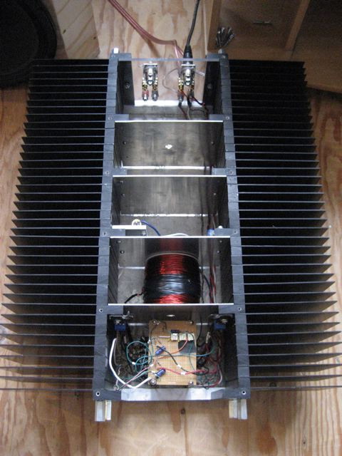

Re: F4 Chassis
samkhanski said:

162.56 h (6.4") X 596.90 d (23.5") seems to be the size of the heatsinks. The fins appear to be 25mm (1.0"). Going on gut, it may work, but I'd rather see the fins protruding a bit longer for some breathing room. The chassis is probably quite spendy. You might be better off purchasing a bare chassis, adding heat sinks to the sides and designing your own face plate.

mithomas said:
Carpenter,
I plan on using the Conrad Heatsinks, but am wondering if others could post some other workable options.
You mention chassis,
Any vendors you or anyone else can recommend to buy?
I looked at the above mentioned chassis, shipping from Overseas to USA is at least 150 on the slow boat, and it's a 300-350 dollar US chassis.
I think I will work with local CNC people first, if there isn't another common chassis to be recommended for F1-F4 clones for breathing room.
I tend to fab my own chassis. Here's a test bed I used to play with. It's now reconfigured into four different amplifiers.
Peter,
If you ever decide to put together chassis kits for the F4 I'd be more than interested in buying a couple from you! But to be honest I'm not sure how I'd manage to put together something like your creations in my apartment without making an utter mess...
