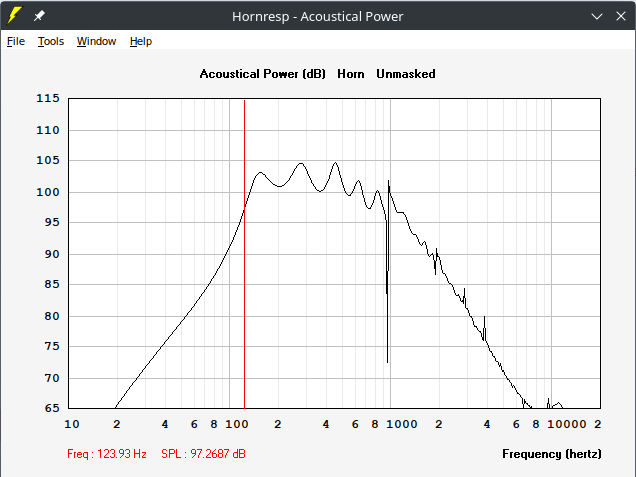

Would a small folded midrange horn work?

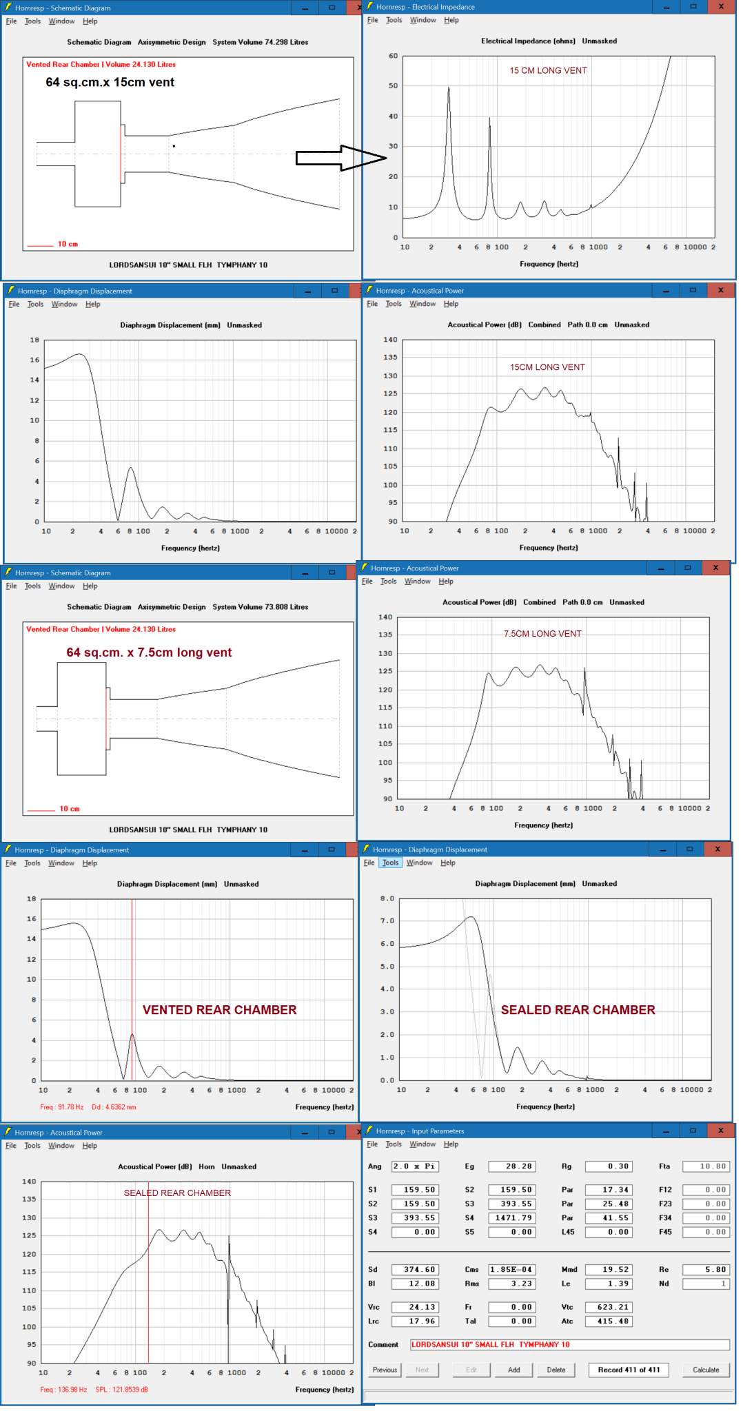

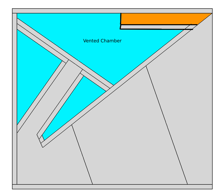

I ran it unmasked regular but did not put that in the plot - What do you mean by "VENT? I'm going to have to sell/give/throw away most of my toy collection as my kid needs the house. FH1/Sentry IV, many horns , woofers -, Karlson stuff, Bruce Edgar System 100, 50Hz C horns, etc. - so another horn will not happen - maybe I'll sneak in a little Karlson toy ;^).

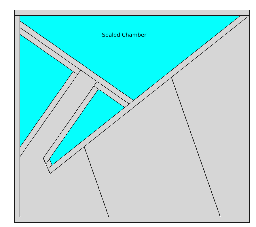

It means the opposite of sealed chamber, so it has an aperture to reinforce the low frequencies like Bass Reflex compared to Sealed box.
Check the attached picture to clarify.

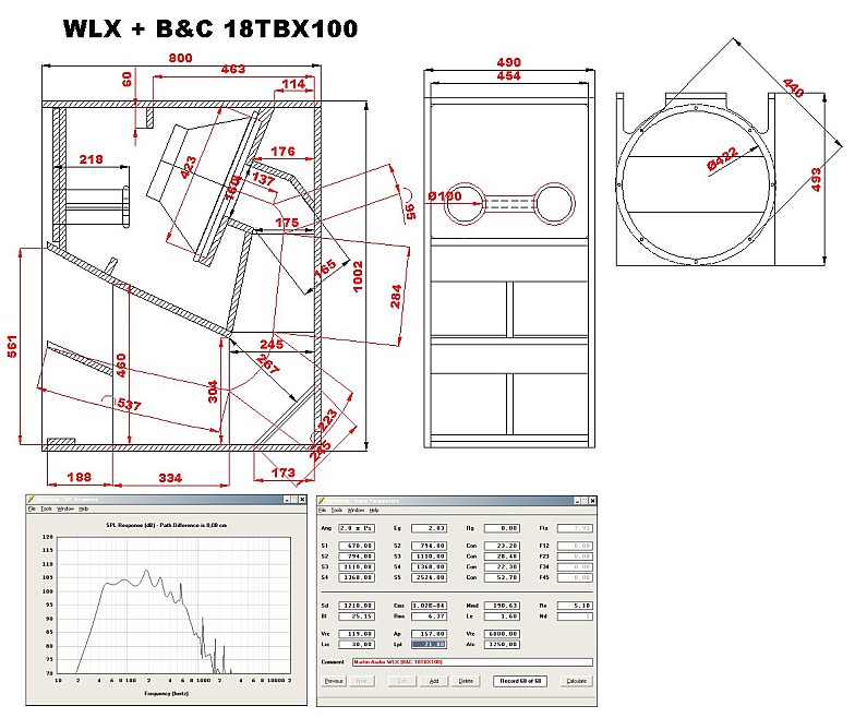

Like Martin Audio WLX, Altec816/817
While with sealed chamber the Front Load Horn is a 4th order box, adding vent to the chamber it will became 6th order and so you reinforce the low end.

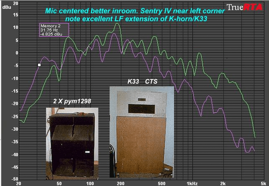

Freddi, be curious on your take: FH1 vs EV Sentry Bin. I think it's the 5050? I recently acquired a pair and just started in on the refoaming. Nice collection! Got any University Classics?
Hi Zwiller - IIRC it is the 5050 (Ray Newman) and didn't try to re-foam the original Gefco woofers. Instead I
used Eminence built Pyle PYM1298 (same as Kappa 12A) Bill Woods said itt works best with the Gefco woofer. (I don't think it would matter all that much and that Kapp12 might be a bit more sesitive -

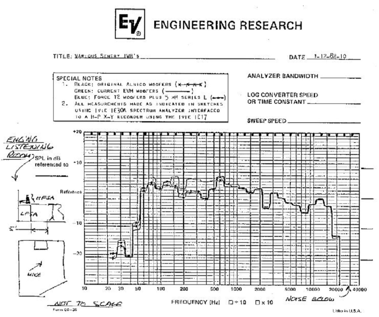

Look at E-V's graph (
IIRC - got this from Jim Hunter - ?)
FH1 is smooth - but I don't like it and prefer a Karlson.
Sentry IV's basshorn is very cool

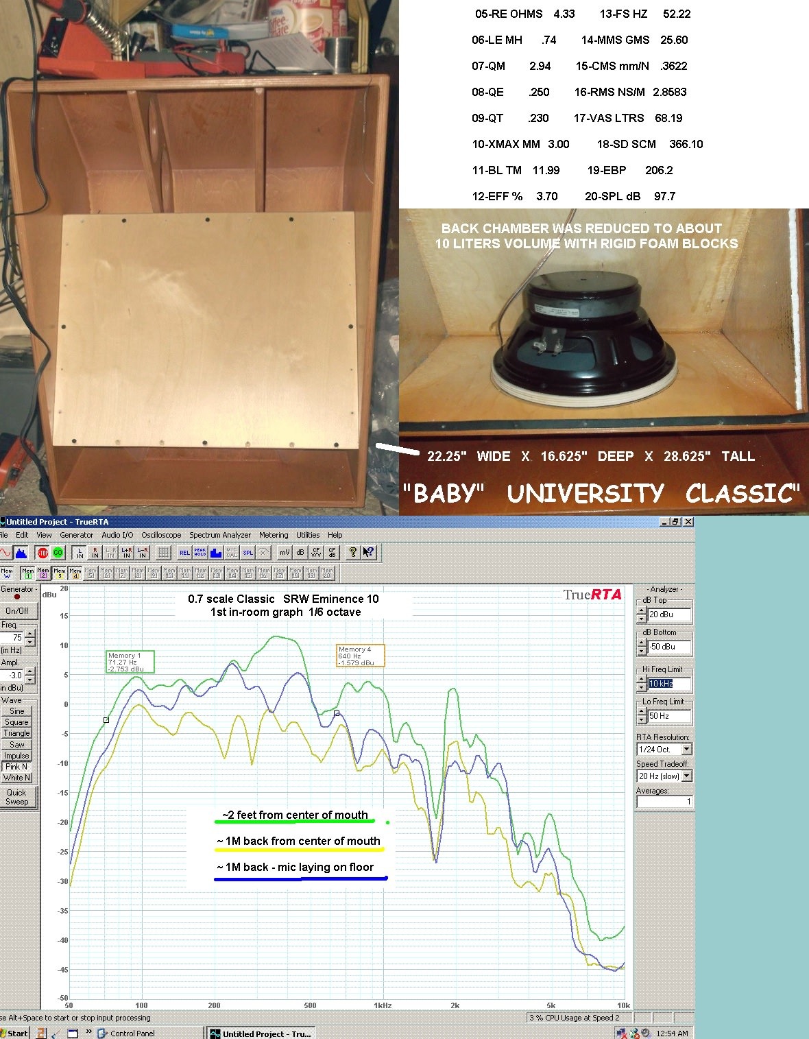

- never got o hear a Classic -but had a 2/3 scale one built - love it.

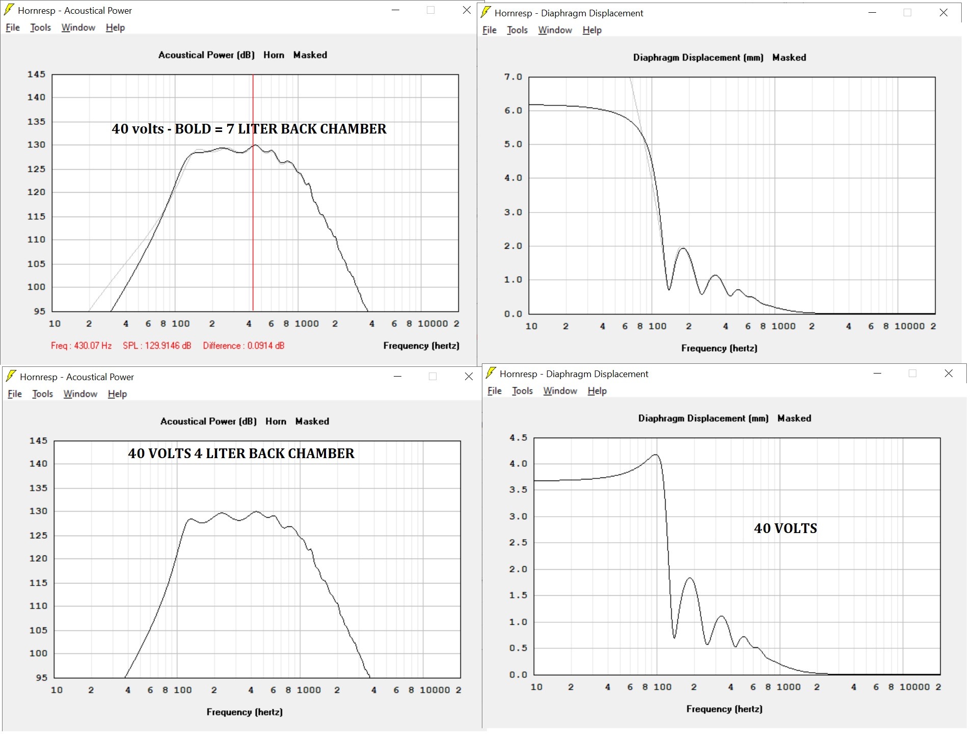

@LORDSANSUI - IF I can get an adept long distance friend talked into it - I maybe have him make one horn - I'm old/ill - never did PA work -not driven for the last 30 years - it would be a home toy - would reduce the back chamber volume with rigid foam - maybe make it two way if a small horn would fit and not hit the 10 inch driver.

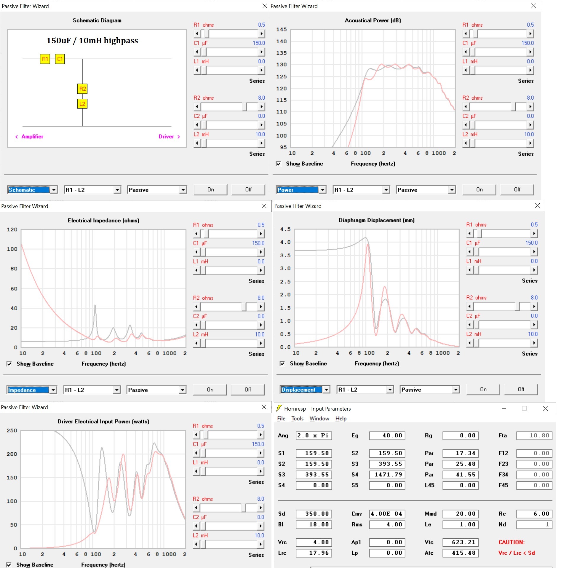

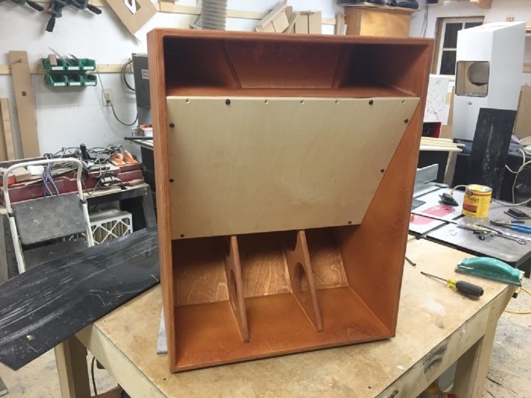

Regarding the first section (159.5cm2) that appears in hornresp to be a constant area section while on the plan looks to downward taper (?? could be my poor eyesight that doesn't converge ?) Could you display that picture perhaps in a easier to read form (with crtical dims) for my builder to consider?
I was going to go with another "Karlson" but don't have akabak, etc. skills to make some guesses. Also, I think your horn could play voice and snare drum sounds quite well.

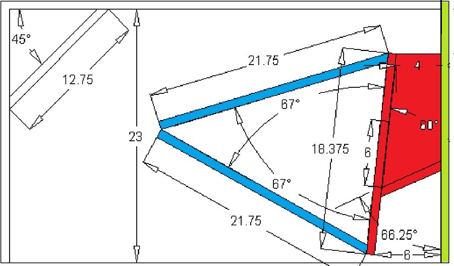

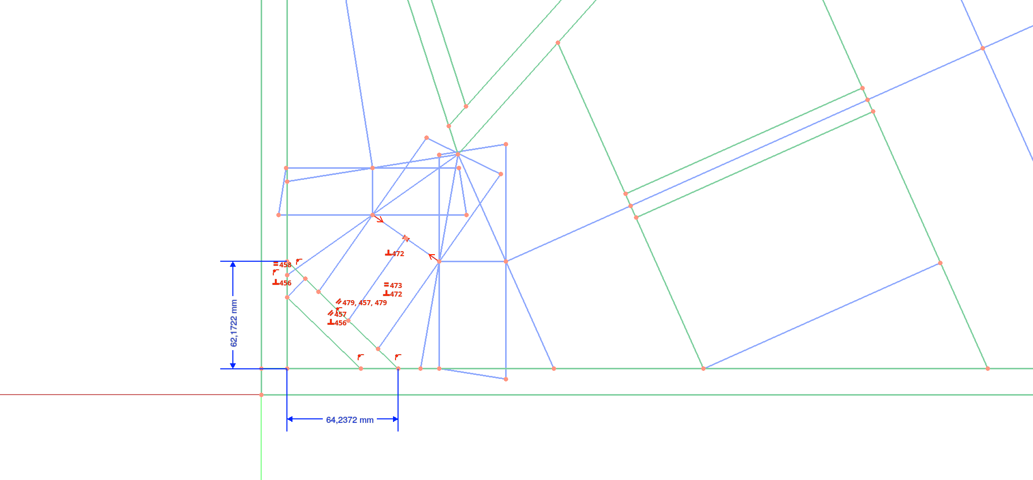

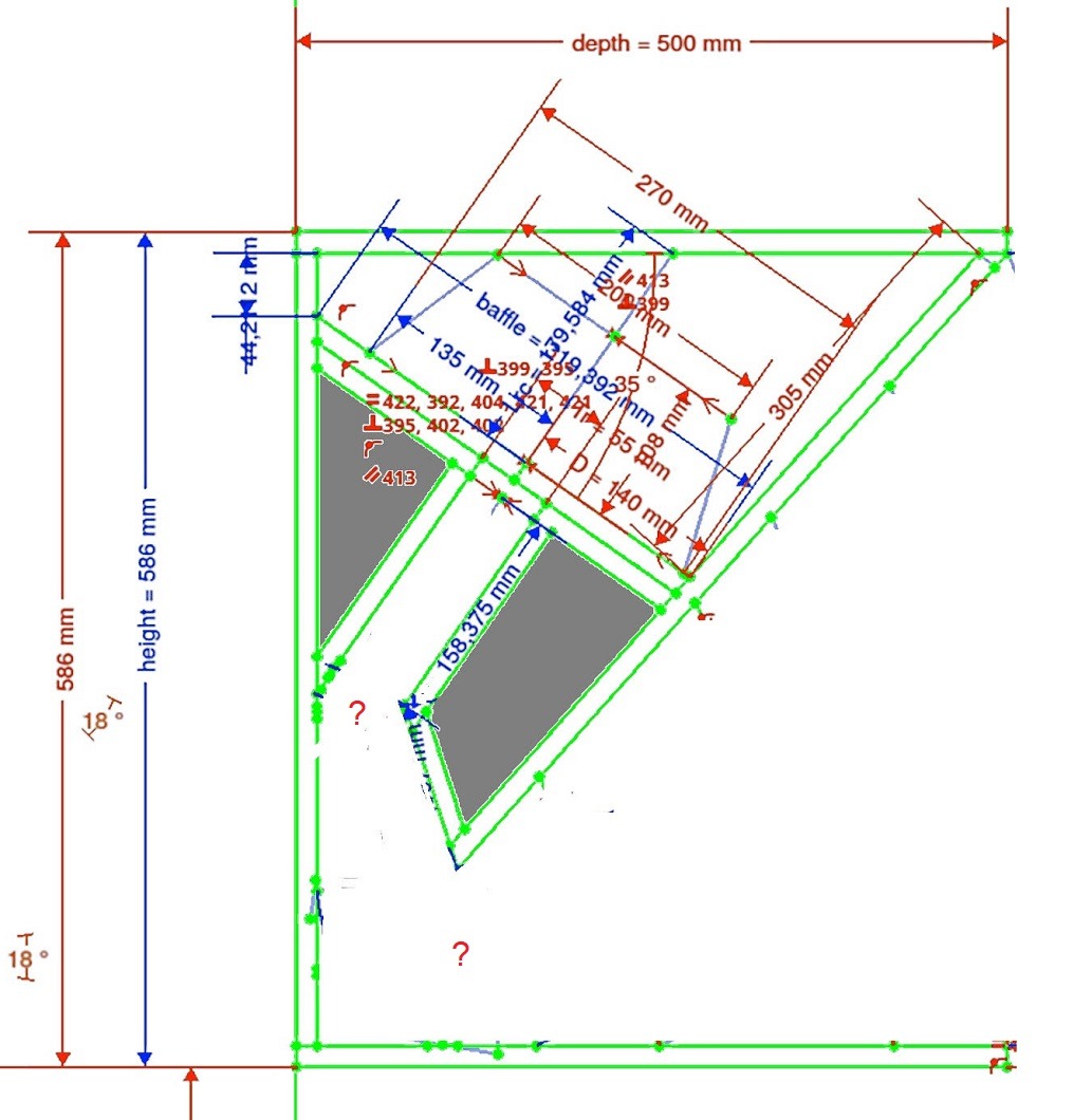

Dear LordSansui - my vision is poor - I need the internal width of the horn, and a few critical dims as indicated by the areas with "?"
Would a corner reflector at the bottom turn be of benefit? - If so, what size would you make it?
my buddy is ready to layout the horn sides - he needs in the internal width and
dimensions indicated by the question marks below. Diabetes is killing my vision.
How thick are the walls? - Might I nestle a treble horn in its mouth for a 2-way? might have to be 3 if the next horn has to go down "low".

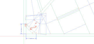

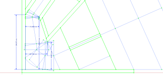

See attachment #1

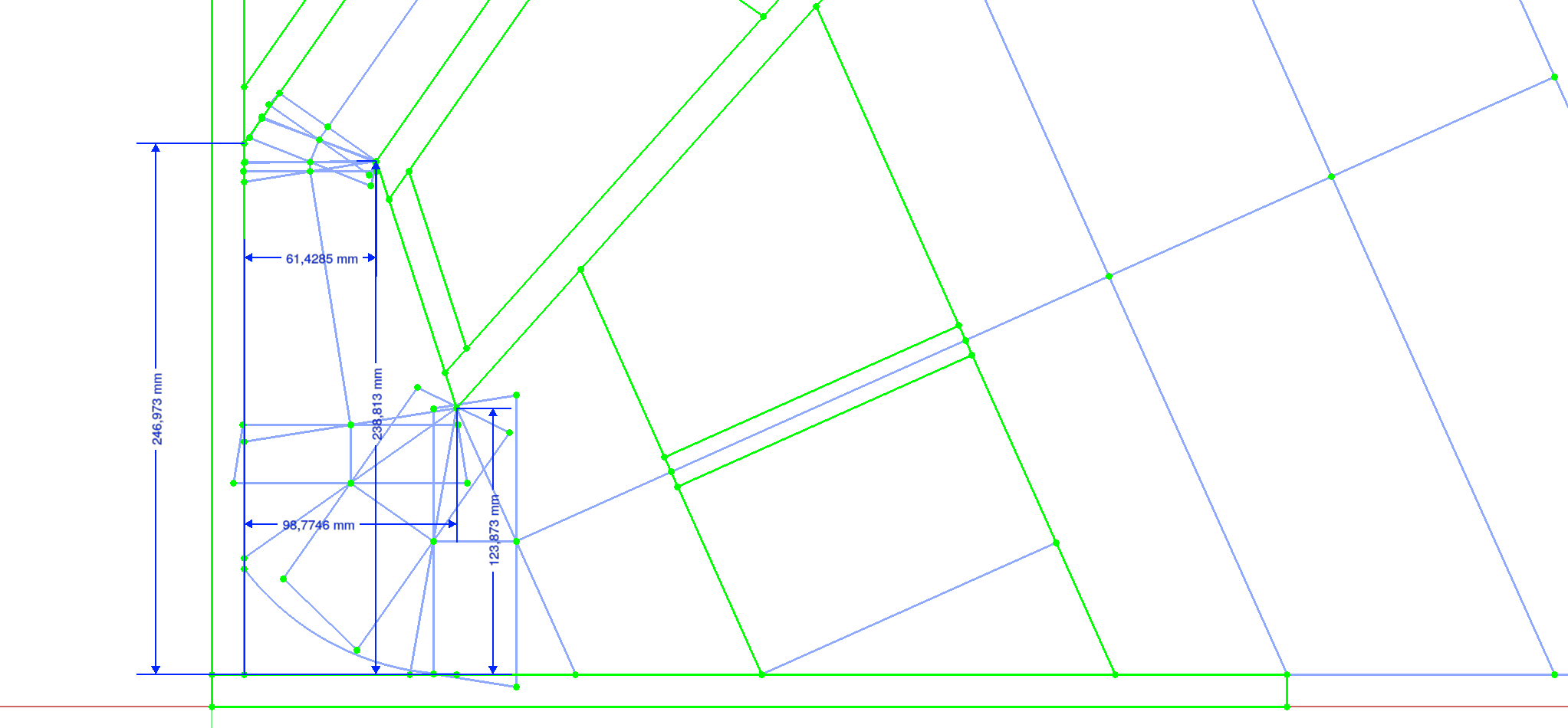

I didn't went too deep in the design but considering the max bandwidth extension i would put a reflector there in order to minimize the risk for reflection. See attachment #2 as suggestions.
15mm

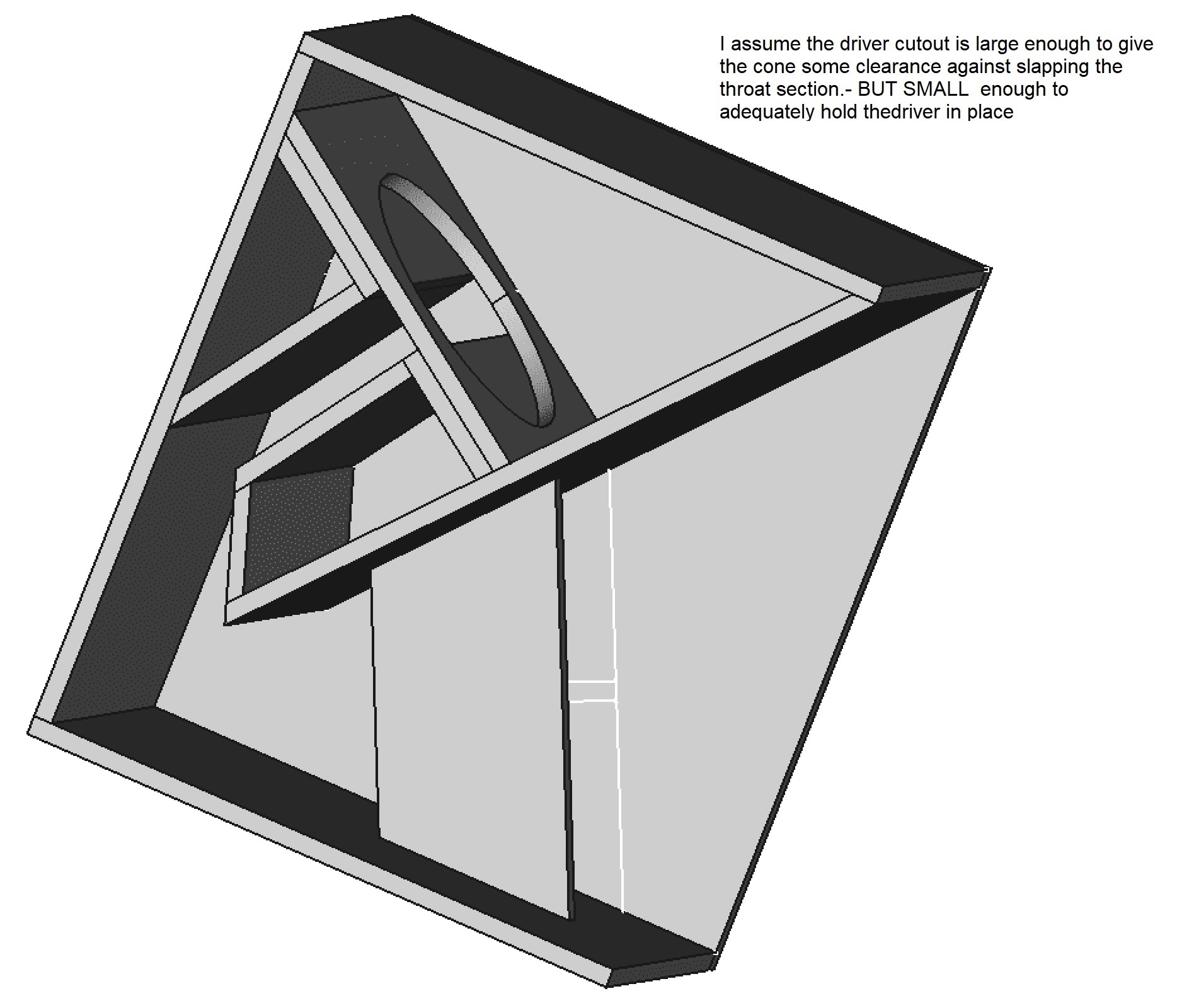

Thank you so very much ! I will look at all of the attachments and get the reader.
Your Sketch-Up picture helped me visualize how it should go together. I don't think my friend can find Baltic birch plywood in his area but there is a decent regular plywood in 3/4" "cheap".

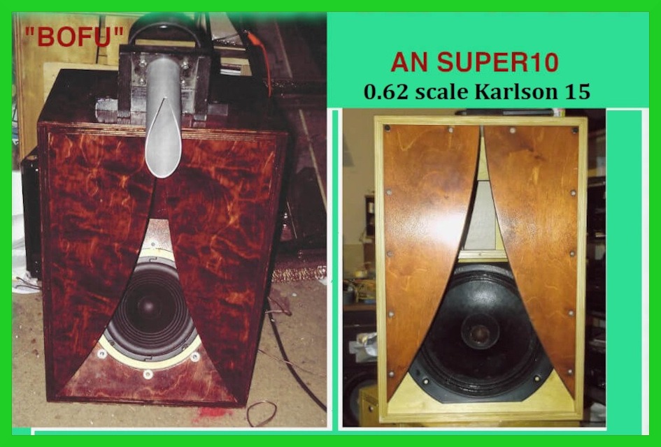

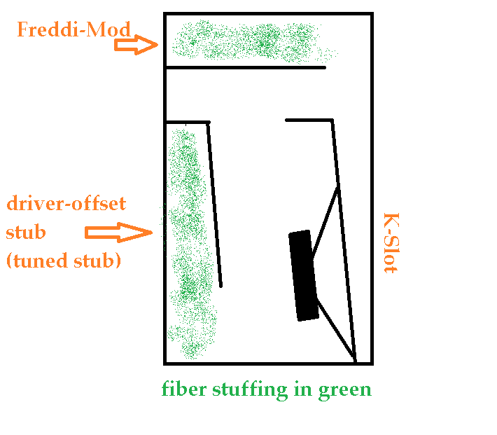

10 inch "Karlson" ?
Here's what I have so far for "K10" - maybe one with patent 3540544 "Fig.6." upper reflector and internal slotted pipe tweeter - ? I don't know now to implement one with 1/4 wave rear not whether that approach makes sense.
Back to the horn - do you think a DE250 wold survive a 1200Hz xover with "electronic musics"? IF I can find a little cheap 1.4 horn then I've brand new Beyma Neo 1.4" CDs bought really cheap (prototypes with graph.

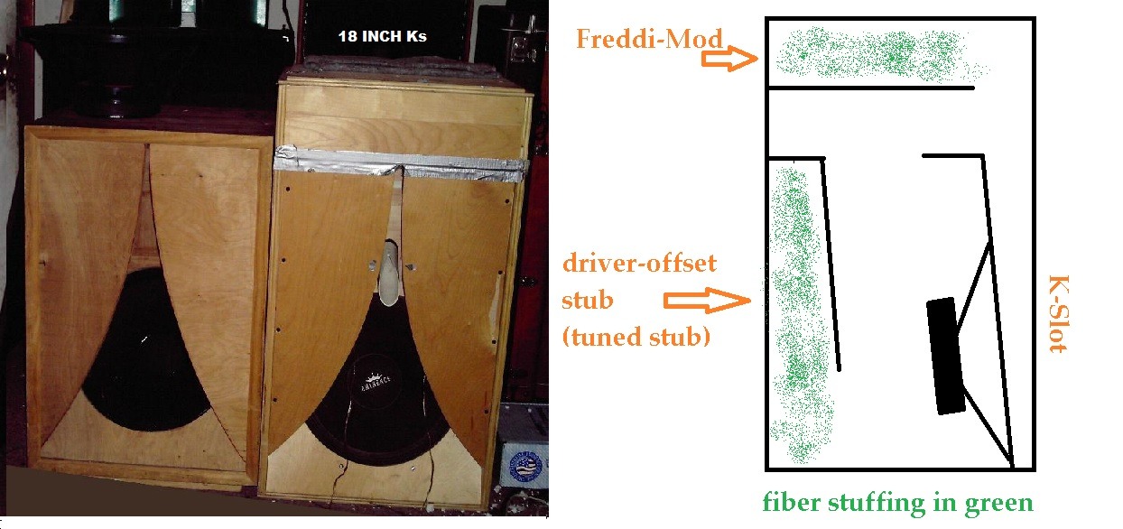

A "stub" connected to the top of the front chamber would do some smoothing, could in some instances give a bit more end, better impulse response, and soak up some reflections.
