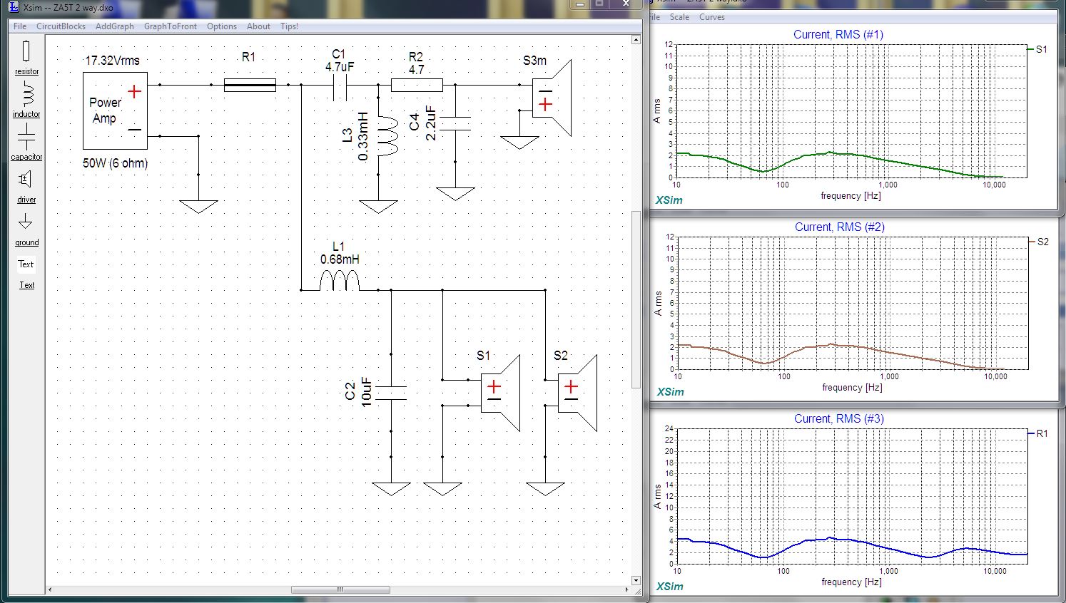

With all respect, but the crossover networks shown here are far from optimised i think. I saw a big current loss at the woofer, and the response and impendance also did not look good. So i took my take on it (starting from Douglas Blake last effort). I think this is way more optimised, and the drivers are phase aligned now in the crossover. And i have to say, these ain't easy drivers to get right in the crossover... You can temper the top frequencies by rasing the R4 value if you think that is needed

Interesting ... a 16 ohm design, not bad.
However; There as no "big current loss" in my last design ... The woofers were in parallel giving a 4 ohm impedance. That means that each woofer was carrying 1/2 of the total current... 2 amps plus 2 amps == 4 amps, as the current graphs below show you.
In your design, with the woofers in series, both woofers carry all the current but the voltage is divided between them.
Your current graph lines up nicely but it is false to claim current loss in my design.
Also, please note that a 16 ohm design, while perfectly valid, will produce a somewhat reduced output... your graph is showing 100db, mine about 106. This is because 16 ohms draws 1/4 the current of a 4 ohm design... thus producing only 1/4 the power. In this case that's not necessarily a bad thing since Denon specs 6 ohms as a minimum.

There's nothing wrong with your design. It looks okay to me and playing with it here I was unable to find any big improvements. But please keep in mind that our friend is learning from us as he goes, so the more concise information we can give him the better.
That last one is true, that's why i started my design, and give the file with it so he can play with it. At the end it's him who need to decide what is best, we can only give him options and opinions and teach him how we work and what we think of when we decide how to do a design. This is no competition at all for me... And even if i have some experience with passive crossover, i still learn a lot in this kind of discussions.
and to Kustomize123: that peak on top you can eq in a passive crossover with an inductor and a resistor parallel as like i do in my version. The inductor is the lowest point where the filter start to work, and the resistor is the attenuation of the filter. Try to fix this in xsim with your response file.
