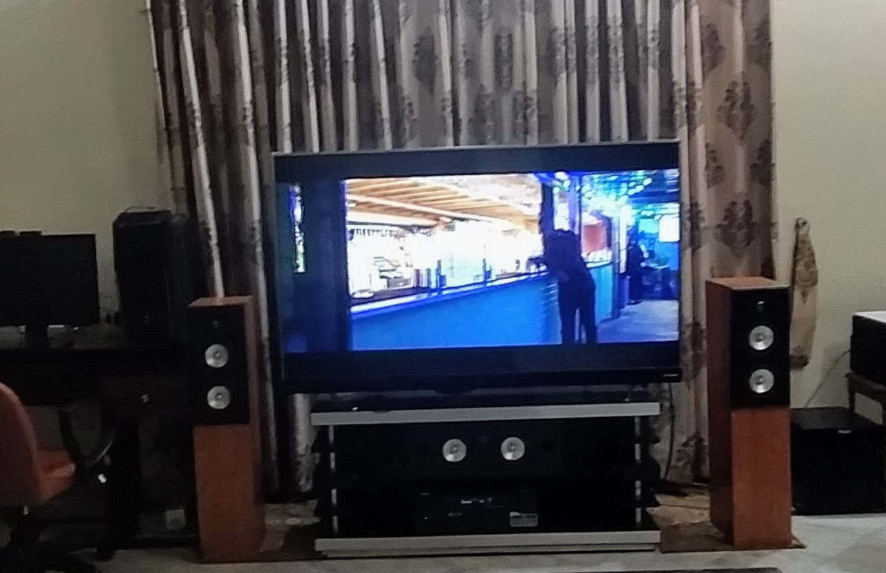

I did but it’s not working for my fronts due to space constraint.
My room has no space from either sides of my fronts. They can be pulled CLOSER together, but not farther.
That would be less ideal, no? Because they’re already only 6 feet apart, and my Listening position is at 10 ft. The max I can do is push them back towards the walls abit. I did move the subwoofer a little bit out of the corner, and into the room diagonally.
Also, I think the dips might be my room reflections, as it’s not treated at all. Bare walls, and no carpeting, marble flooring. Have some furniture and TV around snd curtains, and that’s it. Basic.
You’ve helped a ton and I thank you for that! I am not disregarding your guidelines!
Maybe if you see this, you could better understand the space I am working with. Its very much far from ideal!
