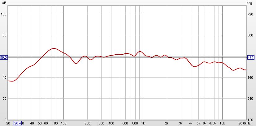

Here is what I get currently at 1M, smoothing 1/6 applied, on axis straight at tweeter. This is where my speakers are placed in the room, so yes, there is some reflection from things around them!
If you use the "Psyacoustic" smoothing the curves will be much closer to what you actually hear. But it does look like you have a hot tweeter there...

It is ... Look at your REW scan, you have too much tweeter and too much bass going on. In the voice range (200 to 2khz) your speakers look a bit weak. Now part of that could be placement, part could be room... but I can see from the plot why you would think vocals are recessive.

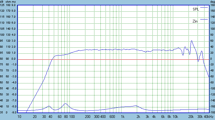

Because looking at Zaph's own Frequency graph for my speakers which i have attached, i don't think the 200-2k range is recessed, what do you think?

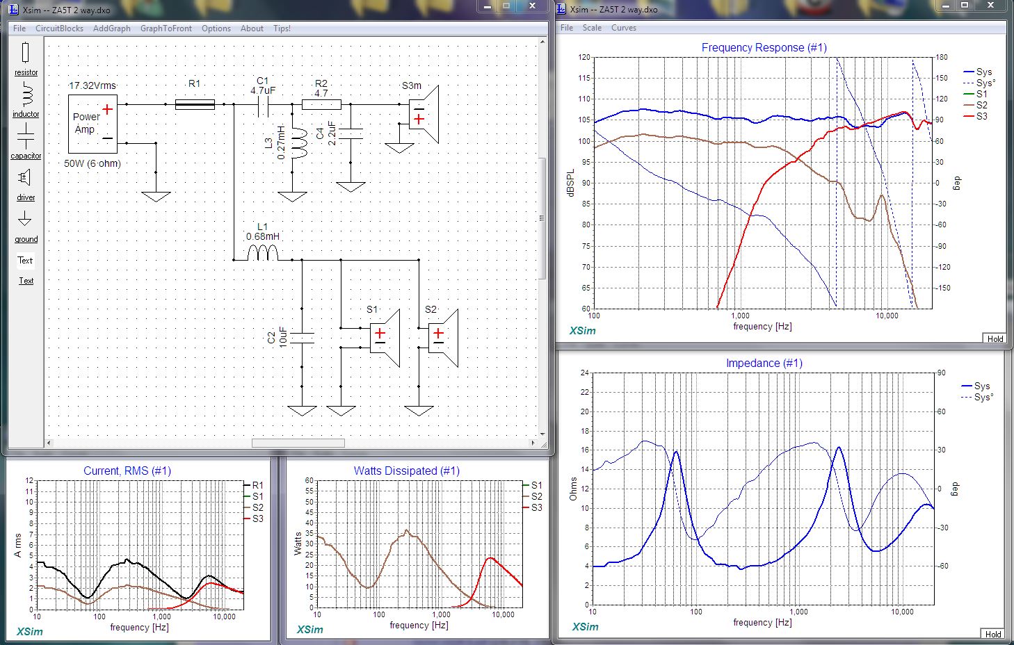

Ok, here's another way to do this. This time using all your current drivers and flat out replacing the crossovers to build a 2 way system.
I've used Alan's latest tweeter files.
Note that the frequency response is within +-3db right across the range. The box might affect it a bit but I think not enough to invalidate the design.
Frankly, given the relative expense of a few coils and caps, compared to new drivers, I'd be prone to try this design first...

That is entirely possible... but... you still have red hot tweeters in that top octave. There isn't much musical energy up there and we're not used to hearing it as a distinct sound, so that could be very irritating and it could be masking the midrange, somewhat.

Woah...I didn't move anything around, i just dropped the 16khz frequency down about 6db, and 1db drop on the 8k. And the vocals weren't congested anymore! I think you are right about the tweeter running way too hot covering the midrange possibly! Plus the fact my music type might be way too different for my speaker's design as I mostly listen to rock/hiphop/house electronic music.
But it did make a big difference!
