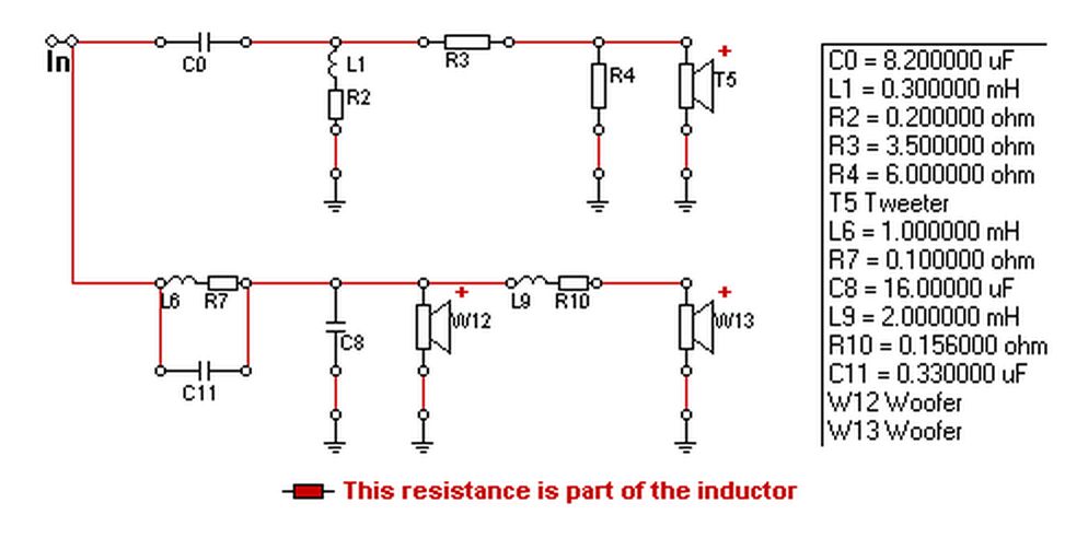

Working the crossover for better impedance
We simply want some plots and a plan for a useable impedance and response.

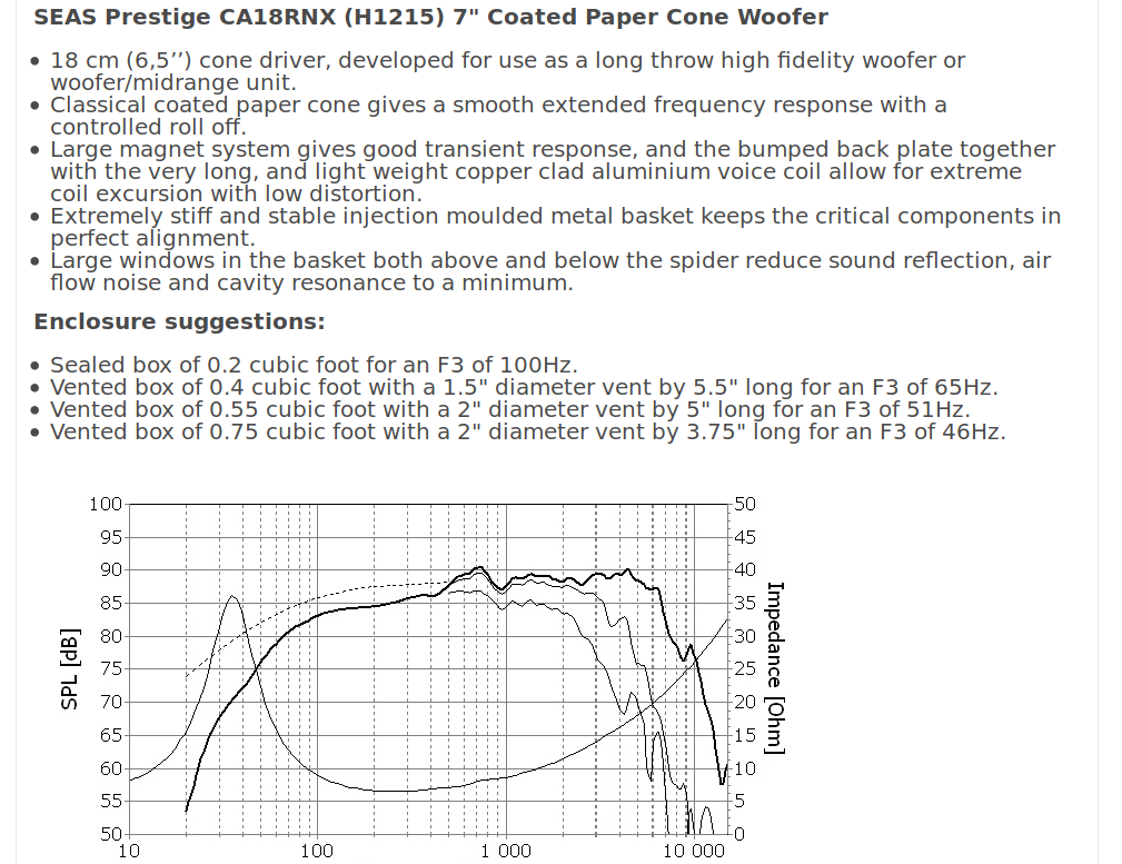

I messed up with the Zaph file, but I have attached the FR response and impedance from Zaph's own website under the ZA5 Driver Data.
Sorry Kustomize, that doesn't look like the plot of a 7" driver?

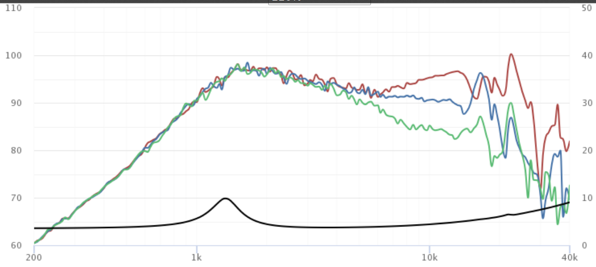

How does that one look? - and this tweeter? Vifa DQ25SC16-04, 1" Titanium Dome Tweeter
Do you need one or both?

The driver we are looking for the FRD and ZMA files of is the Zaph ZA5.
http://zaphaudio.com/ZA14W08/ZA14W08-datasheet.pdf
The image I posted is from this link above.

EDIT 2 : I cross checked the Vifa DQ25 Tweeter files from the thread I linked earlier with the SEAS driver, it seems like the FRD file might be a little off than the actual response that I see on madisound for the tweeter.

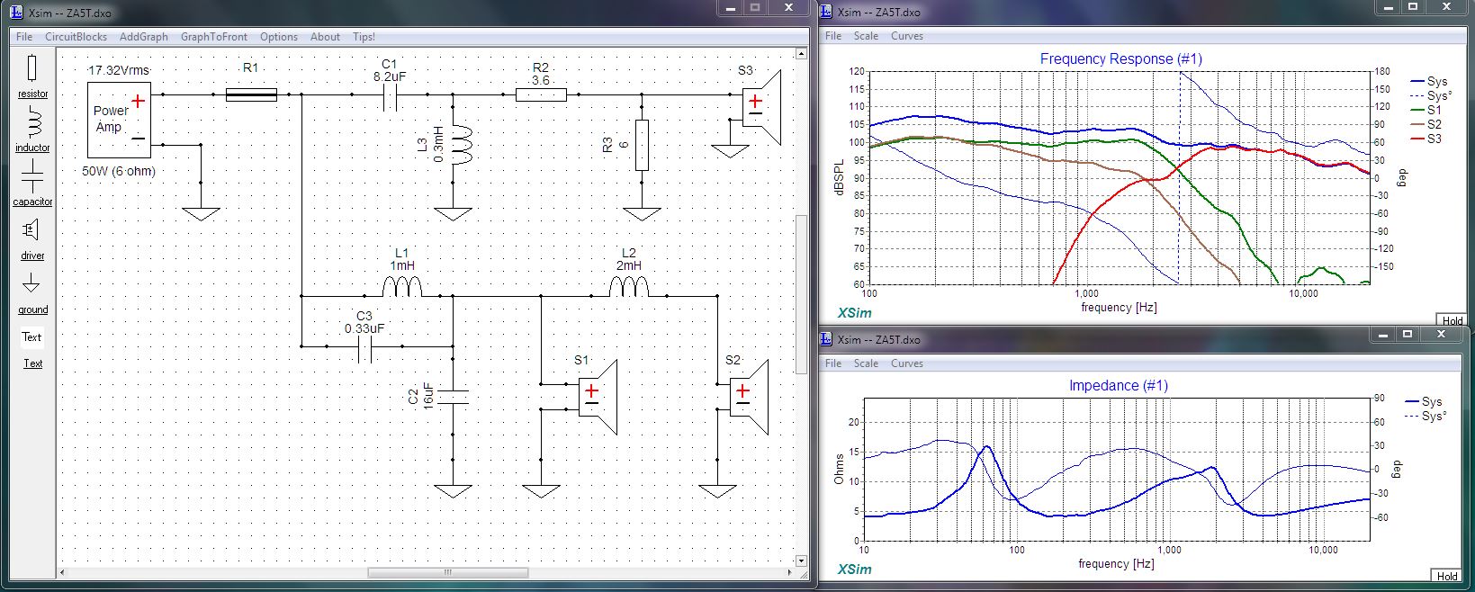

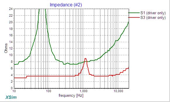

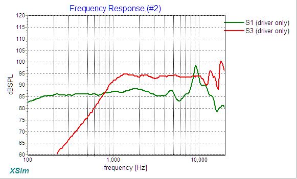

Here are the frequency and impedance plots for the drivers, per the newest files...
S1 (Green) is for the woofer.
S3 (Red) is for the tweeter.
If these look reasonable we can push on...

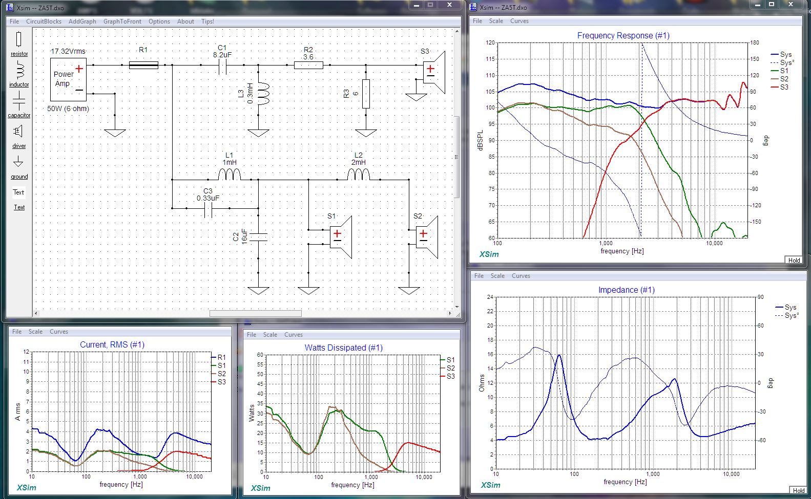

But I've just noticed something a bit horrid here:
attachment.php
Tank notch 0.33uF C11 makes a dead short at high frequency!
Should have some resistance in series with it, IMO. Maybe 10 ohms.
Okay, first up ... that DQ25 tweeter is seriously gnarly. The unevenness in the high end (at the top of normal hearing) could make it sound abrasive, even tiring to listen to.
So, I'm thinking that you might want to swap them out...
The thumbnail and DXO shows the difference with just a tweeter swap, putting in the Dayton ND28f-6 which is a soft dome tweeter. This would be a bit rolled off in the high end but we can adjust for that. It would sound mellow, warm, with little or no rattle your nerves sibilance at the the high end.
At this point, I'm looking mainly at the tweeter type ... soft vs hard dome. You may wish to pick a different model of tweeter and as long as it can keep up with the woofers, we can try it too.

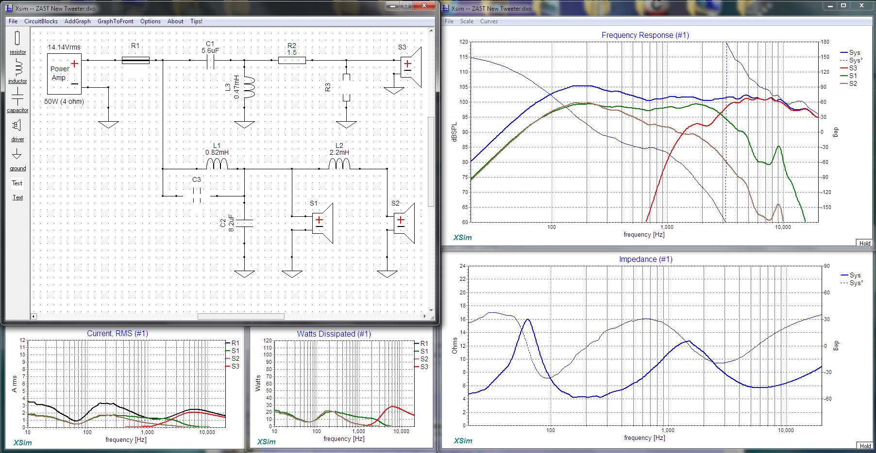

Here is the same replacement tweeter with some tweaks to the crossover.
R3 and C3 can be removed. Parts replacements can be made per the schematic.
This design also eliminates the current runaway at high frequency (Your amplifiers will thank you).
The highest octave (10k to 20k) is still a bit rolled off, so this design will not be at all harsh sounding. The mids will be a bit forward. Baffle step for the bass is maintained. Should be pretty nice sounding. Just keep them away from corners or walls.
