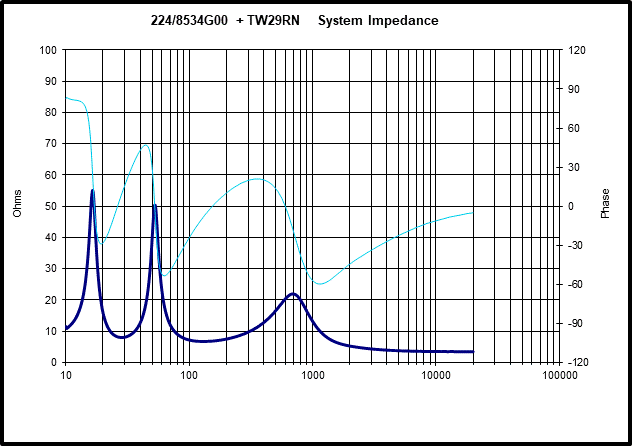

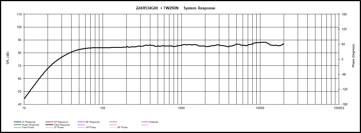

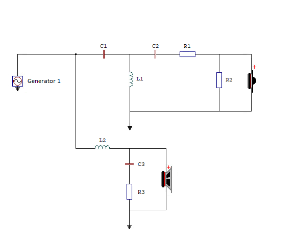

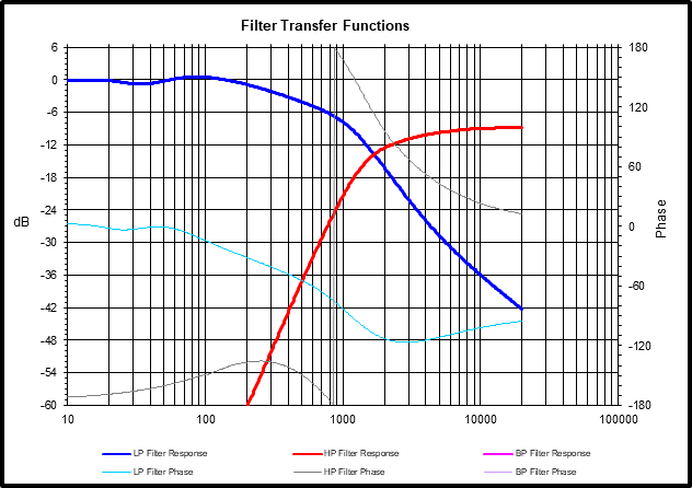

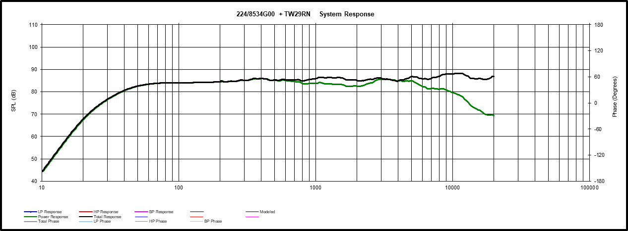

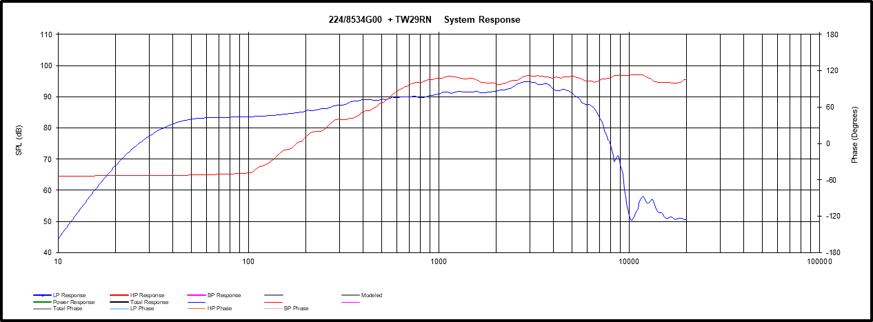

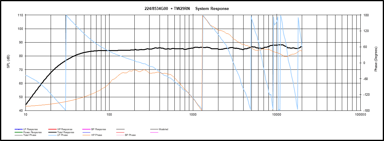

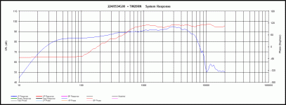

Purely for what it's worth, having had a few minutes spare after walking the hound, I dug through my archive of measurements, and thought I'd see what I could quickly simulate.
Like all such simulated 'designs', a la Steve's above (or anybody else's for that matter) it's not a 'design' as such at all: the baseline measurements are mine, but reprocessed to add projected box load (60 litre, Fb 30Hz) baffle-step and diffraction effects (28in x 11.5in baffle, 3/4in roundover, 13in between driver vertical centres, 1.2in z-axis offset). The drivers are the Scan Speak 22W/8534G00 and the SB Satori TW29RN-B, HBT minimum phase extracted. So (and I want to stress this point) this is very rough & ready, and I don't pretend it is anything beyond that: it is certainly not a finalised design, just an approximate exercise. I used the ring-radiator as a nod to Steve, since I know he's a fan.
01 shows the raw driver response. 02 is the summed FR with filters in place, 03 the same with phase. 04 summed with reversed tweeter polarity, for whatever that's worth (not a lot); 05 summed FR with predicted power-response; 06 the electrical transfer functions, 07 the system impedance & electrical phase.
Nominal crossover point is 1.4KHz, [asymmetric] LR4. The acoustic transfer functions are strictly speaking roughly 2nd order Butterworth on the low-pass & 4th order Bessel on the high pass, but the general characteristics are roughly akin to LR4 behaviour. It's a relatively low filter but the Satori can handle it OK. HD2 is a bit high, but there's no audible strain -I've crossed that thing at 1.1KHz to a quad of 6 1/2in midbass units without it protesting. Damped 2nd order electrical on the midbass, 3rd order electrical with a nominal fixed L-pad on the HF to get the phase into line. There's enough in the resistive shunt to damp the Fs impedance without needing a full LCR, although that would still be a 'safe' addition. A slightly rising response on-axis, due to the Satori being a little larger than some, so off-axis it drops a bit in the HF, as is roughly indicated in the power-response. Impedance minimum is about 3.5ohms, roughly flat-lining above ~8KHz, so not a particularly tricky load for a half-decent amplifier. Electrical phase gets to about 60 degrees around 1.2KHz, which is a bit steeper than I'd normally like, but impedance is about 10ohms at that point, so it shouldn't be troublesome.
All purely conjectural / approximate, nothing more, but an interesting exercise for an 8in 2-way. Bit different to a Harbeth, where the crossover is usually at least a KHz higher, but the general principle can work fine so long as you pick your drivers carefully.

Unfortunately, this is not a design remotely useful to anyone:

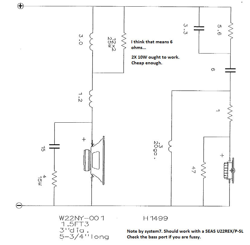

Now I can do something with this DXT design:
995030d1636055524-woofer-suggestion-harbeth-2-a-madisound-w22-dxt-filter-png
I have already hatched a potentially better scheme. Or plan on which to proceed. Because a certain amount of ducks have to be got into a row, based on exact woofer choice.
No Values! Why the secretiveness? 😕
Simple. I clearly stated:
And:
Since all such 'designs' are as I stated more or less just exercises, not fully conceived, properly measured and developed loudspeakers, I didn't post the component values or full box design details since I'm not in the business of providing purely simulated offerings as recommendations. You'll recall that in practice the driver responses are likely to differ a little from this. Baffle-step loss and diffraction effects were simply simulated and spliced in (which is only ever approximate. Near, but still approximate), and their relative positions & the baffle dimensions were not carefully optimised since this was a very quick look, no more. No off-axis measurements were used either, and on-axis alone is not good enough in my book these days for a high quality loudspeaker, although I did make a small nod in this direction by adjusting the nominal summed balance to roughly what I know works well with this tweeter given its off-axis. Now, I can certainly post the values if you wish -but there isn't much point in doing so from my perspective, because they will require changing. As I made it clear from the outset this is not a 'real' design, and I have zero interest in randomly tweaking what was a pure 30 minute investigative exercise. I know some do -and power to them. That's not how I design things though.
My congratulations. Since I'm not in a competition (obviously others can speak for themselves 😉 ) the object of this exercise from my perspective was purely interest, and illustrating one of the many approaches. Which I do not claim to be definitive, 'better' or 'worse' than anything else, above all since it's not even a properly worked up design, just a quick check. That being said, 'potentially better' will rather depend on perspective and priorities.

As in mine? As noted, it's just a rough investigation to show one general direction rather than a proper design, so in practice it will require changing based on proper measurements & refining the baffle dimensions / driver position (which I didn't as I was only taking a quick look). However, the electrical topology is a damped 2nd order low pass, and a 3rd order high pass on the tweeter with a fixed L-pad. The acoustic slopes are 2nd order Butterworth (more or less) on the bass unit, and 4th order Bessel (ditto) on the HF, giving roughly an LR4 characteristic in terms of its general behaviour.
