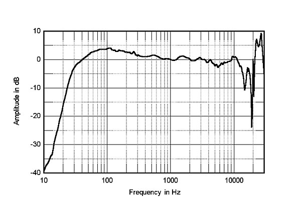

Haberth in its 30.2 serie model uses the acoustical phase alignement with the recessed woofer and on some model the recessed mid (40.2 3ways serie) ?
As Stereophile is saying the 30.2 is not time or coincident design either what is showing the step response, your at the opposite is phase coincident ? It's the same move phase philosophy with reversing the polarity of one side of the crossover ; 180° shift !

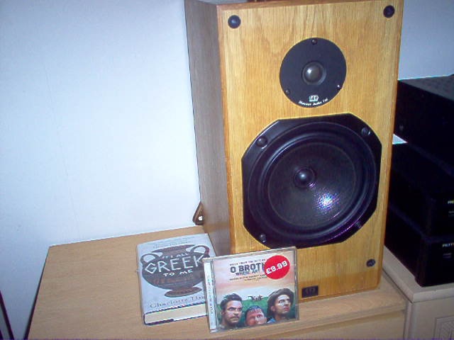

Here's the dubious SEAS Njord speaker with a regular sort of 1" SEAS tweeter:
517567d1449134051-orangutan-lookalike-seas-njord-jpg
Comes with a crossover a Child of Ten can build:
517568d1449134051-orangutan-lookalike-seas-njord-filter-png

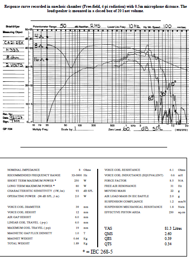

Here's the woofer:
517569d1449134051-orangutan-lookalike-seas-ca21rex-png
Now experience tells me you are going to hear a lot of woofer breakup and tweeter distortion there.

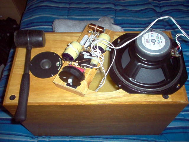

Now look at the original circuit in my modified Monitor Audio R300-MD, it might be vaguely LR2 on tweeter, but nearer third or 4th order order acoustically:
601596d1488133996-monitor-rs6-mods-beginner-monitor_audio_crosover_typical-jpg
714062d1541548033-restoring-monitor-audio-r300-bookshelf-speakers-monitor-audio-r300-md-original-schematic-png
I modelled both of them, and they are horrible on phase and breakup, which occurs around 3.5kHz on 8" woofers. Have got a much cleaner sound from 3rd and 4th order filters. A BBC and Harbeth idea. If you want to do 8" and 1", the third order is easy enough to build and works with most stuff. It's not strictly BW3, but near enough. Where phase goes sideways, it fills the dispersion hole. You can try what you like though. It's your project.

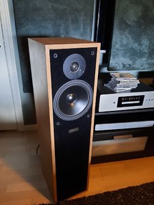

After trying out some of Steve's "recepies" with Vifa M21, I have found that his BW3 style crossover using 8inch woofer and inverted polarity on tweeter is "my kind of sound".
I bought these old norwegian Patos 401 which use Vifa P21-10-08 and Morel MDT32S tweeters. With a very simple modified 3khz BW3 crossover and inverted polarity on tweeter they sound very, very good.

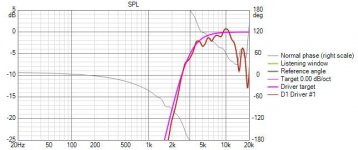

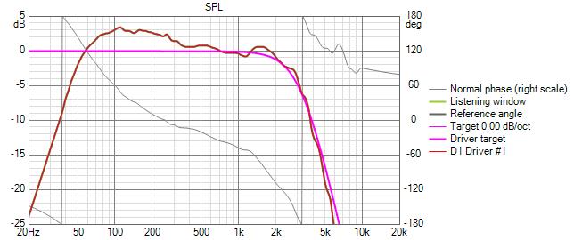

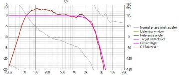

Could not resist to do a bit of curve tracing and overlaying the graphs Scottmoose posted on post 52. If you would like that, I gladly do the hi-pass as well..
This is as 4th order LR acoustic as it gets, no matter what the electric topology or electric transfer function of the filter is....
