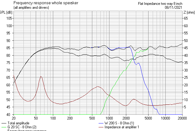

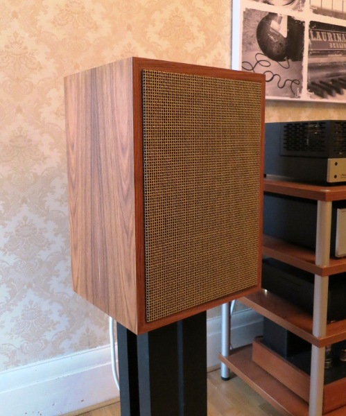

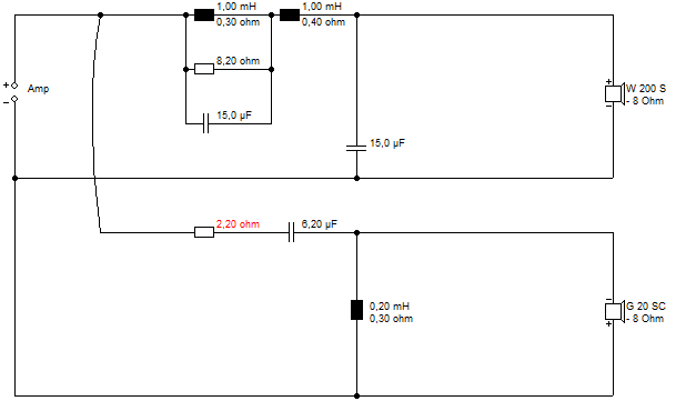

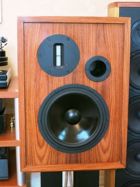

The SPH-220HQ is quite a nice driver. I used it in a couple of designs a few years back, including the 2-way standmount attached. The ribbon was a mistake -crossing to an 8in at about 2.8KHz was asking too much of it. Were I to revisit (no chance now, sadly) I'd go with a quality dome as the partnering HF driver. No regrets over the 220HQ though -excellent unit of its type for the money. And Colin's cabinet work went some way to making up for a slightly overwrought tweeter. 😉
They do look nice. I had similar problems trying to mate a midbass driver to a ribbon tweeter, so I feel your pain 🙂

It certainly confirmed that I'm not a huge fan of ribbons. 😉 I like what they do well, but on the whole I prefer a quality dome. A useful learning experience on the whole. They didn't sound bad at all (pretty good in the scheme of things) but we were never completely happy.
