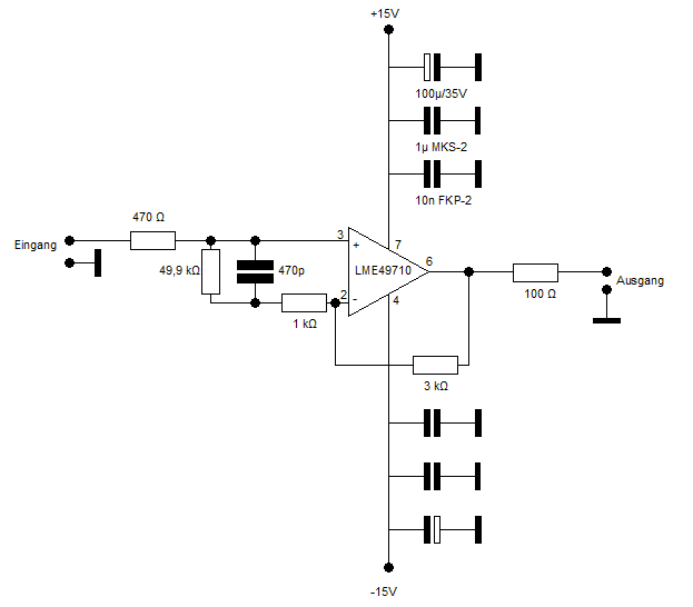

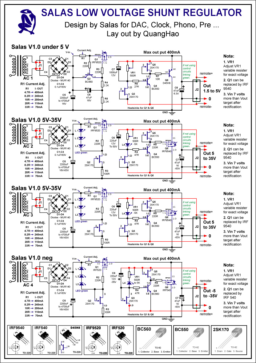

Has anybody done some tweaks regarding opams' power supply? Seems that combination of 7812 & 7912 could be significantly improved by Salas shunt regulator (scheme attached) ...
I'm working on simple headphone preamp (based on LME49720HA) for the dac (att.) and I guess Salas shunt reg would perfectly serve there. So perhaps that could be implemented for output opams as well.
some other improvements?!
I was thinking myself to use Jung super regulators from Sjostrom but don't have enough time to do it. I am not sure if there would be any significant improvement though. I would first try in improve the clock itself and maybe reclock the data, then I would deal with analog output. But the DAC is damn good in its original configuration for sure. Just use brand name components, no chinese fakes.
