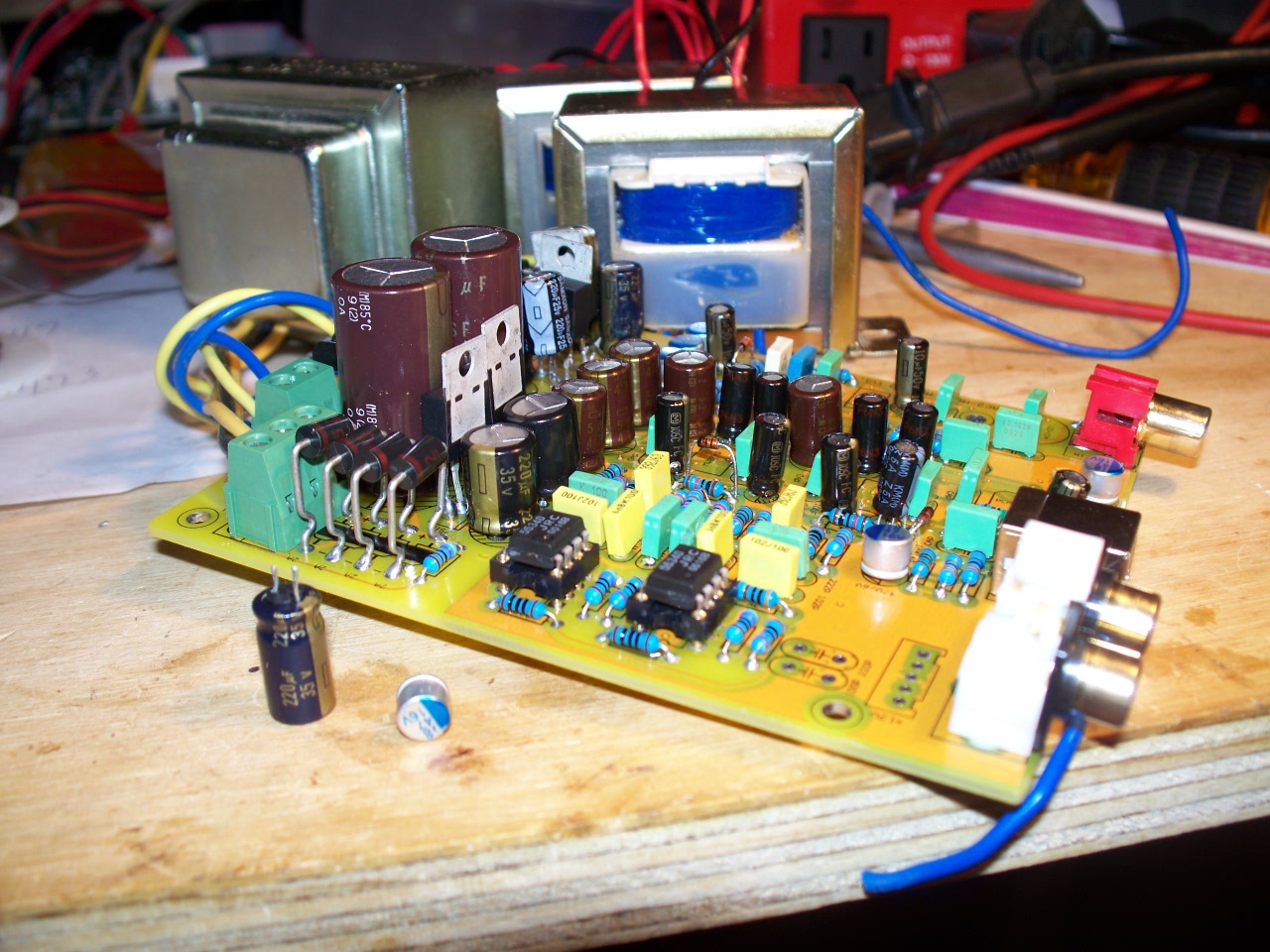

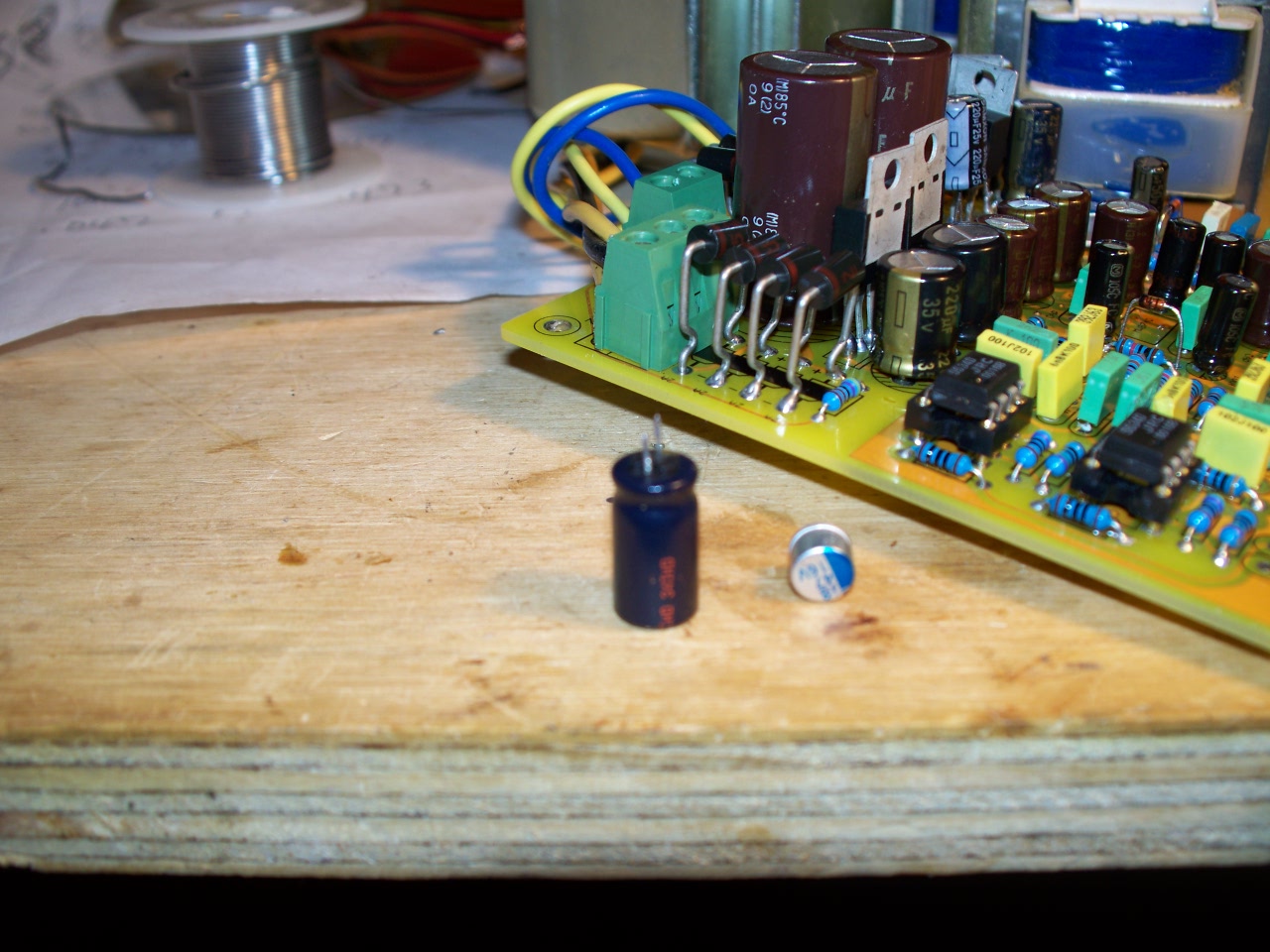

almost finished mine at last 🙂 the only things left are EMI filter and chrome steel front plate...
-all psu caps replaced with FCs
-47uf Elna silmics
-10uf Elna tonerex
-opams to metal ones - LME49710HA
I will post few pics later. Used the dac with a few movies (1080p mkv and DVD-9 with DTS) and was very impressed and delighted with the sound in comparison with external Creative Sound blaster live. I would say the the difference is like you are listening to some mp3 of 128kbps and authentic CD on expensive and decent equipment!

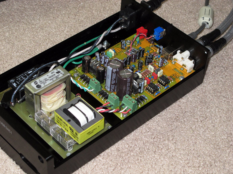

I use mine almost everyday, the sound is simply superb. I want to do a blind listening test some day, to put my Theta DAC against this Wolfson and see the listener's response. This is not so amateurish design as it might seem on the first look. There are 13 stabilizers! Yes 13. I got lucky and grabbed 100% finished aluminum box that fits the PCB. So I thing this DAC is somewhere in production these days.so how does it sound !?

No, I didn't ground it. It's not needed, at least in my case. It's dead quiet. I just grounded main AC to the enclosure.

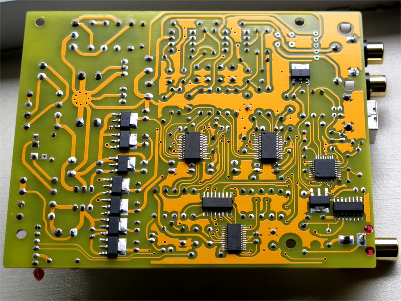

Gee I had a problem on start up dir 9001 went to heaven in smoke ,my second lm7808 is getting hot ,I checked everything and have to think might have some bad parts or I fried them when I soldered them in,I have ordered a dir 9001 and checking v regs all the way out to the chip,
If you want one assembled and tested check along on ebay,This kit has some short comings,Some parts are not labeled as the board and you say O is this a 6.8n or a 68 n cap????like the board say 683 or 682?
The elna 's I have don't say cerafines on the side????? oscon caps maybe but computer grade smt ,not the blue ones pictured,the picture is not the parts I have in my kit ,most look generic,as I said it burned on start up so I hope it's worth the time to fix it to listen to It,ANYONE would make some voltage measurement for the 7808 that runs the 3,3 regs that would be appreciated!!!!!! It's just not right to label and then supply other parts,I have built a bunch of kits but no more from him. check prices I found several cheaper.....
I found my problem and I fess up to a solder short between 2 tiny pins on the dac ,couldn't see it but the meter did,I reflowed it and the current went to normal again,So when a Dir 9001 gets here I'll make some sound I hope.
683 cap is 68n, and 682 cap is 6n8 (6.8nF) value. Those lm7808 stabilizers run hot and it's normal. They could be between 60-70 deg.C. This is normal temperature.
