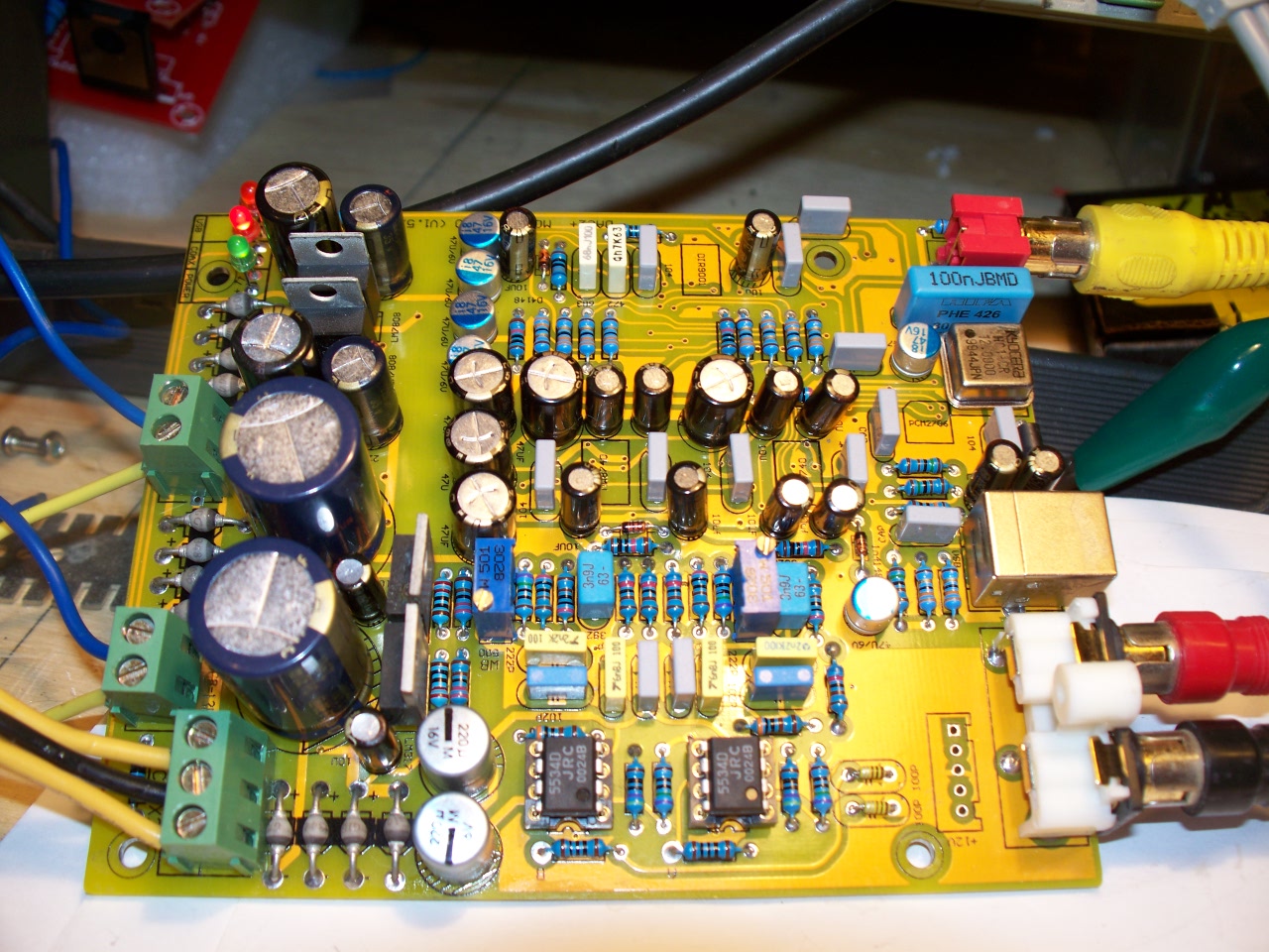

Do you have 2 pots on your board? they are near the opamps,I have not traced them down yet,I wonder if they set the output offset?I will scope it and see after I get the kit board to working,I have 2 of them one was a kit and the other came ready to play,it has the pots on it ,same parts but not layed out the same,has better caps ,but I just read the labels,I did test several different caps on my sencore,all polycarbonates,all read the value the same but esr was just tenths of a ohm different,I want to build a opamp with removeable caps and play and see if different ones do matter.....Have you tried different caps for different sound?

You can grab a micro torch in Home Depot or Lowe's. They also sell a butane filler. Do you mean trimpots? No, I don't have any pots on the board. I didn't try any different caps. I purchased all caps new mostly Nichicon with low ESR, high temp and long life. I think an emphasis on CAPs selection is widely exaggerated and I am really sceptical about any sound improvement, unless, of course, you put really low grade el. caps like those that came with my board. (probably fakes from China). I don't think many people would find any difference in blind listening tests. IMO.

I got a torch and it is way better that I was,I have got afew traces lifted when I did it with out a torch ,I have removed and replaced 4 chips with no problems,I am enclosing a board I got with the pots on it ,I emailed him and he said it was for 0 adjust on pins 1 and 6,a new improvment!

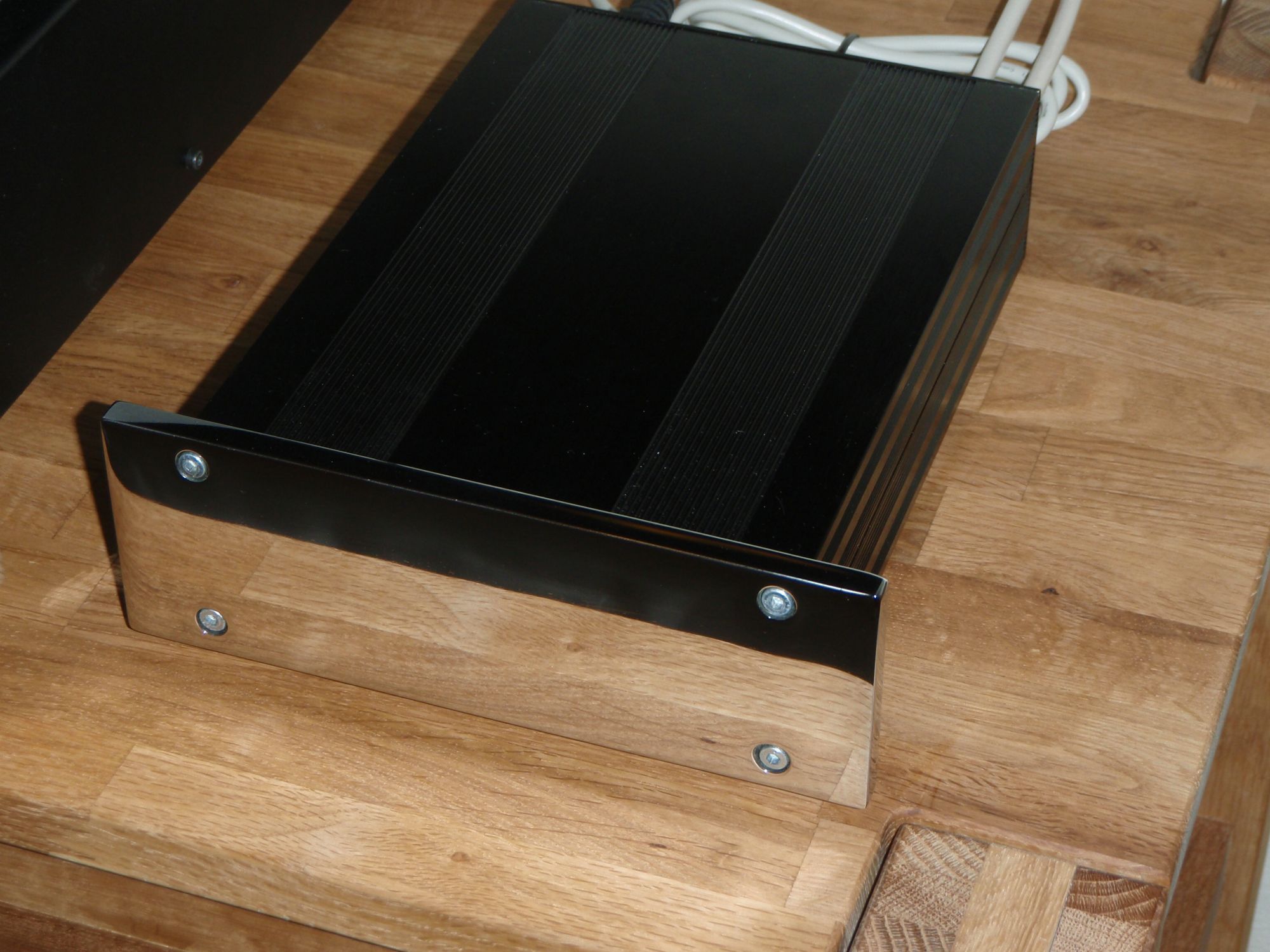

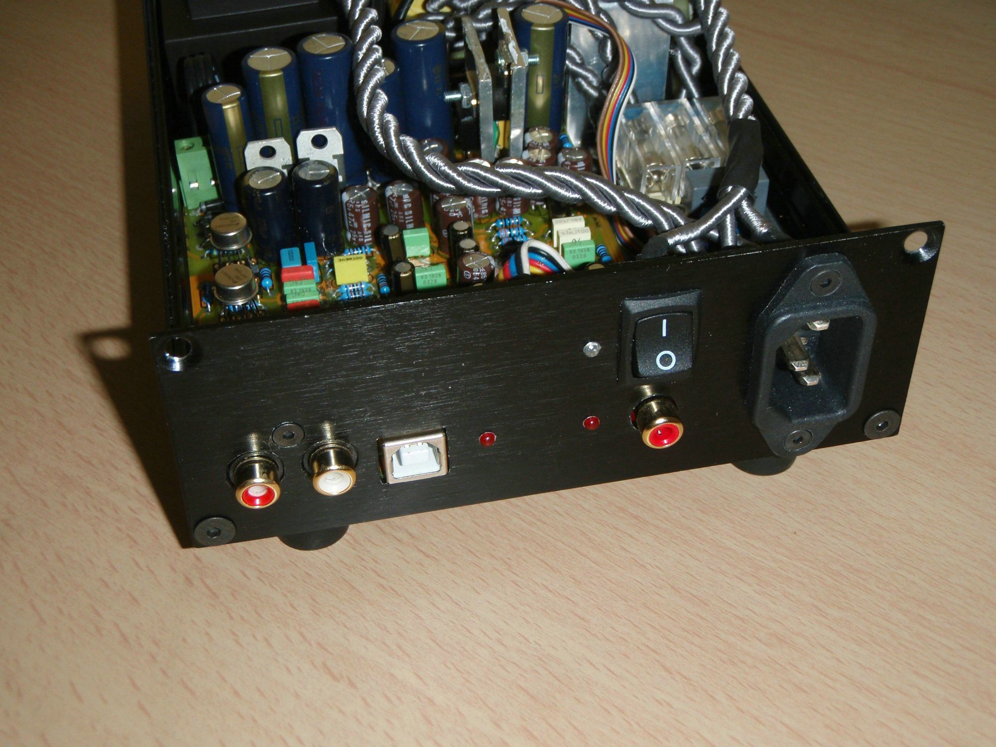

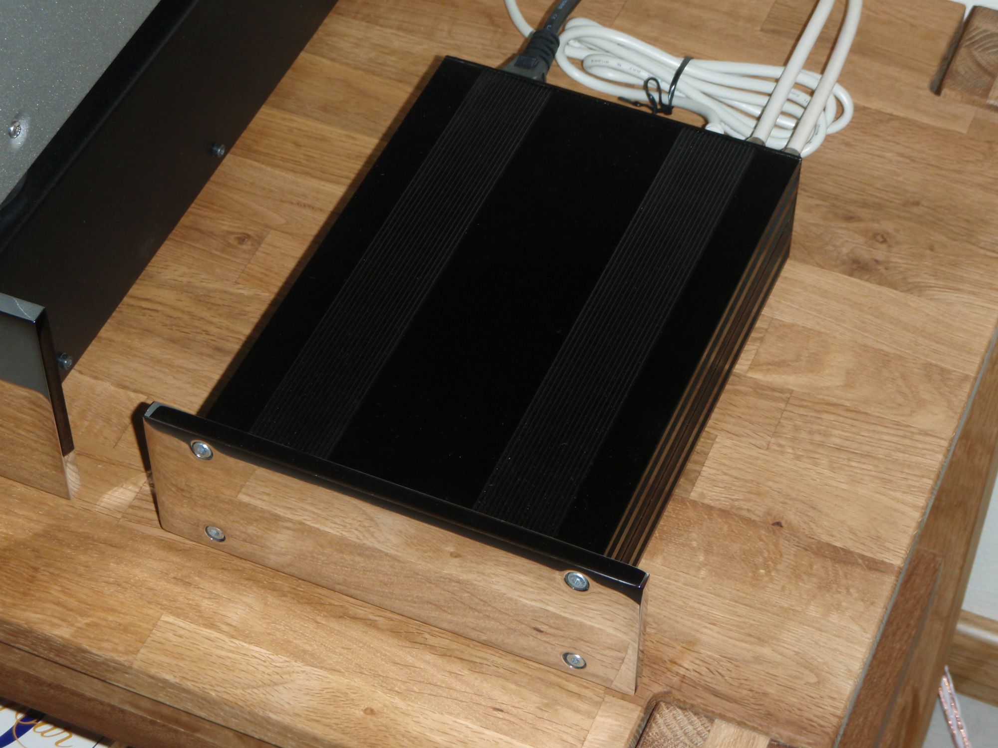

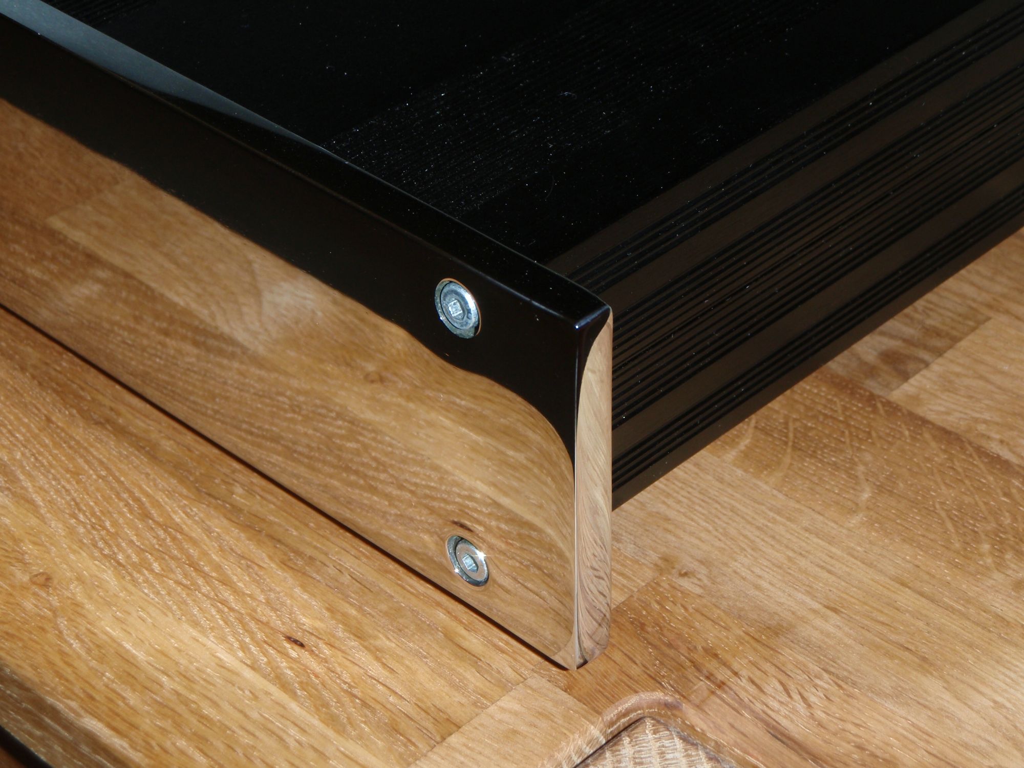

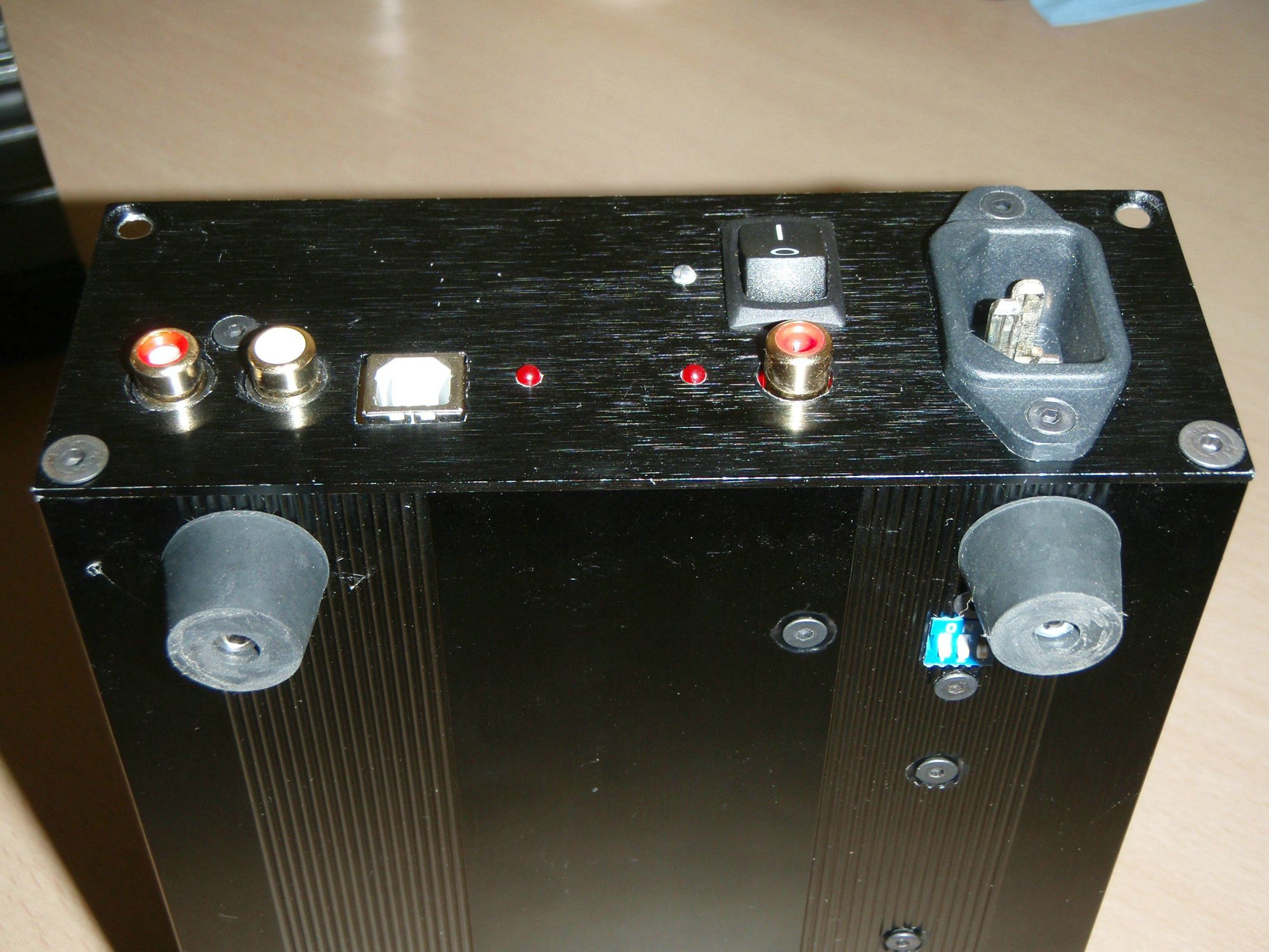

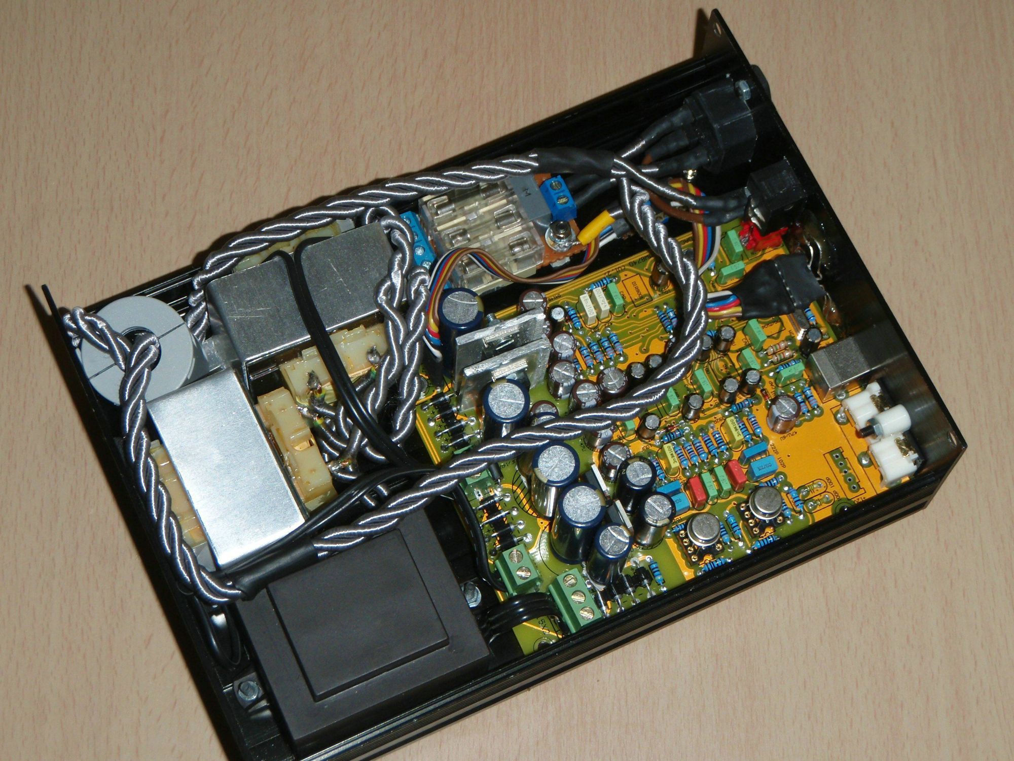

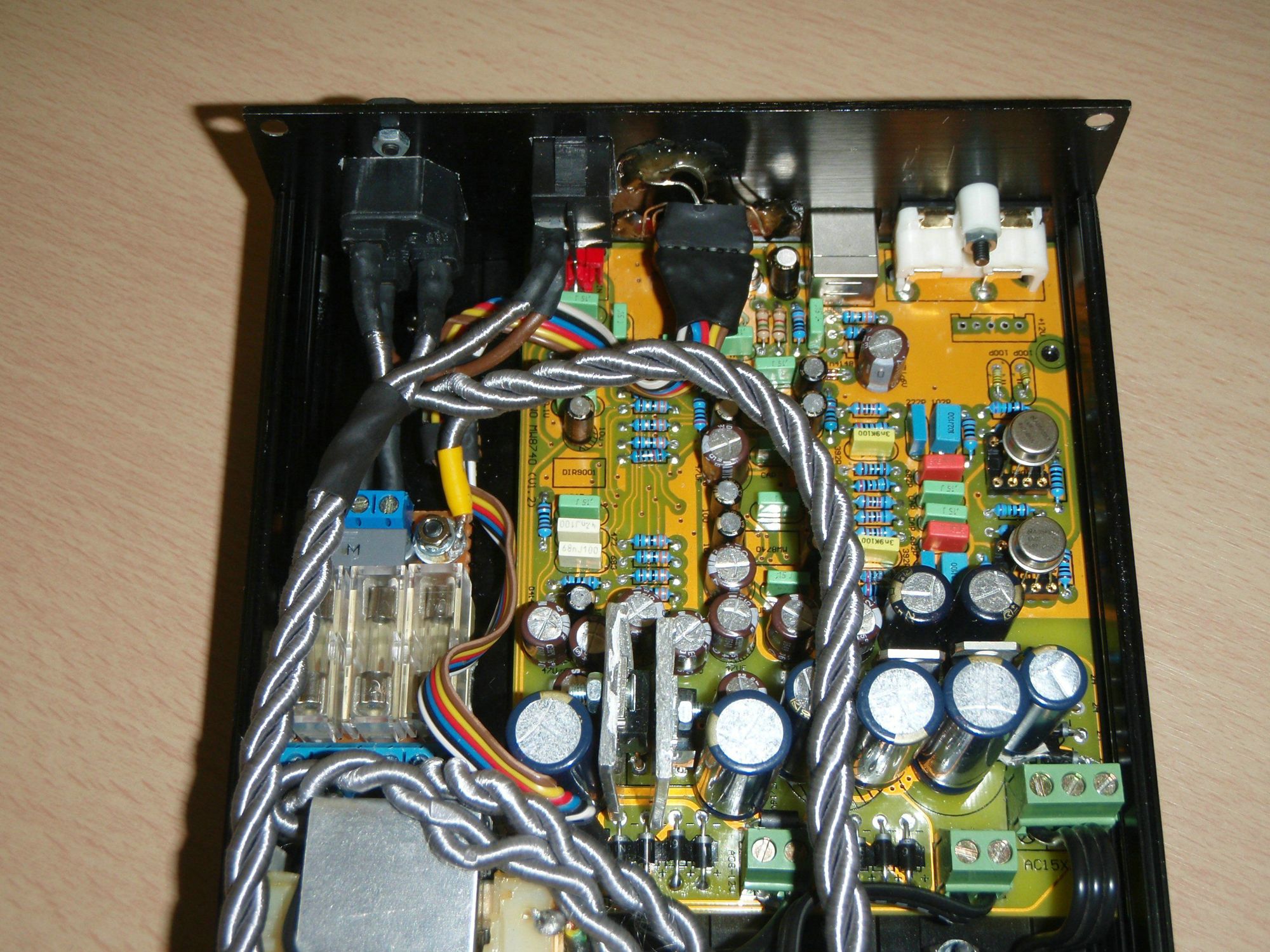

here are few pics of mine 🙂
finished inside but still have some work on the case.
Also considering to add optical input (need it to connect LG LED). Found several options:
-just add this inside the case
-use separate device
-or build my own and connect it to Coax input. It looks very easy 🙂

that's a nice rig you got going tell me what is the silver wire I can tell they run ac but what kind are they!

Looks nice, I just don't understand why you running silver power wires loop all around the enclosure and back. I think you would do better if you go straight to fuses.
well, frankly speaking that seems to me the only way to put ferrite filter inside the box 🙂 Anyway, I think half of a meter of this silver mains doesn't influence on anything.
