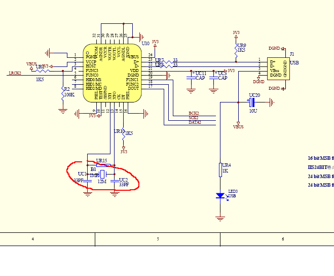

you mean swapping quartz to dedicated clock? (pls see att.)
according to the scheme that would affect only usb input.
btw, I didn't change all stock resistors and film caps, hope that it's not so grave as elkos and regulators.
DIR9001 receiver has actually built in clock. Never mind. That cheapo crystal you circled is probably OK for USB input in this application. I use my DAC with SPDIF connection primarily, feeding it straight from Xonar sound card instead of using USB as I did before. I think it sounds better that way. I am just lacking 192kHz sampling, that DAC can not handle.
