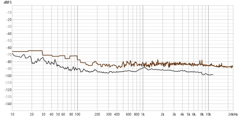

What they MIGHT claim, is that the distortion is below the noise floor and hence not directly audible. It still influences sound characteristic.Hmmmm they claim zero distortion. Is that even possible using magnetic drive force? I wonder about the accuracy of their distortion measurement (significant numbers)
Like this plot of a Quad ESL-63. All distortion below the noise floor, but never zero distortion. Top line noise floor, bottom line distortion THD 2nd to 9th order.
But still, is there any planar that reaches these numbers? Maybe.

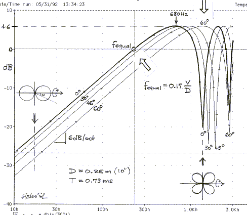

This will depend on the physical size of the emitter, for example, in a wheat field, a 1/1 meter dipole will produce a confident sound of no lower than 343 Hz, because this is the length of the sound wave at this frequency.It is totally misinterpretation of acoustic short circuit. The "short circuit" is only partial cancellation. The 6 dB/oct gentle roll-off is well treatable (for example, by electronic compensation). My revelation-like, palpable bass reproduction experience was by huge orthodynamic bass panels, in free space (without significant compensation by high-Q resonance, because the resonance frequency was around 10 Hz), and the hearing was quasi nearfield. If I've went further, the bass still remain articulated and very deep, but a little bit drier. So, that's the effect of the acoustic short circuit, not the " in a wheat field, will not produce low-frequency sounds". Smaller panels and baffles rolled off at higher frequency, but not "will not produce low-frequency sounds".
All frequencies that are lower will fade.

It's the peaking frequency, the front and rear waves superponated in phase. The frequency of equal SPL (dipole and monopole) lower - well explained by Dr. Siegfried Linkwitz (R.I.P.).1/1 meter dipole will produce a confident sound of no lower than 343 Hz

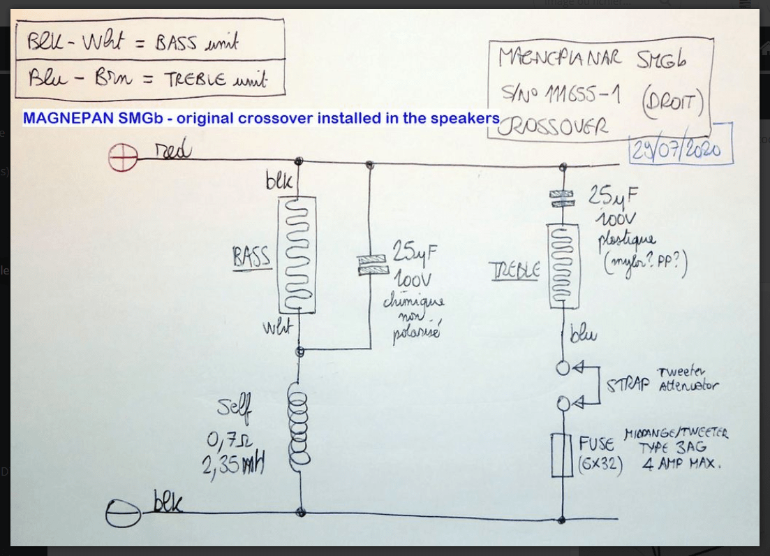

I was thinking about MAGNEPAN products also - surprisingly, nobody already mention them...
My pair of little SMGb can reach 50-60Hz - they are spec'ed at 50Hz-22kHz / 87dB/w/m. I have rebuilt the crossover that was quite poor to my ears, reglued the bass wires ends, cleaned them toroughly...
The original crossovers :
The new ones :
This restoration revealed the qualities of those little SMGb's, increasing efficiency and bandwitdh - the setup was A/B compared : no picture... I use them with a Ripole active subwoofer cut at 40Hz, in a little auditorium, in near-field listening.

The orientation of the inductors are not very good... Smaller Magnepans will have fundamental resonance at a rather high frequency (maybe 70 Hz) and drop rapidly below that.
