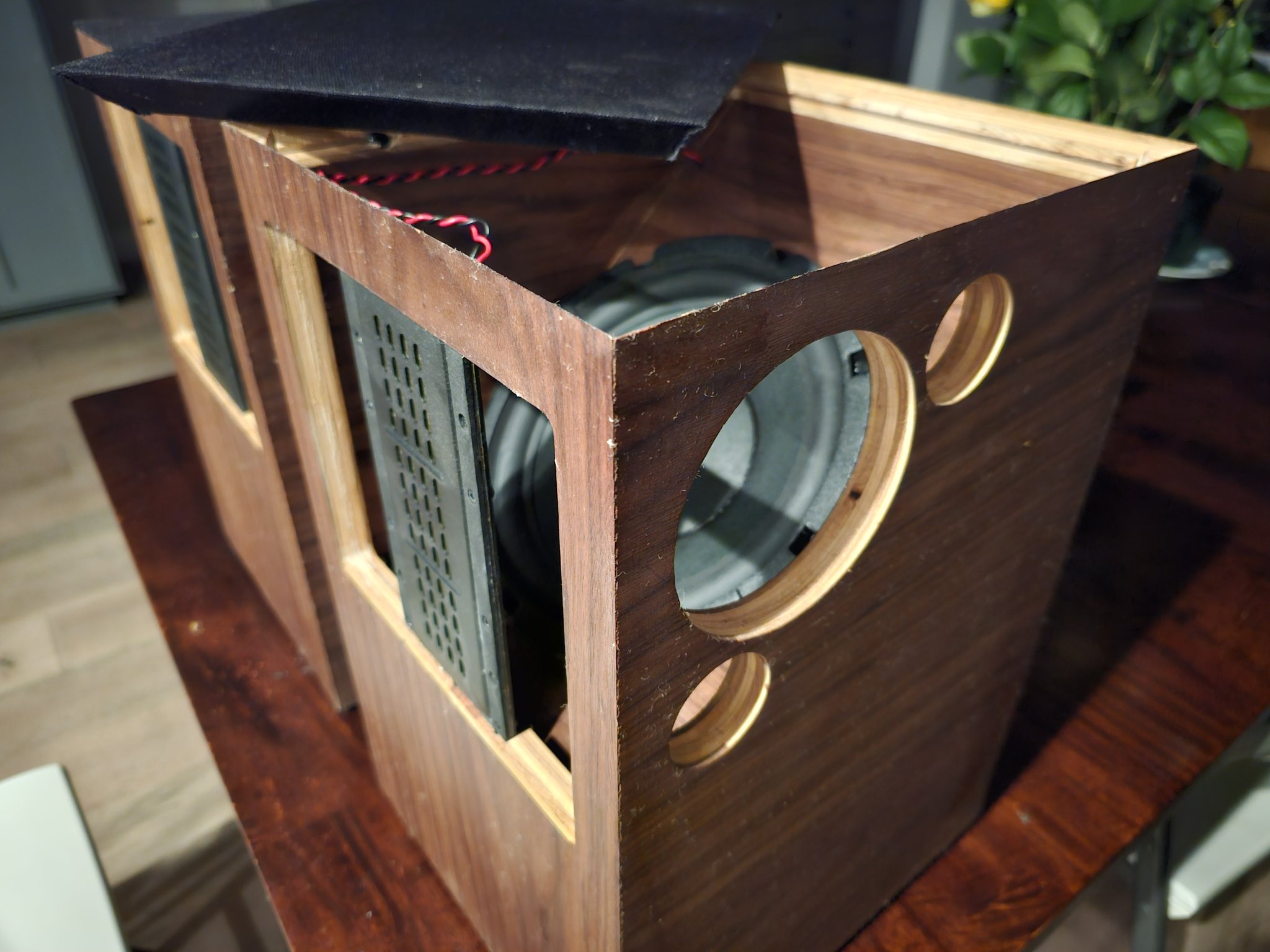

Crossed the sounderlink 8 with bold north 8 at 509hz, 2nd order. Pr behind. Padded tweeter heavily. Incredible sound.
