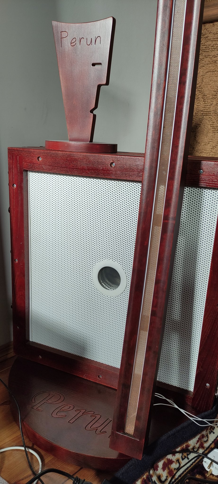

I made such speakers in 2012, their effective part height was 2000 cm, the bass panel was divided into 4 sections of different sizes to break up the resonance of the common panel.
Their most important advantage in comparison with a single membrane was the increase in sound pressure, that is, these speakers were already beginning to reproduce that same drum, but still very weakly, the drum truly became like a real one, not even with three membranes and five stators, and with six membranes and eight stators, only in this case the pressure of the membrane package began to reproduce low-frequency instruments at the proper energetic level.
In the case of a single planar membrane, the sound in the low frequencies was stroking and licking.
@havun : if you use different segments to break up resonance you are pushing resonance frequencies upwards compared to a single segment of the same total size. Those resonances will partially fill up the huge suckout improving the frequency response / balance. Not only will it play louder but also more balanced. This could explain your perception of the sound as being more punchy and powerful. As an experiment I invite you to mount some additional panels on the backside ("wings", like the audiostatic 'wings'. This is like creating a larger baffle. It gives more punch while driving force is still the same. I did this once myself but as it ruined the great looks of the speaker I removed it afterwards.
well i got rubber magnet but cant give you a source... but shipping might be expensive 🙁 i got 800 meter left) 8.5mmx3mm, i used it many times in mid and bass drivers ala Magnepan. seen on my youtube channel under the name Big guns https://www.youtube.com/@joppepeelenI’ve been watch videos and I’m ready to try and build my first planar speaker, I’m having trouble find the right rubber magnets. Does anyone have a good source?
These huge cabinets that I barely brought into the apartment I posted here on the forum. I sold them 10 years ago.@havun : if you use different segments to break up resonance you are pushing resonance frequencies upwards compared to a single segment of the same total size. Those resonances will partially fill up the huge suckout improving the frequency response / balance. Not only will it play louder but also more balanced.
Yes, they played better than exactly the same ones with single membrane.
But much better than all this play those that I have now, they have one-piece membranes 50/50cm (6 pieces) I made them taking into account all the practices and mistakes based on my own experience, of course others will have a different experience.
