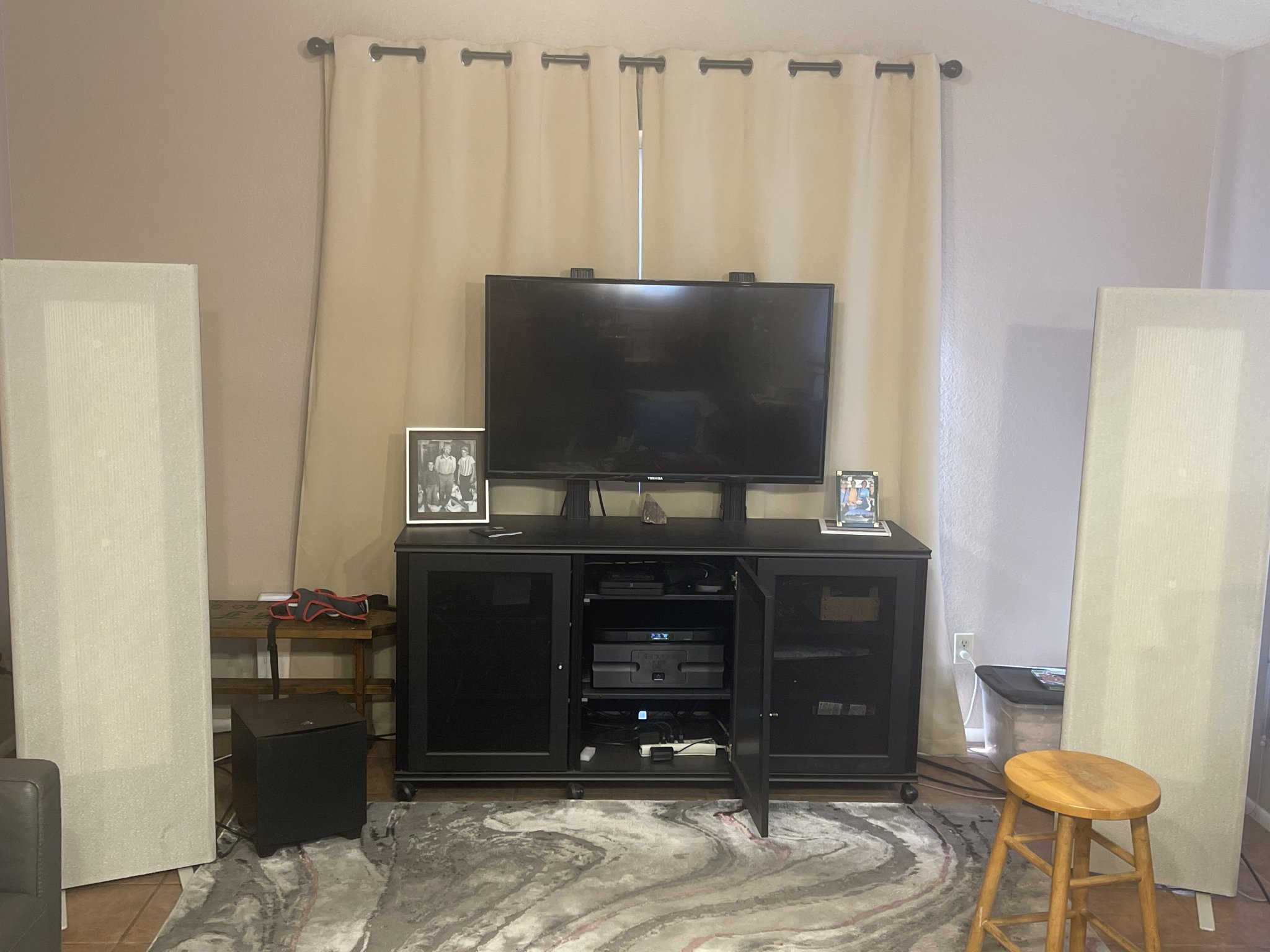

well, pretty elaborate post about building a low frequency device. I’ve got Maggie 1.7i’s I tried multiple subs first or not fast enough most of them anyway second because the recordings of the music I listen to are so varied. That one recording of the base component that’s crossed over to the sub which I do at 45 Hz never really was as fast as the Maggie’s
I ended up landing on the Martin Logan dynamo 800 X, partly because it has an app that you map your room and placement of the sub. It does a frequency sweep. On an app it then programs the sub. For your room. I use a blue sound dac that has a sub output. I can adjust it the crossover point of what it sends to the sub via the Martin Logan app I can adjust the output of the sub, overall volume. 20 to 40 Hz phase on the fly as I’m listening to the music.
So overall the Martin Logan dynamo series 600x and above that includes the app for free. I wouldn’t call him as fast as an as the Maggie but pretty close. You can have them bottom fire or by moving the feet have them front fire. I think they’re the most adjustable.
Because recordings very so much the the engineer, adjust settings I believe or the recording even at Hi-Rez very a lot. I find the Maggie can replicate very accurately pretty much any recording anomalies I find the Martin Logan after going through three or four other brands to be the fastest most adjustable on the market and a rather good price point. Of course it depends upon your other systems. Here’s mine.

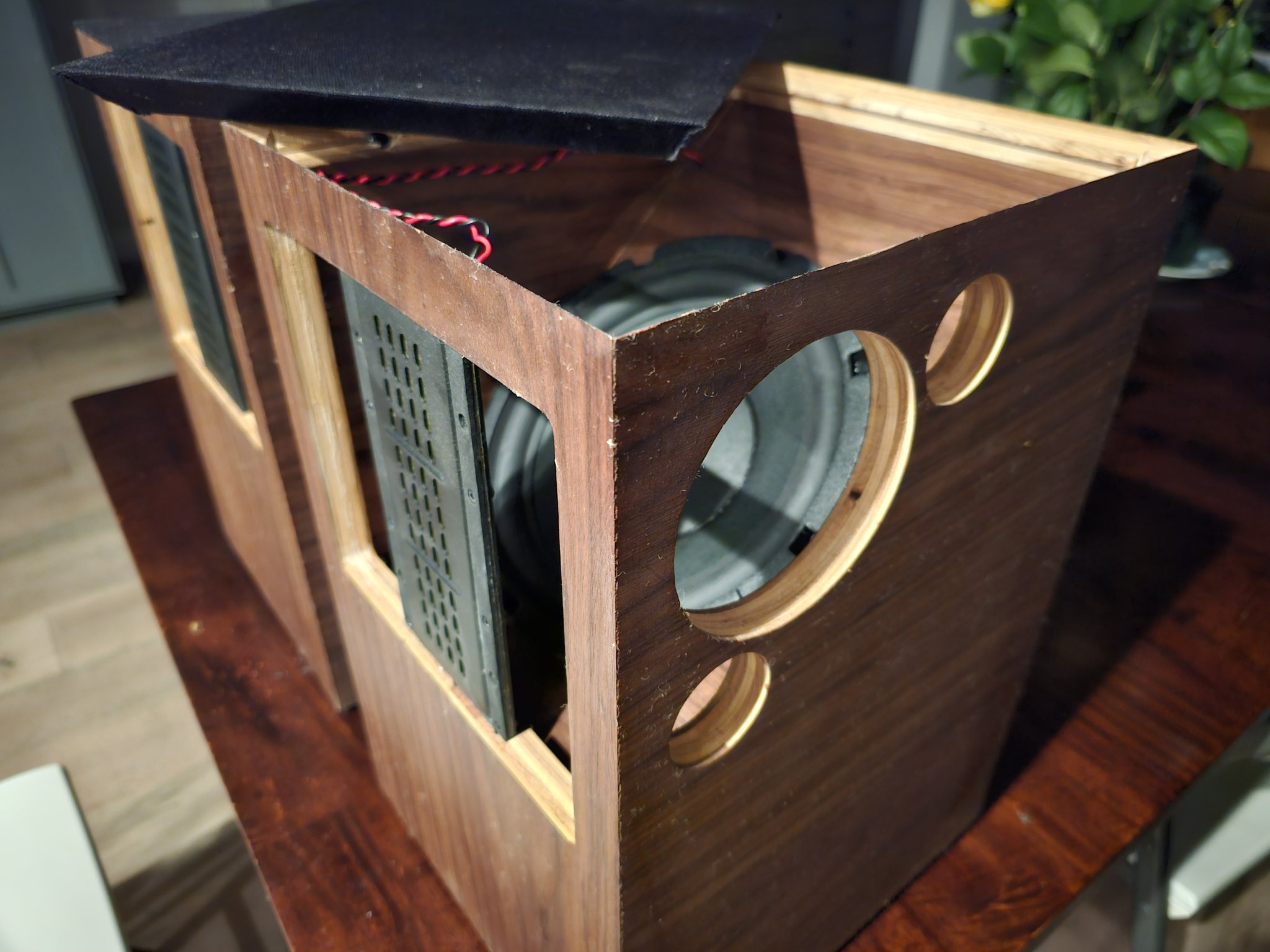

I replaced the Blue North 8 with Eminence Beta-8 @ 95db/1w which Madisound is selling now for $35.
https://www.madisoundspeakerstore.c...Qg3Pb5oSNmHyZrA9AsZR3okBysNfHbhC6477NNWVYP9ZE
Removed the padding from the mid-tweeter. WOW!
Sounderlink Neo-8 is really amazing, crossed second-order at 500hz.
