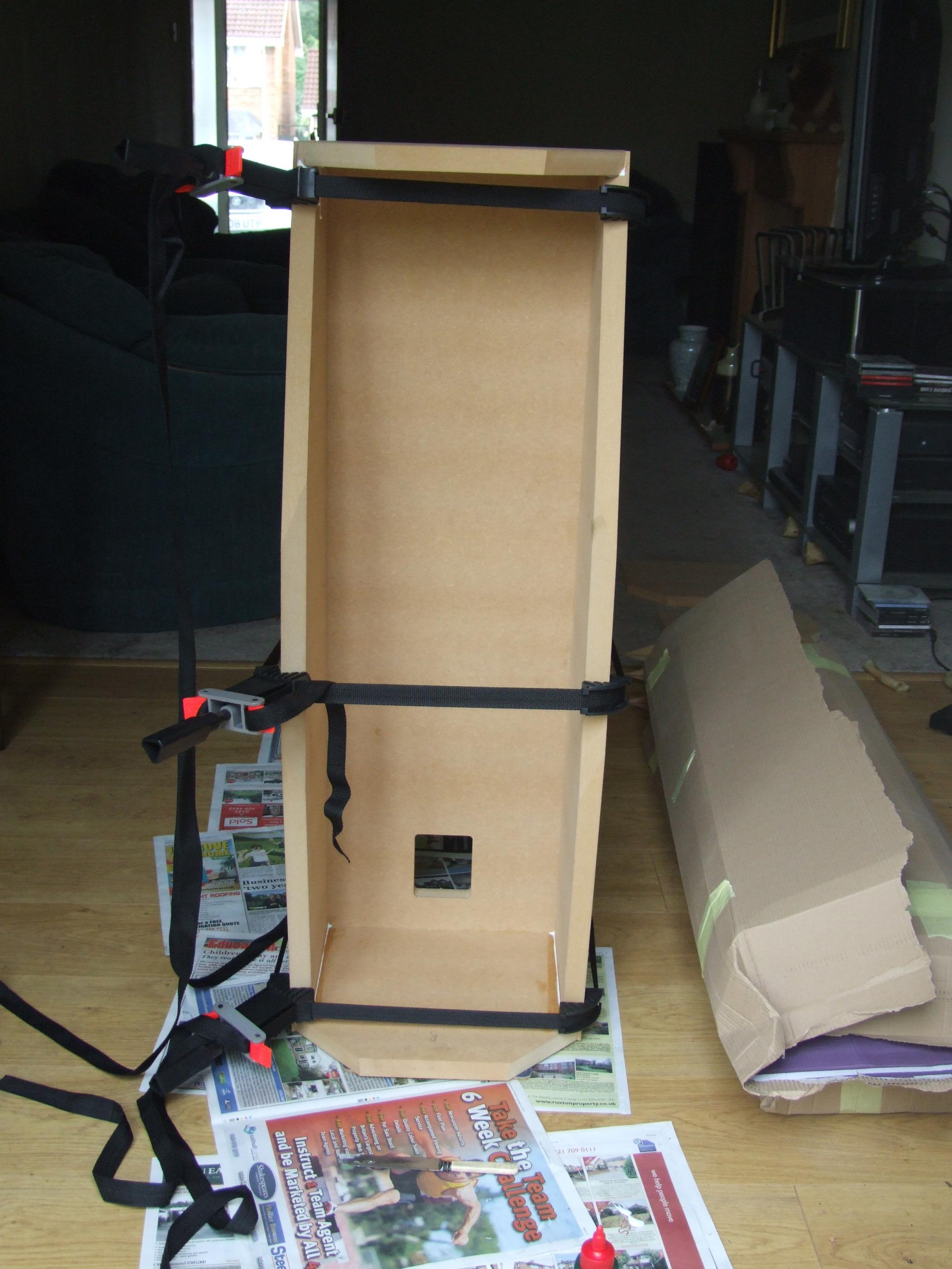

Well, the cabinets arrived today and I've made the first moves to stick one of them together. A long process but I'm sure it will be worth it in the end.
Well, I don't know how much better the veneered kits are but the plain MDF will need a little bit of work to sort out the edges and corners. Nothing major, just a bit of filling and sanding down.
I'd be appaulled if the veneered cabinets didn't fit together without filling.
Are you going to finish the cabinets (including the piano black etc) before fitting the drivers, or are you going to give them a try in unfinished cabs first?

When you do get them bear in mind that the mids are fitted from inside the cabs, if the same as the old Prestige, this means reaching in through the bass driver aperture to put the mid in place. You might do well to have someone assist you (with putting screws in quickly) because the combination of contortion and the mass of the driver makes accidents more likely. You will see what I mean when you get the mid domes - they are a lot of kilos!
I wont even be buying the drivers until the cabs are finished.
