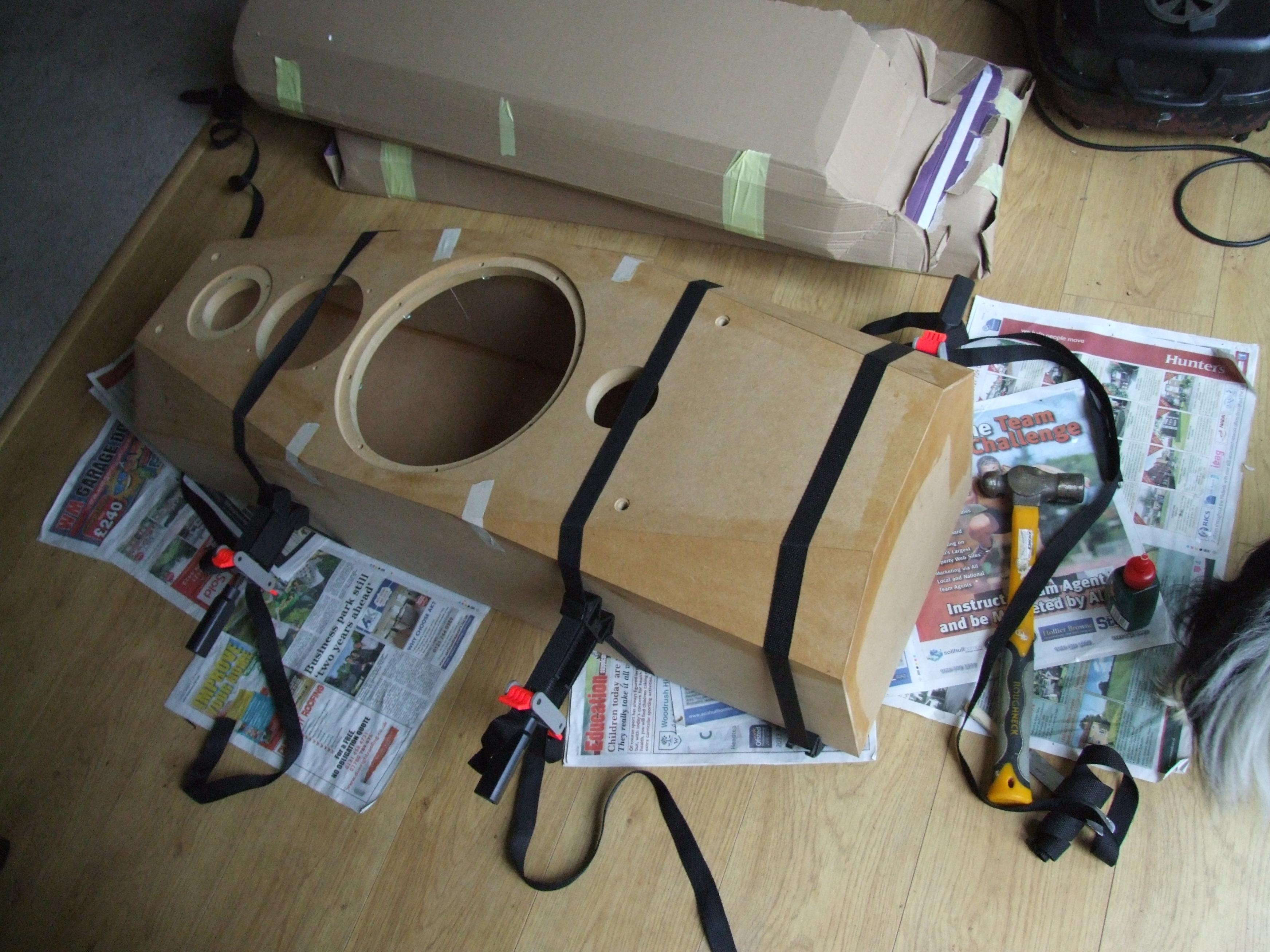

Well, the first cabinet is now assembled and I'm waiting for the glue to dry.
All the kit parts fit fairly snugly together but it is going to need a small amount of filling and quite a lot of delicate sanding to get the required finish.

Well, after my first impressions of the kit, I'm now reasonably impressed. Although the bits seemed to fit together poorly, all it needed was a bit of sanding to remove a bit of excess MDF and they actually fit together perfectly.
The top of the cab needed a bit more sculpting and a bit of filler but not as much as I originally thought.
The back will need a bit more work but, hey, you can't normally see that bit.

Is the cabinet compartmentalised between drivers or is it effectively one big box?
Can't see any sign of internal bracing/separate chambers?
How thick is that front baffle?
It's just a big box, the walls are about 20mm thick. (I'm at work at the moment, I'll measure it later)
IMHO some internal bracing and extra dampening will go along way with this speaker. This build thread shows more the sort of bracing I would expect in a speaker this size.Is the cabinet compartmentalised between drivers or is it effectively one big box?
I've just got home. The MDF is actually 25mm thick.
The cabinets will be bitumen and foam lined when finished.
